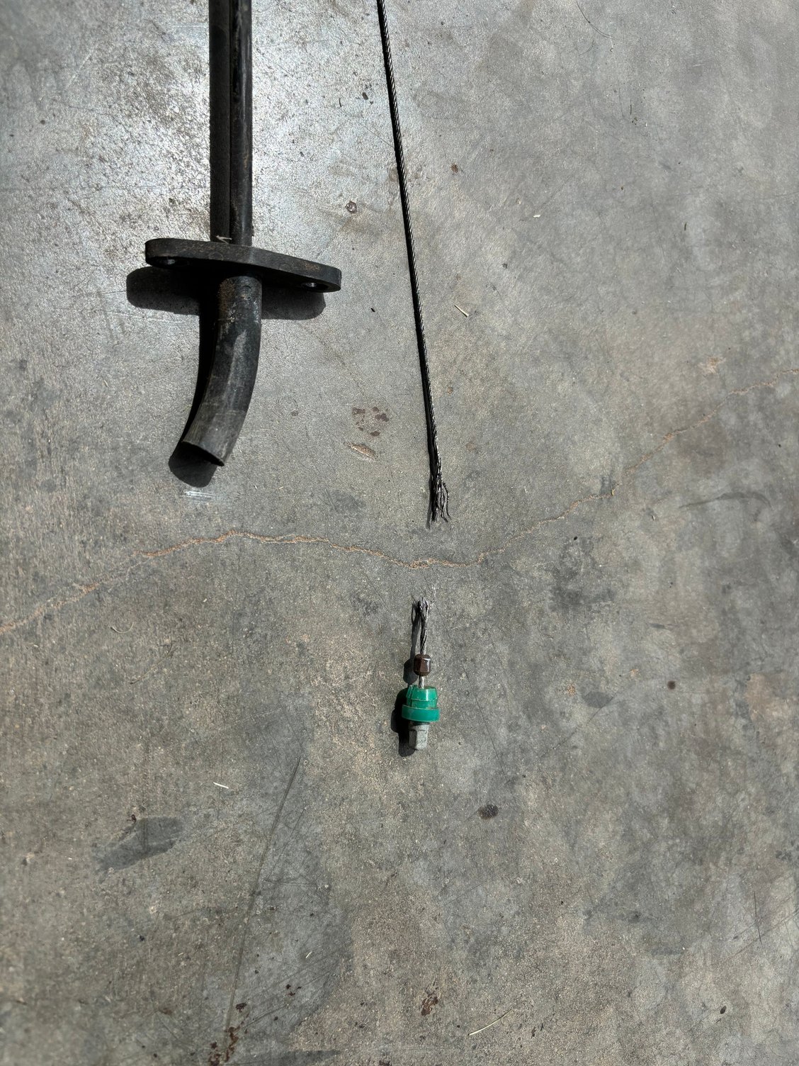

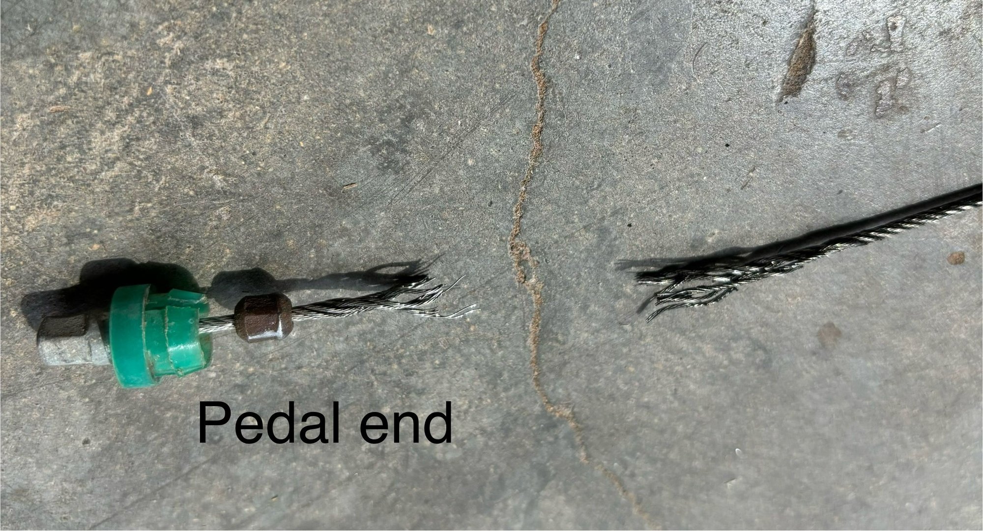

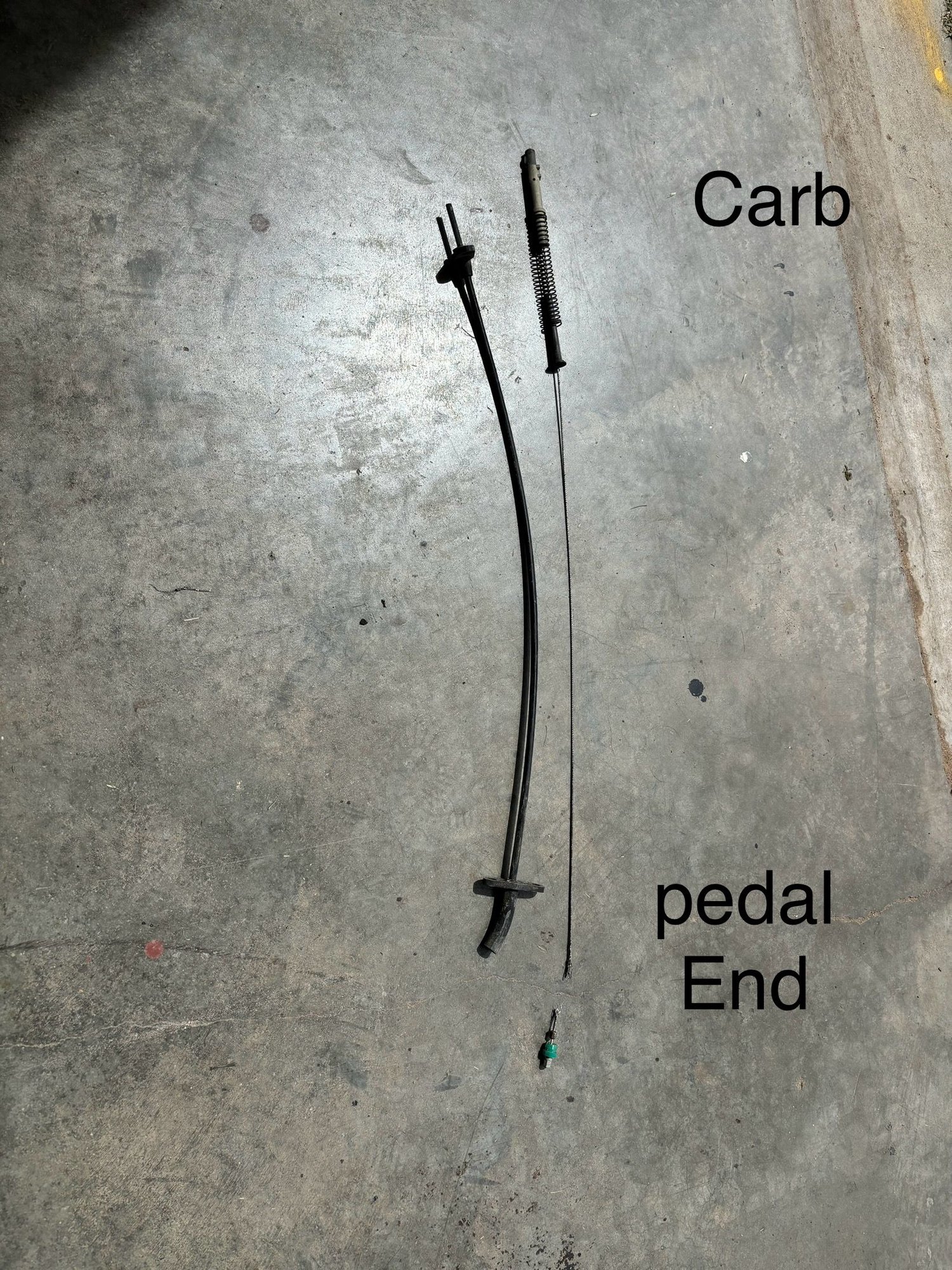

The throttle cable between the carb and gas pedal broke yesterday, leaving me to get home at an idle.
it’s a stranded cable, so I guess one strand has been breaking every eight years, but it finally got down to the last strand and broke leaving me with only an idle fortunately I wasn’t too far from the house.
for $35 rock Auto had the replacement at my door two days later and was a 30 minute job to install it.
it might be time well spent feeling along the exposed portion of cable at the gas pedal so you don’t get stranded down the road
The inner cable has been removed from the outer sheath
The cable parted close to the gas pedal

It's not even rusty. Wonder what caused it to break. I guess just small bends back and forth over time eventually got to it.
