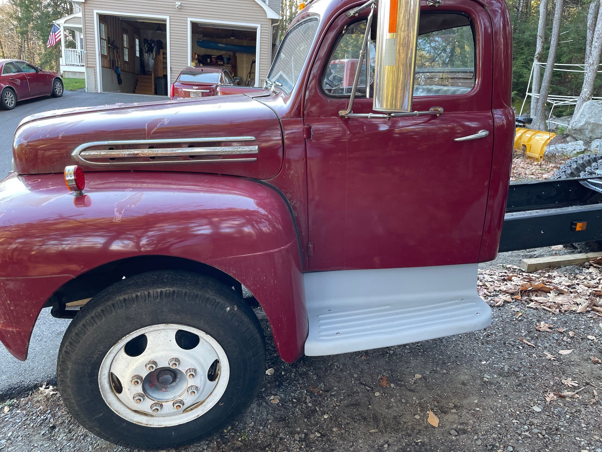

Does anyone know what part number or truck these c4500 knuckles are from? Any info would be helpful. Seems like if this is a possible solution for F-7/8 trucks this would be a more popular thread. I have heard of other knuckles being used but not without lots of machine work etc,ie $$$$.
This is one of my trucks for viewing pleasure. I have Dayton adapters for the front….
