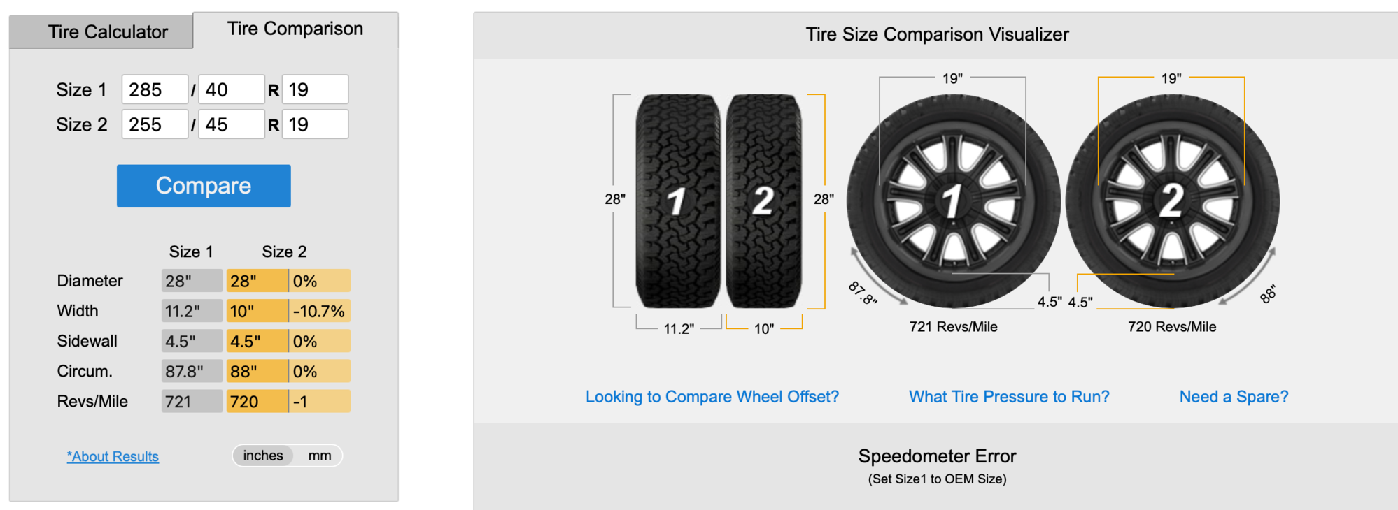

Im personally not a big fan of adapters but that may be the only way to get the wheels you want unless they do custom offsets. On the rear of my 62 I'm running 10" wide 15" wheels with 4.5" backspace and 275/60-15s with no clearance issues. If I'm calculating that correctly it's a -1" offset or -25.4mm. An adapter may get you close with 30mm positive offset, but I don't know the thickness of the adapter. That would be the first thing I would figure out. What is the best quality adapter for safety and how wide are they. On the tires for 19's I, personally, think a 28" tall tire looks best. Many run shorter. I found the staggered combo pictured seems pretty nice for a 8.5-9.5 combo. I would spend some time plugging in some different available 19" sizes on this calculator.... https://tiresize.com/calculator/
