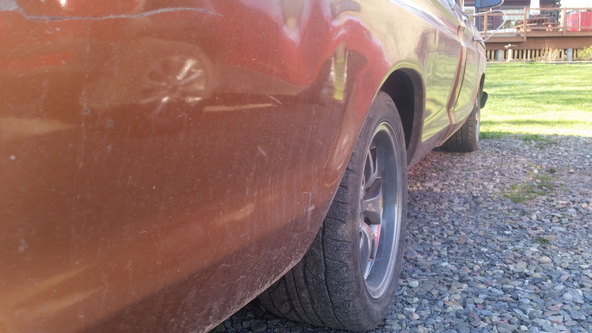

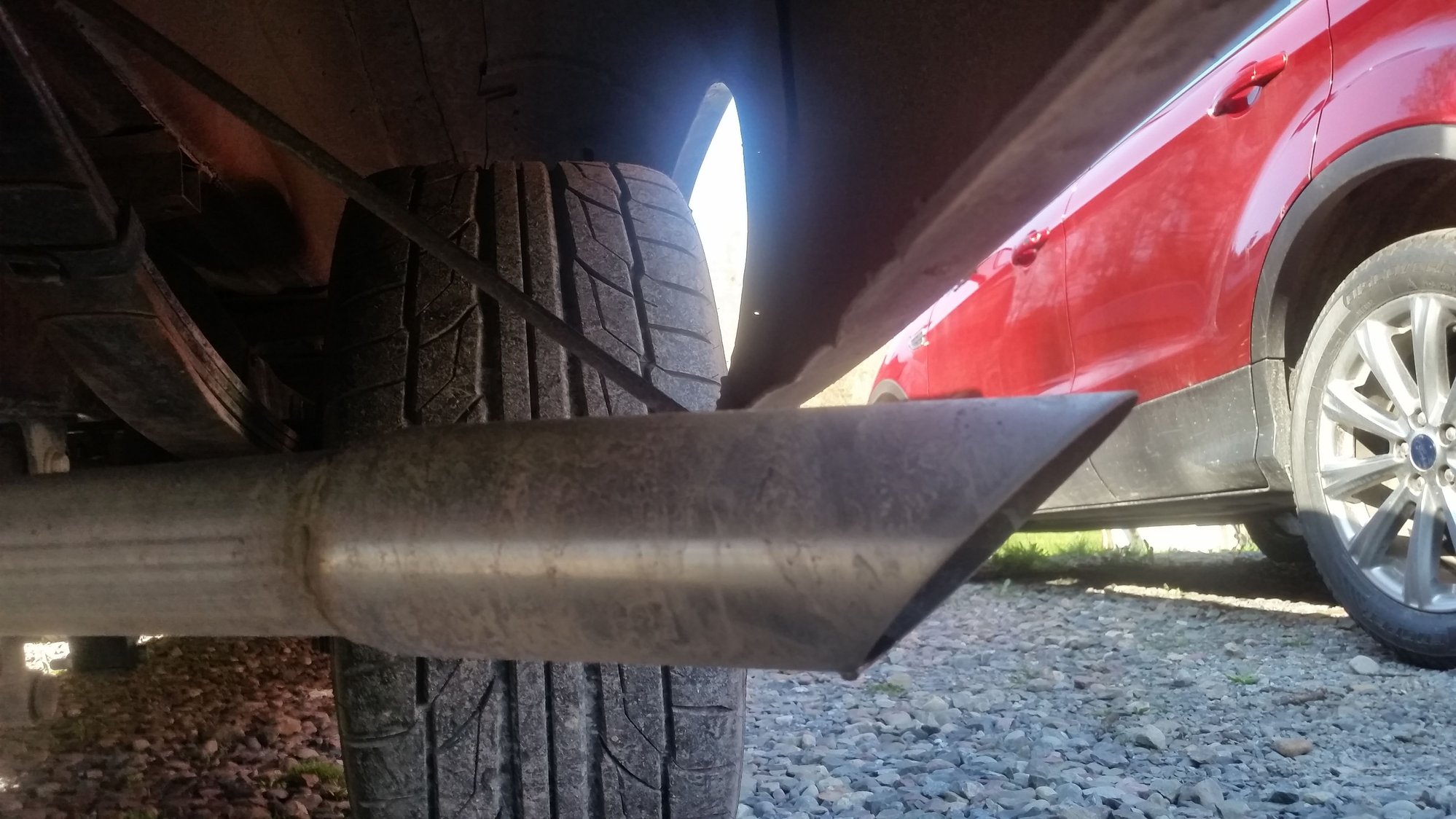

Not what you asked for but these are 18x10s with a 295 40 18 tire which is 11.5 inches wide and I had to widen the wheel wheels to get the clearanse I wanted for suspension travel or if i get wider wheels someday. It's a different xle and off set then your asking about but shows you an 11.5 tire I had about 3/8 inch between tire and wheel well before widening them.
This photo makes it lok like there is alot more clearance then there is

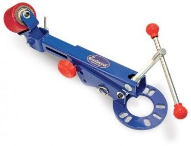

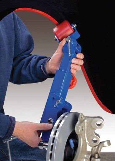

Thanks symonds86. This looks good to me but I need to understand what you mean by "widen the wheel wheels." Did you use something like this?
... and what was the offset and backspace of your wheels? TIA for your replies.
