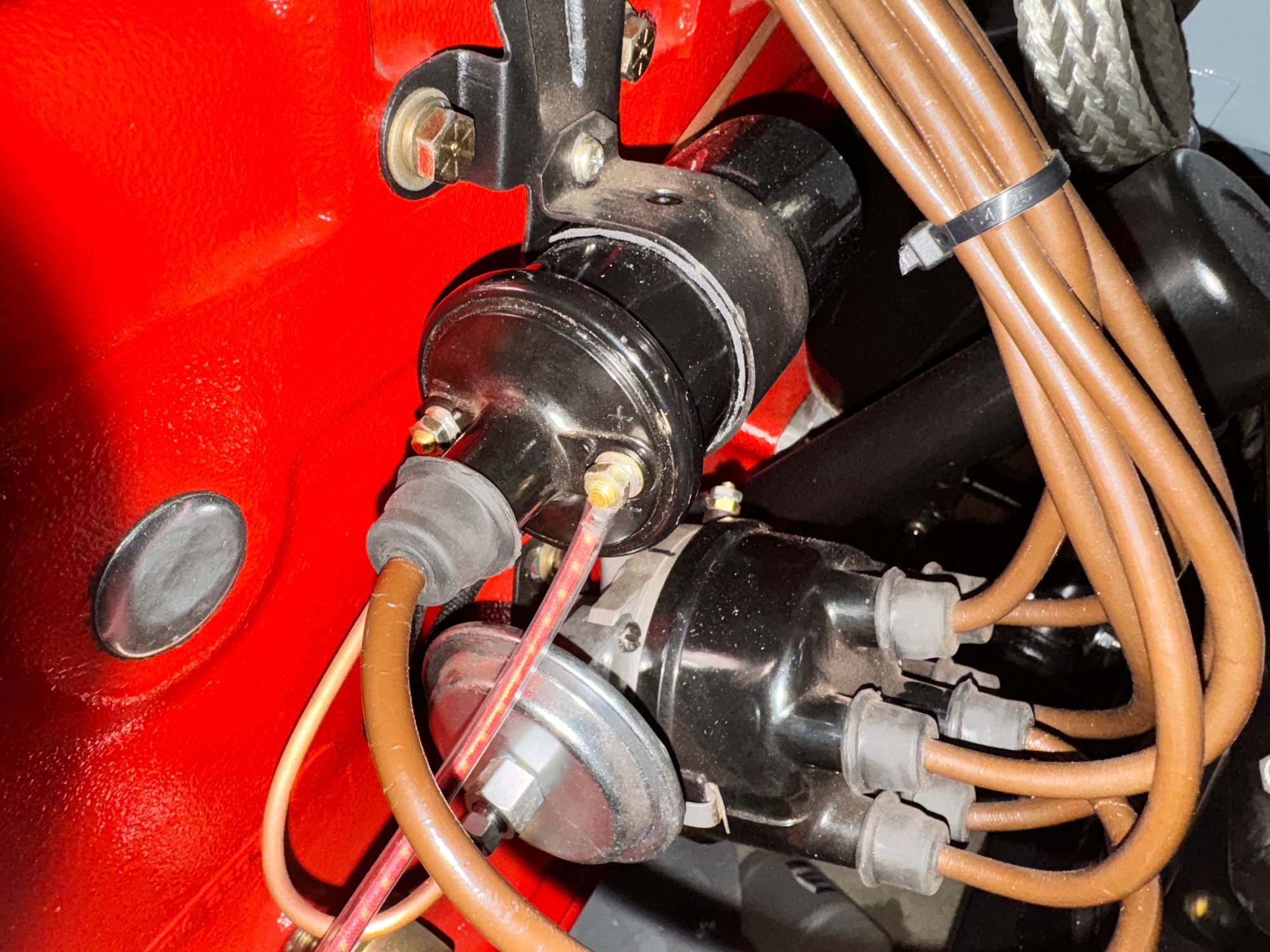

1. The engine started and ran at the shop i worked with on the rebuild fine, but he test start with a 12v, now that I have the engine in the truck I can't do anything to get it started and I have problems even to get it to try to fire. New to 6v, when I put the battery in the truck I did wire it as negative ground, I did correct that, and its now positive ground but did I hurt something trying to start it that way? It seems like I have a spark problem but I have a spark, but maybe seems weak.

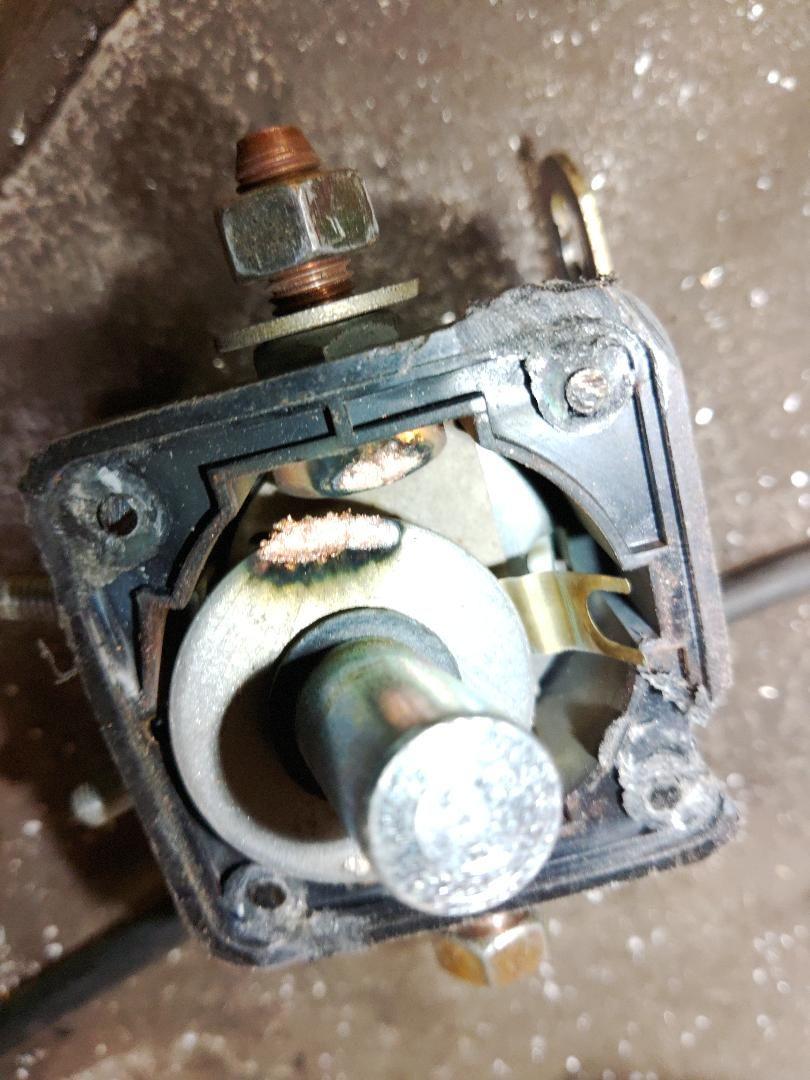

2. With everything wired up properly twice now the starter has continued to turn over even after stop pressing the button and I had to disconnect the battery.

Check your solenoid wiring. It matters which direction you feed it and load side. Also it may trigger from ground or trigger from hot. There were no directions in either of my solenoids. I even returned a couple. You can test operation with just the power hooked up. That way you are not triggering the starter as you are testing your hookup. You can use a tester to make sure power is passing through it.

If you suspect weak spark, make sure you have a 6V coil and no resistor (internal or external).
Also, with the negative ground oopsie, you may need to check the charging system out and re-polarize it.
If you are running a pertronix electric points replacement, it may be toast with all the electrical trials. They are great, but don't tolerate electrical anomalies well.

As for the starter continuing to run, it could be a stuck solenoid or starter button. There are two varieties of these, ground trigger and power trigger, so if replacing, be sure to use the appropriate ones, or rewire accordingly.

I am running a new stock distributor and points, as well as the 0 gage new As far as I know its a 6v coil, unfortunately it does not have any markings on it to verify.
On the generator I figured I may need to do that but just working on getting it started at this point.
My button is stock so its the ground trigger type, and new.

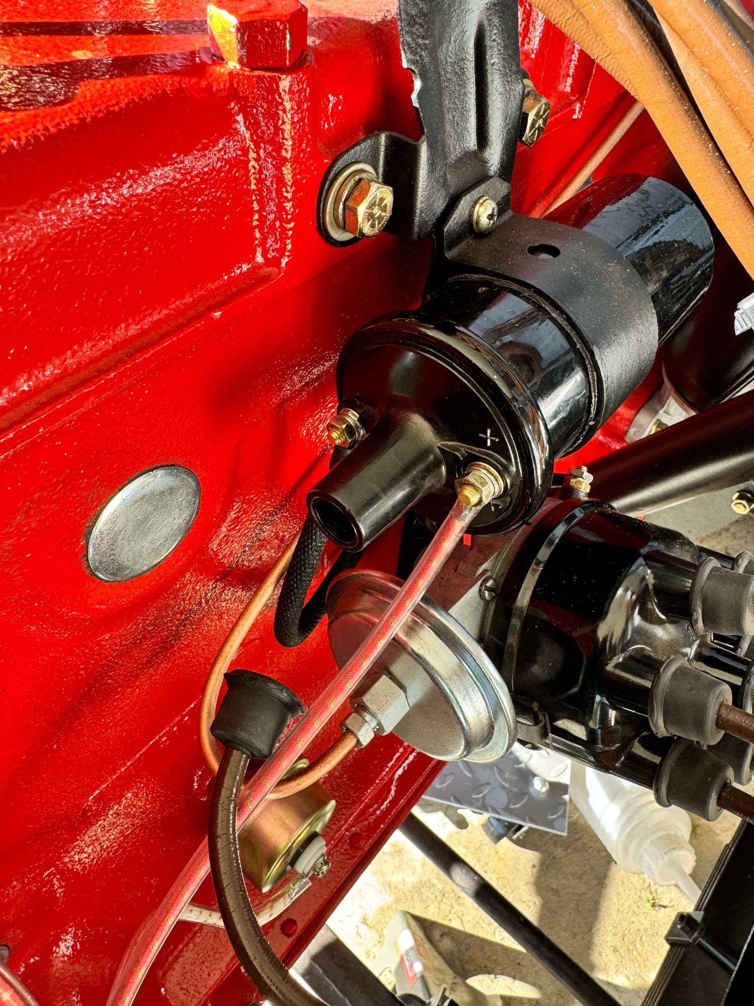

Added some photos

Looks like the two leads on the coil need to be switched.

With the wires disconnected, throw an ohmmeter across the coil. It should be just over 1 ohm if it is a 6v coil. And yes, the wire connected to the (+) terminal goes to the points.

I had the starter on my 390 not disengage when I tried to start it with a near dead battery, the result was a fried starter, the cause was welded contacts in the starter relay. The starter and relay were both a couple months old.

I was told both ways on the coil wiring but good to confirm since that is what I found on the diagrams. that it should be the negative going to the distributor and positive going to the ignition, I did flip it back but it would not start either way when I was trying before.
with nothing hooked up the coil is reading around 3.6 ohms positive to negative, I assume that means I have a 12V or when you say test across test from the negative to the center?

The coil will "work" with either polarity, but in a positive ground vehicle, the (+) terminal of the coil goes to the distributor/points as discussed.
Your 3.6Ω primary resistance reading is for a 12V coil. I would definitely get a 6V coil at this point. As for a coil, just about any 6V can coil will work. Some examples:

Both bad news and great news to confirm. That is what I was assuming was the issue, ie either a bad coil or a wrong coil, and it would have started with the12v battery as before.
I have ordered a 6v coil and will report back. Thank you all.
