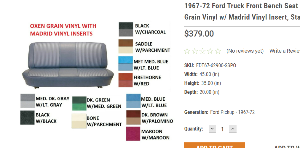

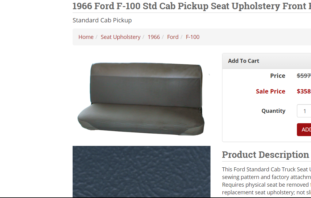

Does anyone know if the 1966 f100 seat the same size as a 1967 f100 seat?
I'm looking to recover mine and I found a couple good options, but they are for a 1967 - 1972 truck.
I'm not really finding any good options for my 66 seat.
