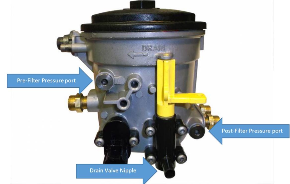

Another way to check fuel supply to engine is by using the water drain valve on fuel filter.
where is the drain valve located? This is a great idea!
Drain valve is on the back of the fuel bowl. It’s a pre-filter measurement but better than nothing.
This link from the Tech folder should describe the process. https://www.ford-trucks.com/forums/a...4&d=1592859516
You found the drain valve.
But to find the drain tube, where you would attach a drain hose such as Sky Ski Jason suggests, it is easiest to peer through the front passenger wheel well, to look for a metal tube that terminates mid air above the exhaust manifold on the forward end of the engine.
There are actually two metal tubes in that area, but only one is blunt cut and open ended, and that is the fuel bowl drain tube to keep the drained fuel from filling up the valley.
The other metal tube is for the Exhaust Back Pressure Sensor, but it is attached at both ends, and it will be readily apparent that it isn't a drain tube.
Once you attach your drain hose to the open end of the drain tube, it will be a LOT easier to collect your fuel drain sample.
