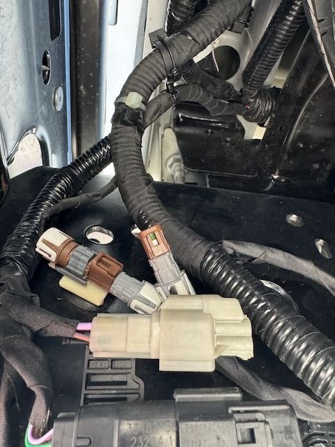

Anyway… Back to the issue at hand… I went out to install a trailer camera 7-way connector. When I was under the truck, I noticed there was an empty camera cable hanging there… It didn’t have a cover on the end of the plug or anything, so that has me very curious. All of my cameras are working currently, so I don’t know what that’s doing there. I don’t know if it was there before it was worked on or not. I want to pull the cover off the tailgate and check everything out since everything’s been done. I opened it up before bringing it back in, but haven’t had a chance to open it since I got it back yesterday.

I talked to the dealer about getting a cap for this camera connector, but apparently the connector is dead and could be removed. The harness was replaced or something, and somehow that was a remnant of that process. I don't know the details beyond the WO above.

I had a chance to take a look at what they did... It looks like they replaced the camera cable and they didn't pull out the old one from the loom. That's the reason for the dead connector.

A little further detail with the camera cable that was replaced. They just zip tied the new cable to the outside of the existing loom and left the old one in the loom. I’m sure it would have been a pain to replace it in the loom, but it does leave the new cable unsheathed and exposed to potential damage. Hopefully the recall just replaces that whole harness and takes care of that small thing.
