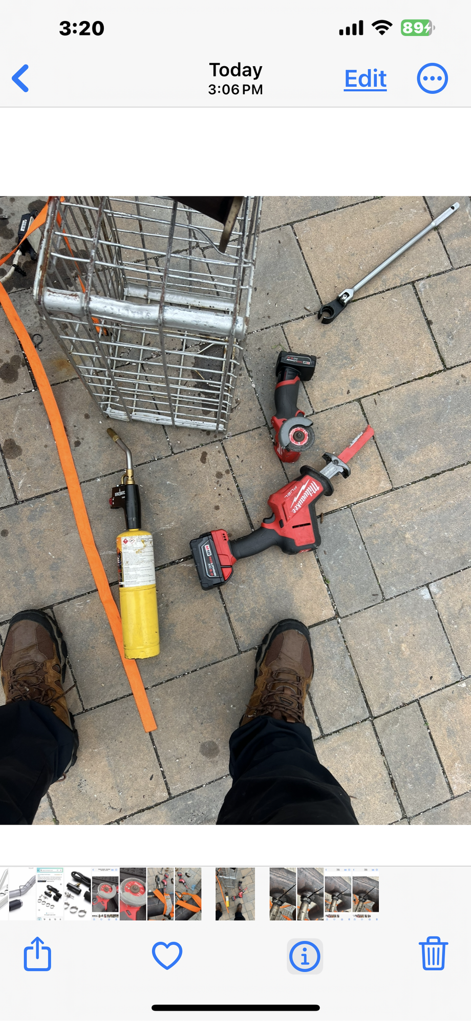

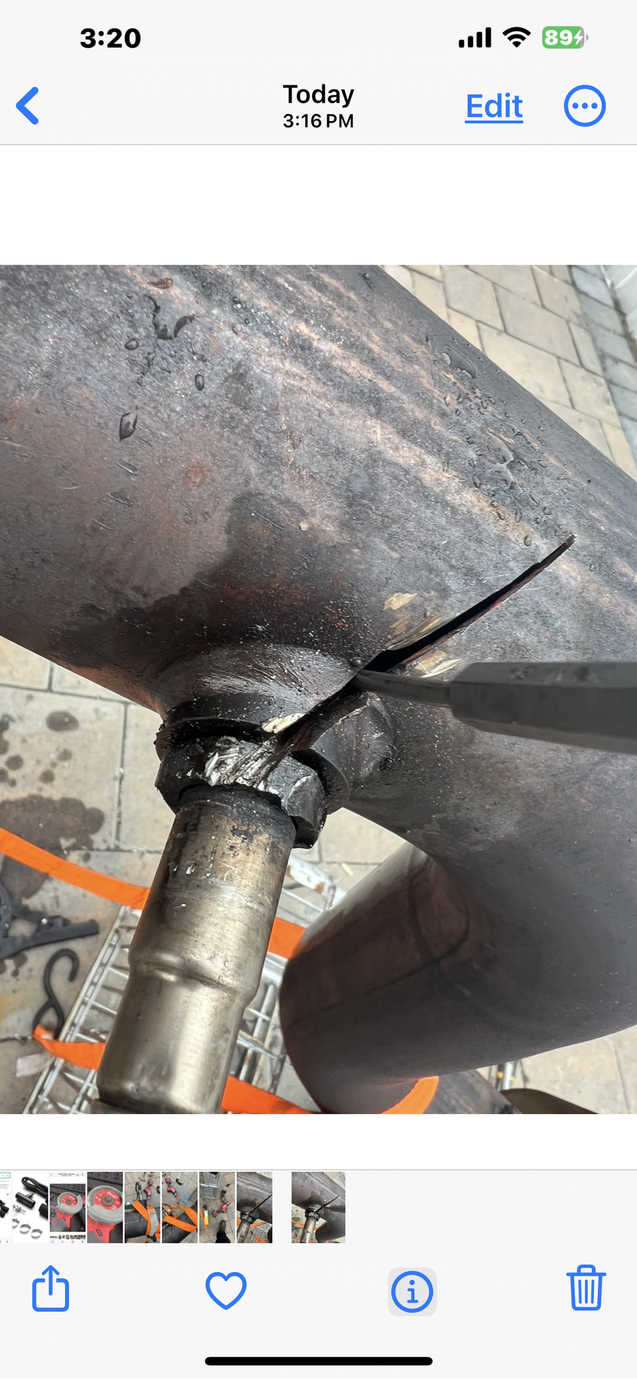

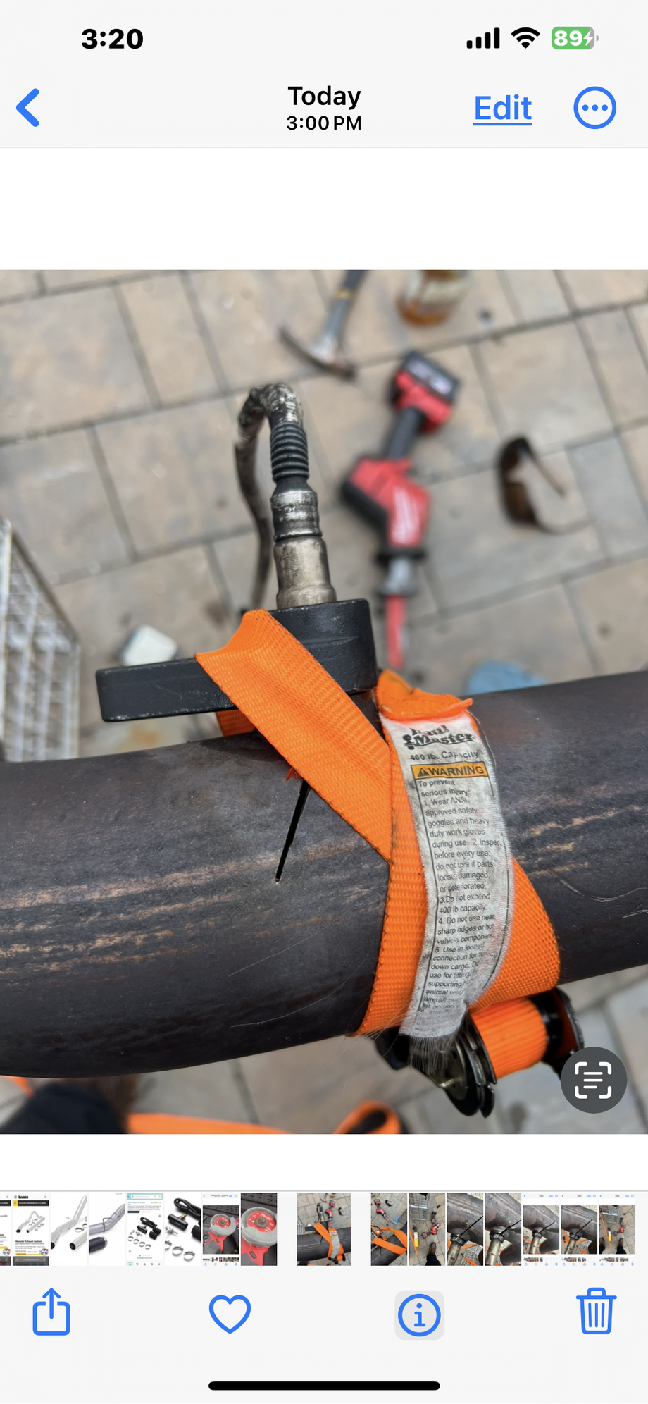

I cut thru the pipe , up to the sensor, right thru the bung. I split open a 1/16 cut to 1/8 of an inch. Pb blaster, tourch, 3lb hammer, correct sensor socket with 18” breaker bar. Did not come out.

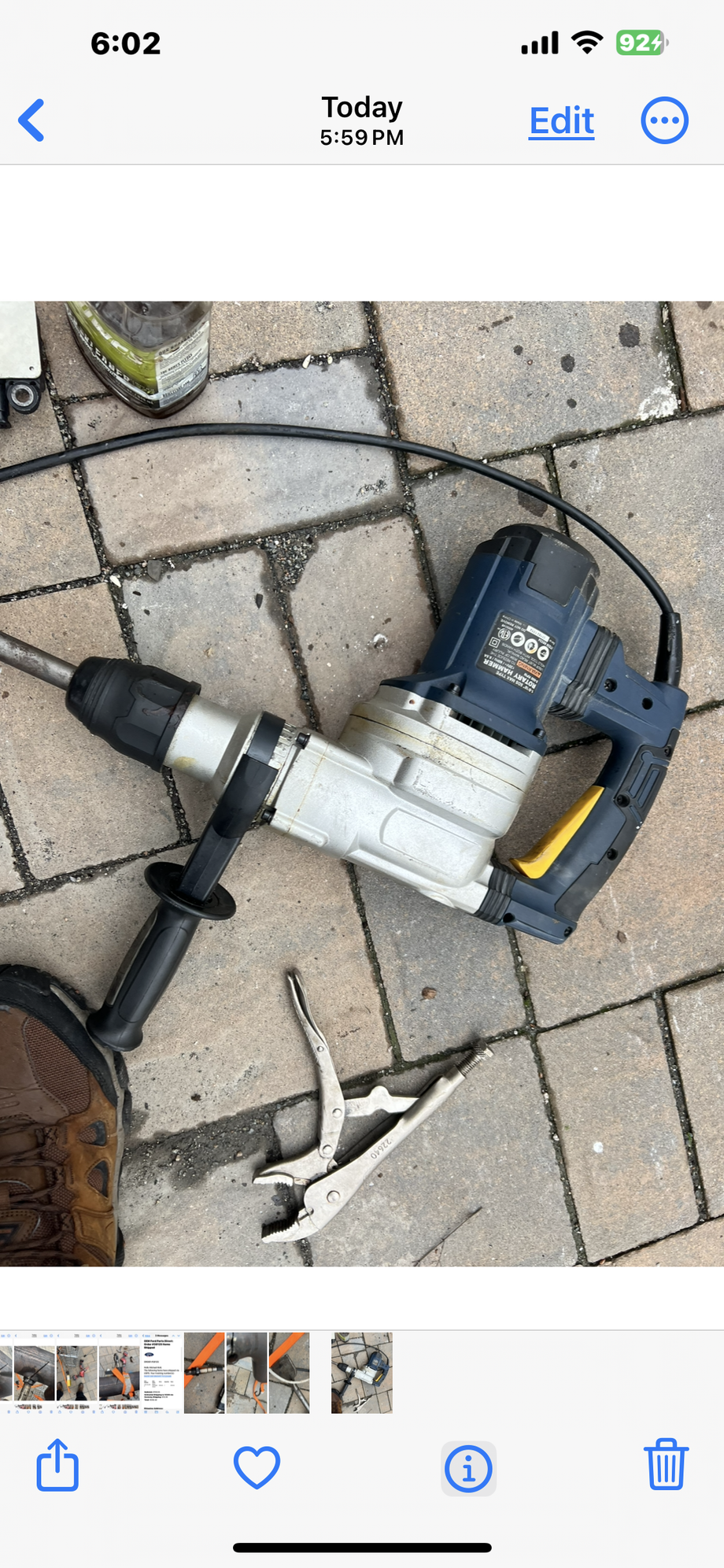

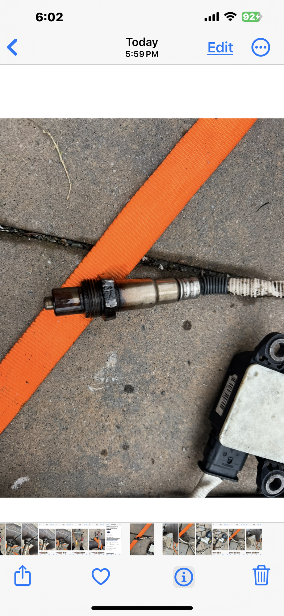

Got it out
i used a cheap harbor freight jack hammer into the cut I made…came out with vise grips.
now…does it still work with all this jack hammering, torching, , banging with a 3lb mallet, etc.
hopefully it will get me by until the new one arrives.
