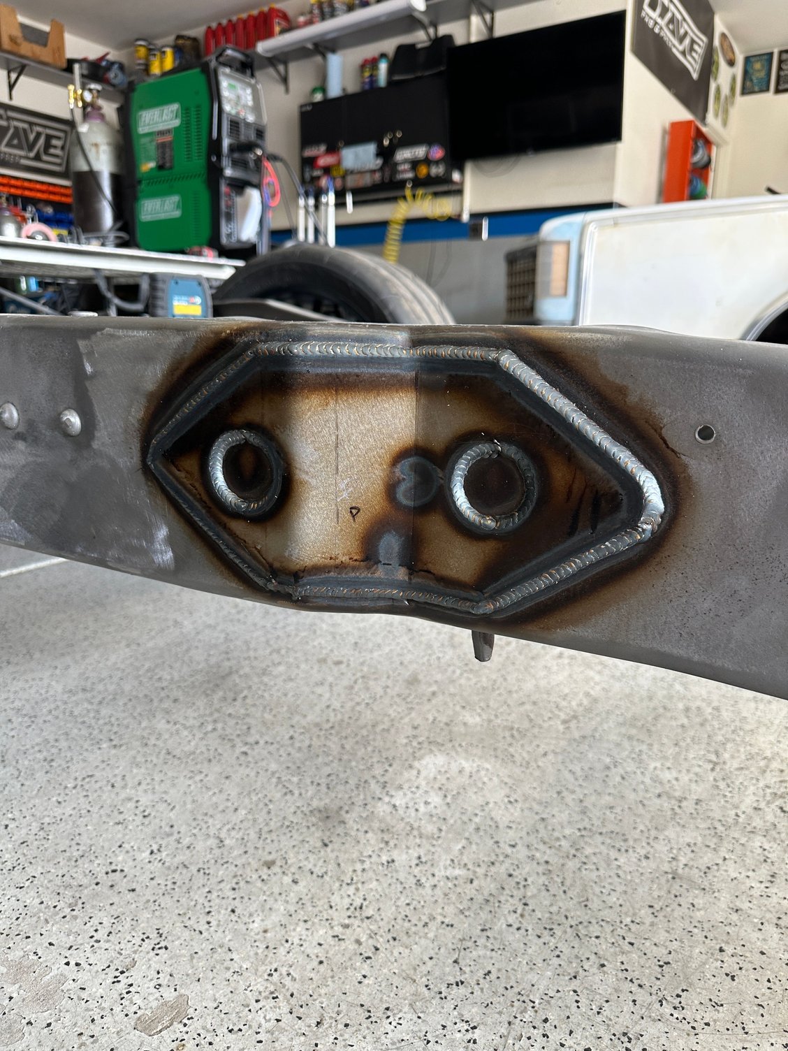

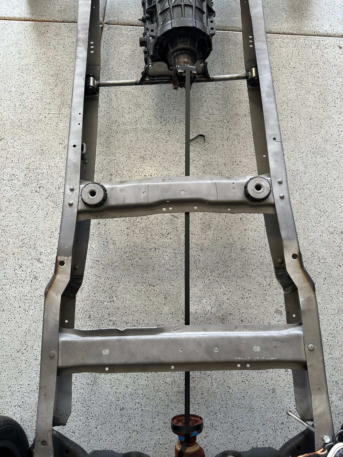

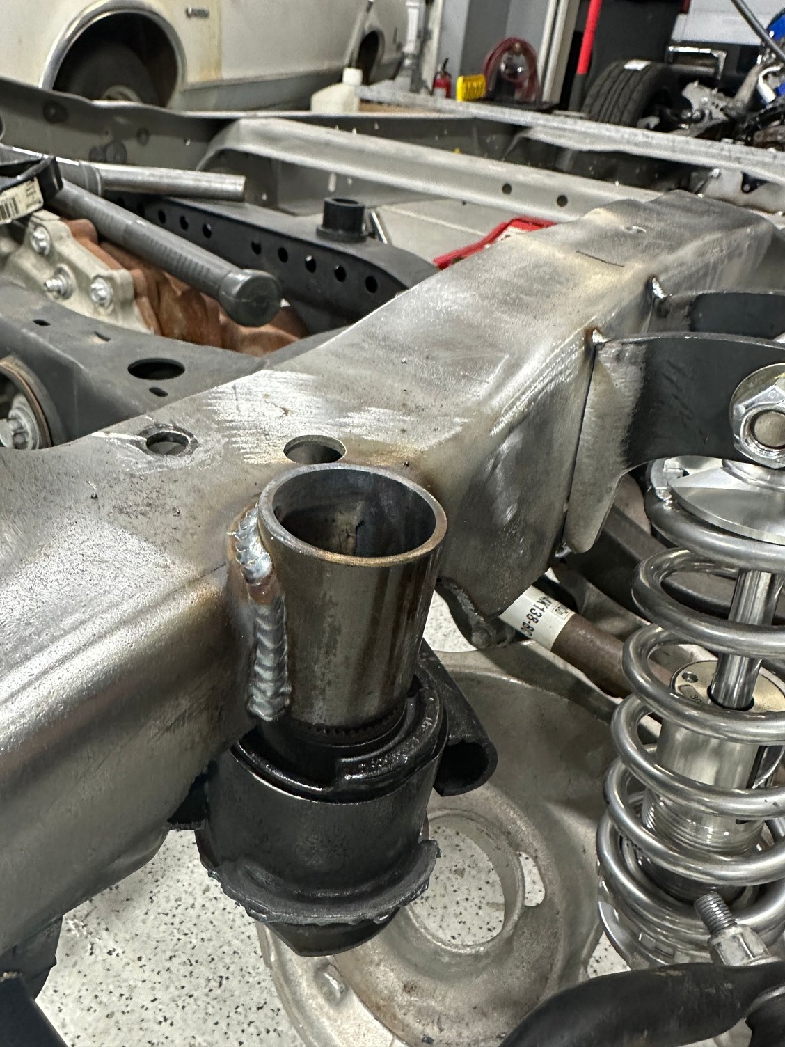

Been a while since an update. Last night I got the rear S550 subframe squared and mounted into the frame. Mounts are likely overkill but I wanted to make sure it was bolt in as opposed to welded to the frame to allow removal and also alignment adjustment for thrust angle like the OEM S550 would allow (I can also powdercoat it a different color to stand out from the frame for aesthetics)
Next is to mount the Boyd fuel tank, but that will take some mind skills because I had to use the 67-72 tank since using the S550 susspension.

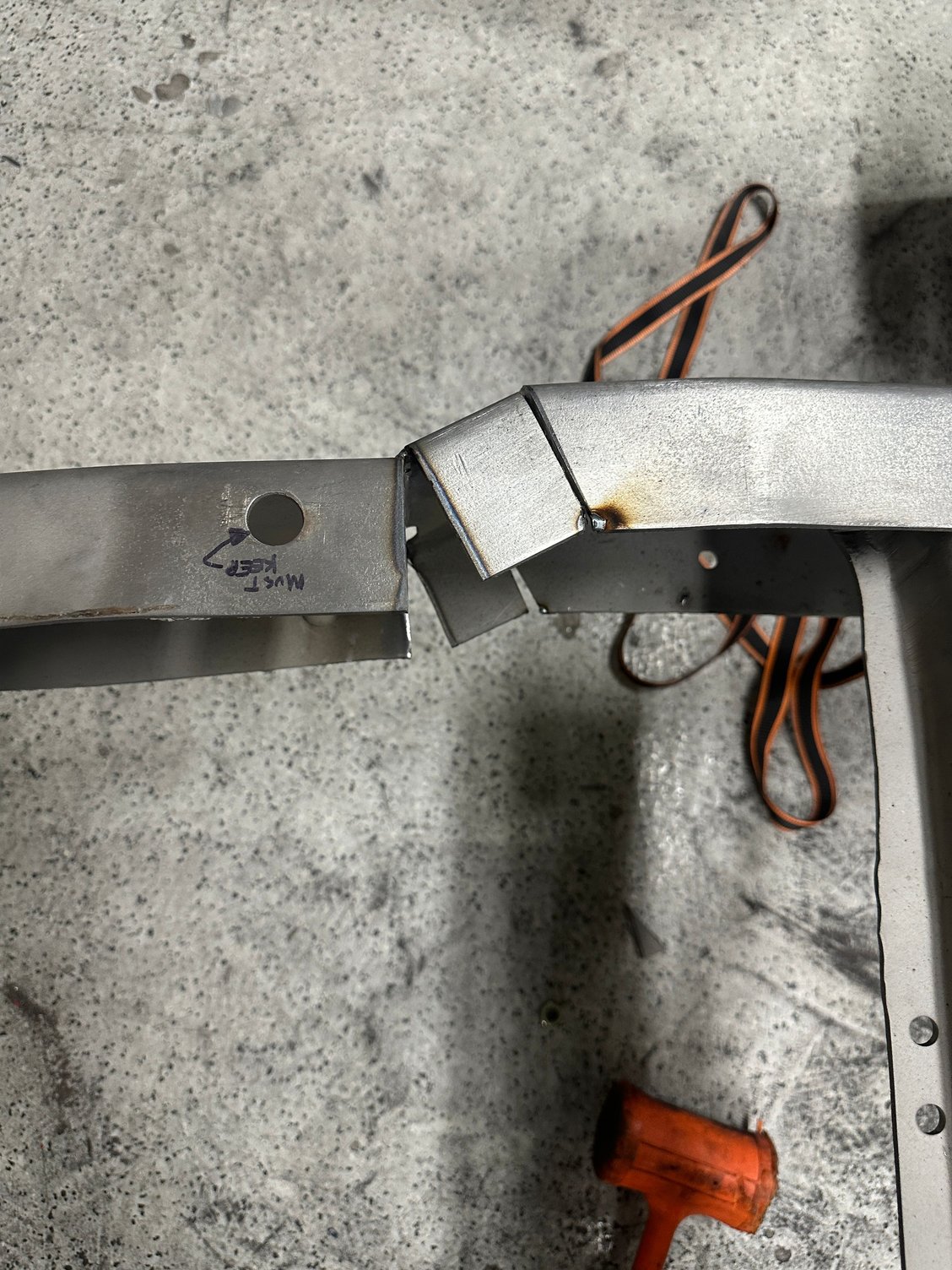

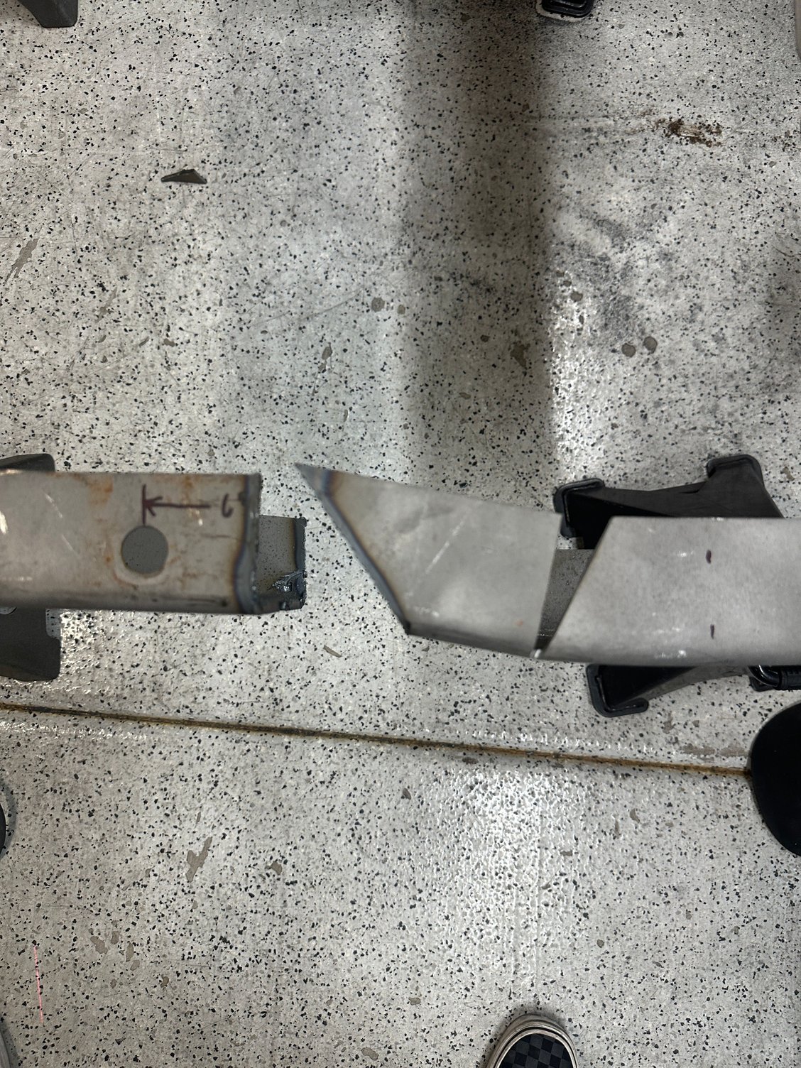

I made the massive decision this weekend and decided to commit to making it a short bed!! I did a ton of YouTube "research" but ended up choosing to just do a straight cut for simplicity, then pie cut to pull it forward close to where the frame turns out from factory. I ended up being within 1/16" of square. To make it truly square, I ran a heavy weld bead down the short side which after the weld fully cooled, it pulled the steel into exact square!!
By plating/welding the exterior I can assure you, its stronger than factory. I plan on brunning a cross bar that will double as a driveshaft hoop for more structure as well. Still a work in progress to weld the insde and smooth it all out.
