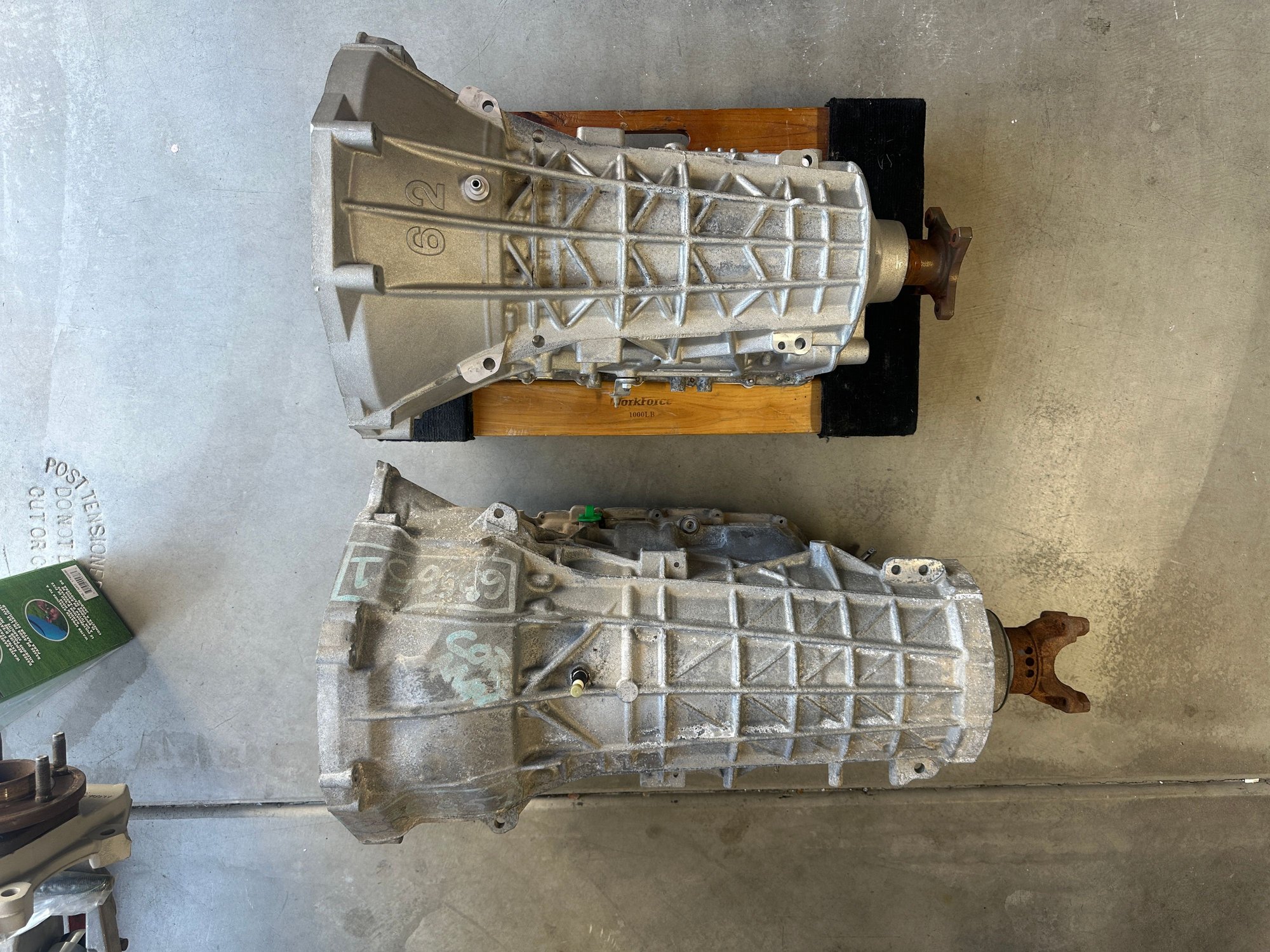

my newest challenge is a possible transmission swap. Getting rid of the 10R80 and instead going with the 10R140. My biggest reason is for the control pack option that Ford Racing offers. This would make it much more seamless and operational faster. Other pros are that it is much stronger and I already have one. Haha.

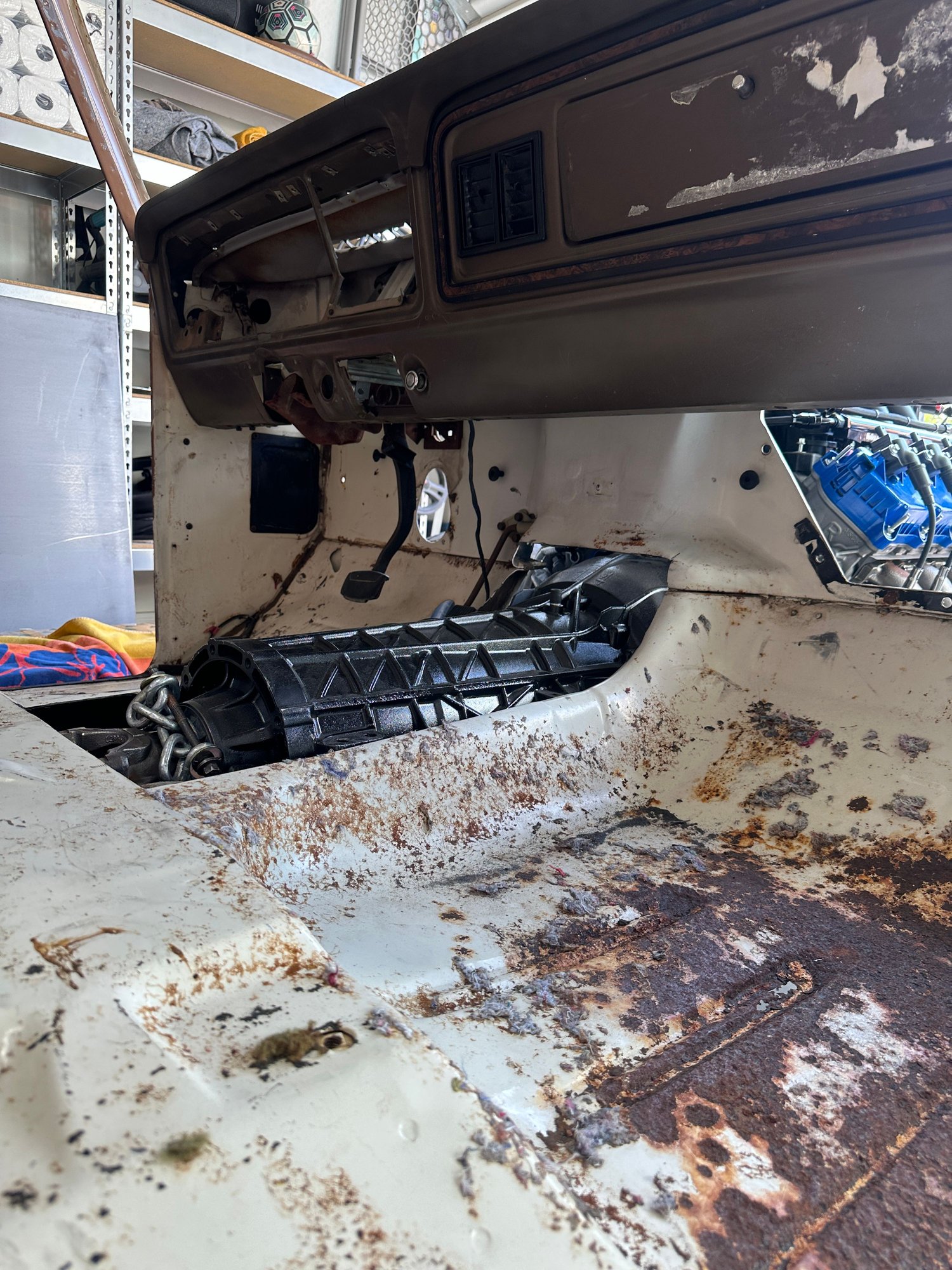

Fitment is obviously a big concern. I emptied the 10R140 out down to the case so it’s lighter and I can easily slap it on the back of the 7.3L, then drop the body on. I am already prepared that the flooring will need cut, but that will push me to do a nicer center console and bucket seats. Win win….. hopefully.
Here is a picture of the 80 and 140 next to each other for size comparison

Sorry for such a long time for updates on this:

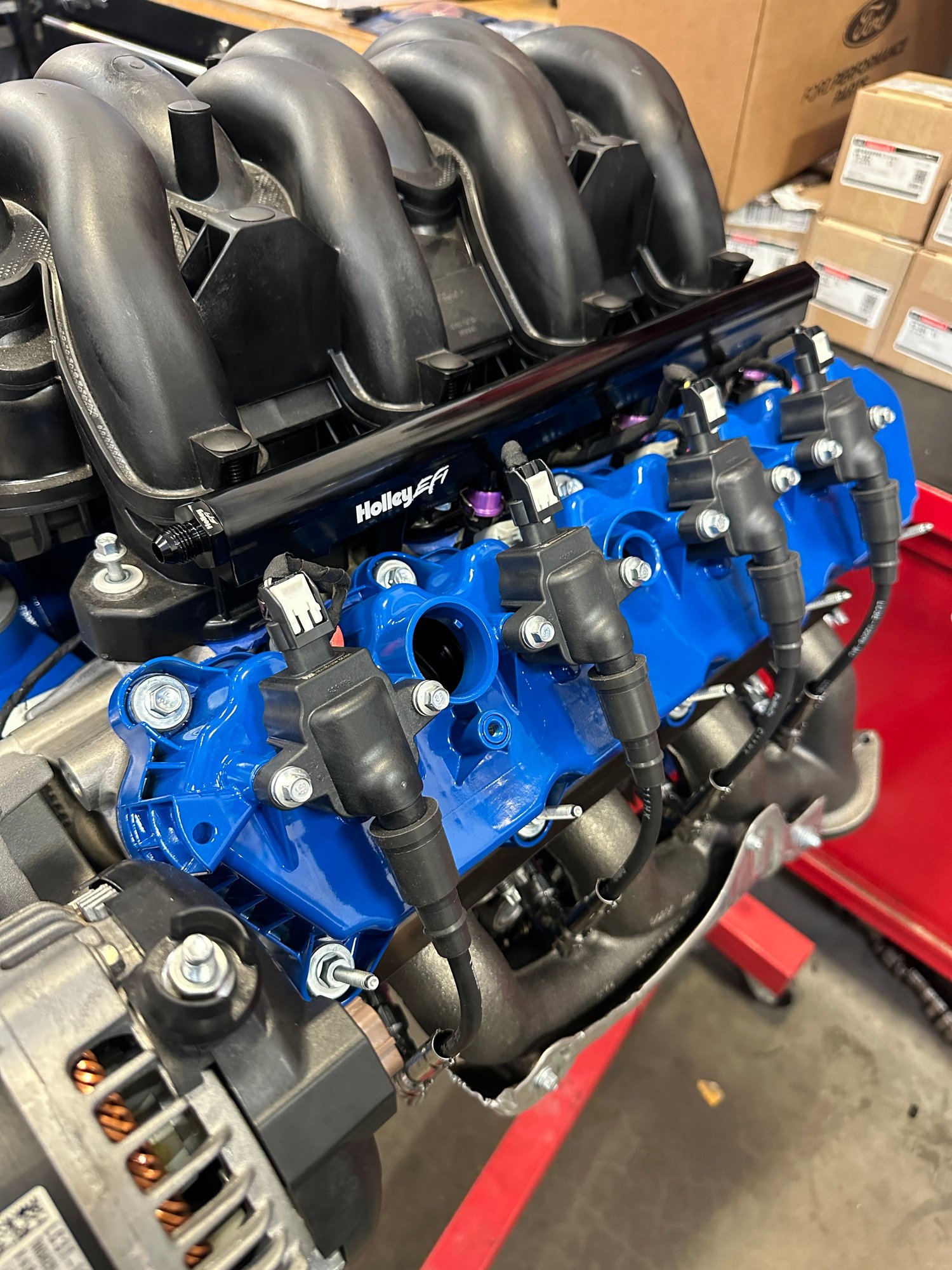

I have the Godzilla fully torn down and built - BTR cam and limiter, head work, and Wiesco pistons (gapped for boost just in case haha)\
The 10R140 is fully rebuilt with all OEM parts and updated CDF and frotn pump support

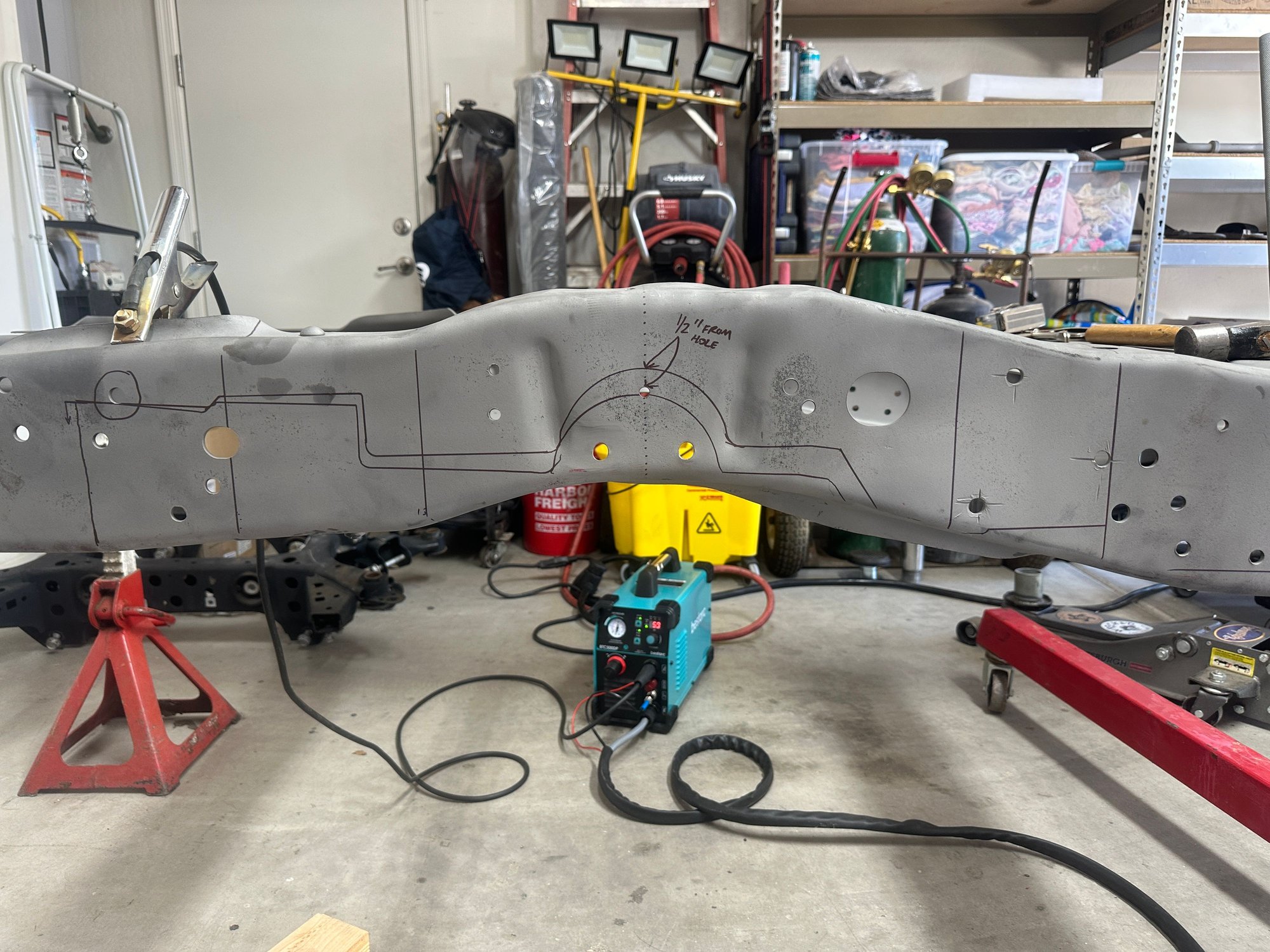

Rear S550 suspension is cut in and held in place temp
Ford Performance control pack is being used for controls
Tucked and re-spliced all or most wiring for injectors, coils, and engine sensors under the intake for clean look

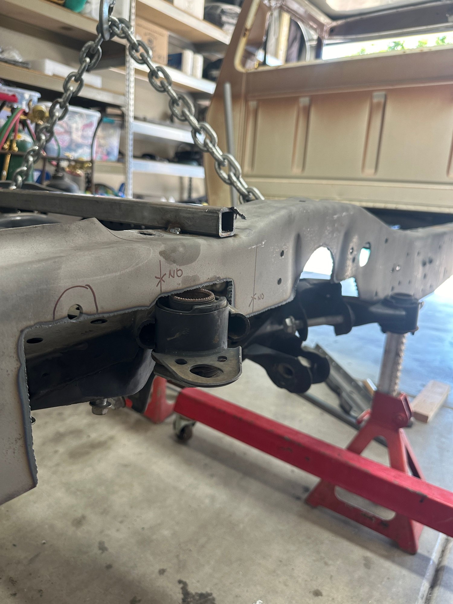

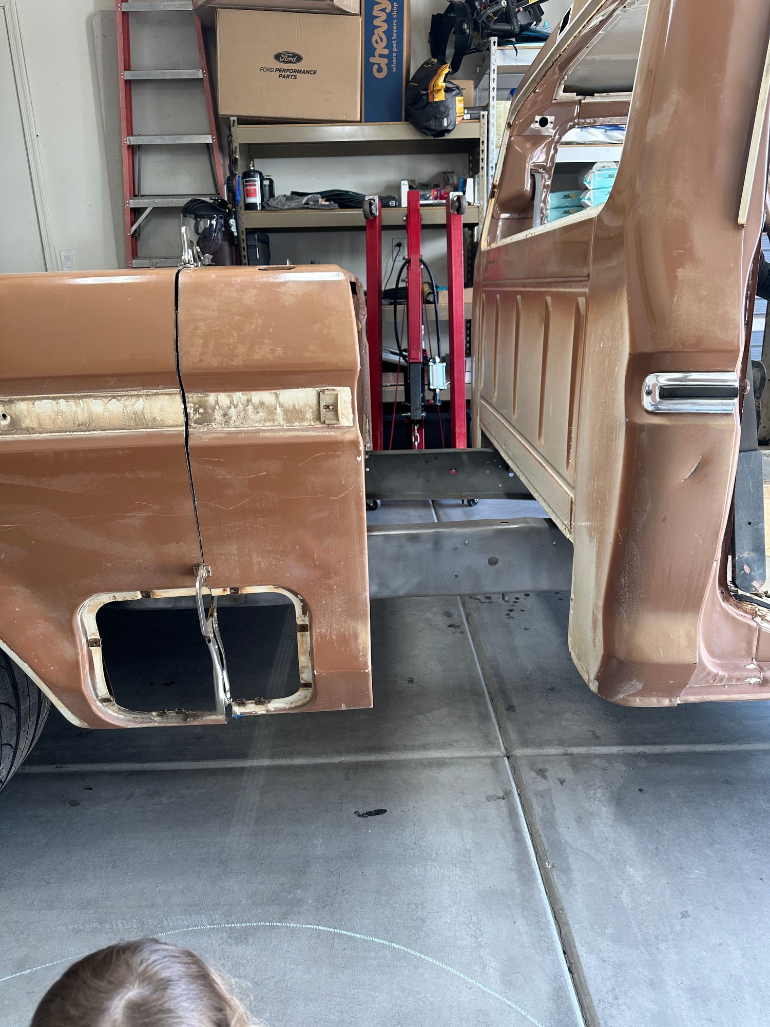

Decided to chop the bed and frame down to a short bed

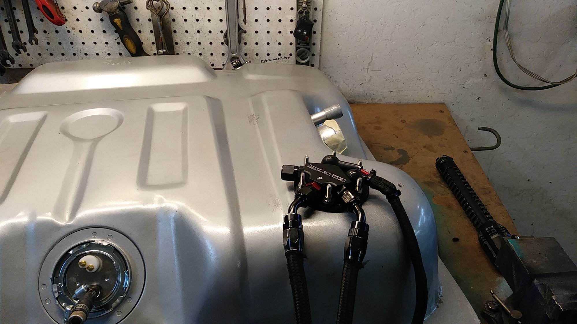

Boyd fuel tank with Aero fuel pump
Injector Dynamics 1000cc injectors and inline flex fuel sensor for future ethonal
305/35R20 Nitto 555RR on the rear
What i did find out is the powertrain is going to be off centered by about 1.5" to the passenger side for multiple reasons
1. The body and floor pan is off centered
2. The Crown Vic front support/engine craddle is actually off centered to the passenger side on the "up rights" where the engine mounts
3. Although the rear S550 carrier is centered in the subframe, the pinion is off the the passenger side as all ring and pinions are by design
The powertrain is sitting at exactly 0 degress so i will match this by pointing the pinion down to 0 as well
Oh and the bad *** big news is I the engine fires right up and sound like pure American bad *** big block!!
