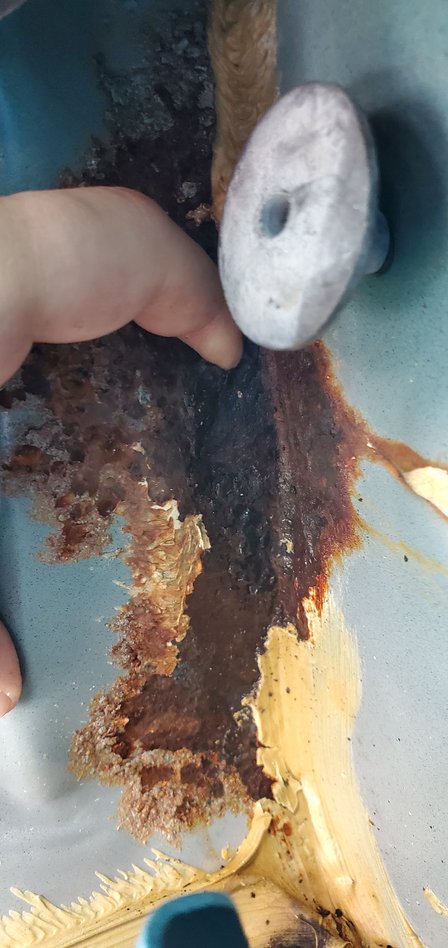

So big problem guys. I pulled the dash. Apparently the rust inside the cowl was a worse than I had anticipated. Below are some pics from behind the dash. What creative ideas do you think I can use outside of welding to stop this considering the fact that this is wear is MEANT to flush off the windshield/good. I'm going to try and absolutely COVER this top and bottom with an inch of seam sealer, but wanted to know if you guys think of anything else.

remove bad metal. use metal panel bonding adhesive to put a new piece over it as best as you can, use at least 1 fastener if you can, and then seam seal, paint etc.

That would have been my guess. I had the guy that replaced my rocker panels and outer floor cut open that area on each side of the cab and make access panels. That way I could get in there to dig out and replace what was left of the seam sealer.
Until you get the rust removed and replaced with new metal you are only going to put off the inevitable. It might stop for a little while until the rust grows enough to start leaking again or the blobs of sealer fails.

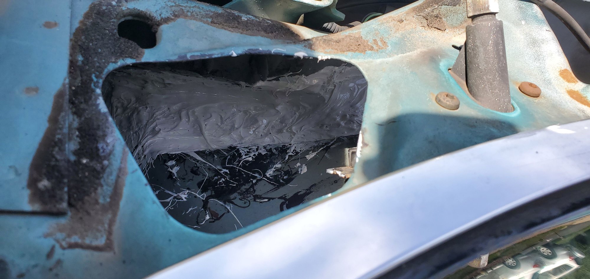

Welp, guess who's putting off the inevitable! Just hoping that it buys me 2 years.... Cut out the rust, sanded, panel bonded in a piece of metal... And LOADED on the 3M seam sealer... If it passes the 3 day of rain test this the next few days. The dash will go back in. If not, I'm cutting a hole in the floor pan so the water goes down and drains right out.
Without further ado, I present to you, frankenseal.

Ok guys! It's been 48 hours of heavy rainfall and I believe I was successful at my temporary seal. Killamat or some sound deadener is coming tomorrow at 4am. So I will be applying it and booking it to get the dash back in and the truck to the other side of the road by 8am. Street cleaning at 8am-11am.
