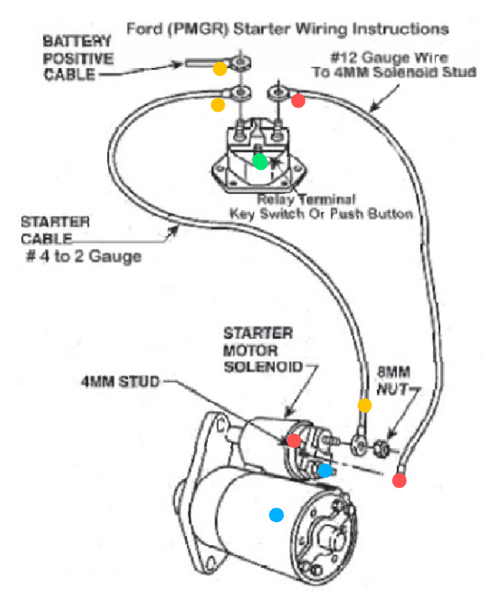

Check the wiring connections, as stated above, for corrosion.
Do you have a volt meter?
As long as the battery has power, you should have 12 volts at the yellow dots.
When the key is turned to the start position, 12 volts should be present at the green dot.
That voltage to the green dot closes the connection at the fender mounted relay and voltage goes to the red dots.
That energizes the starter motor solenoid and power flows from the yellow to the blue dots and turns the starter.

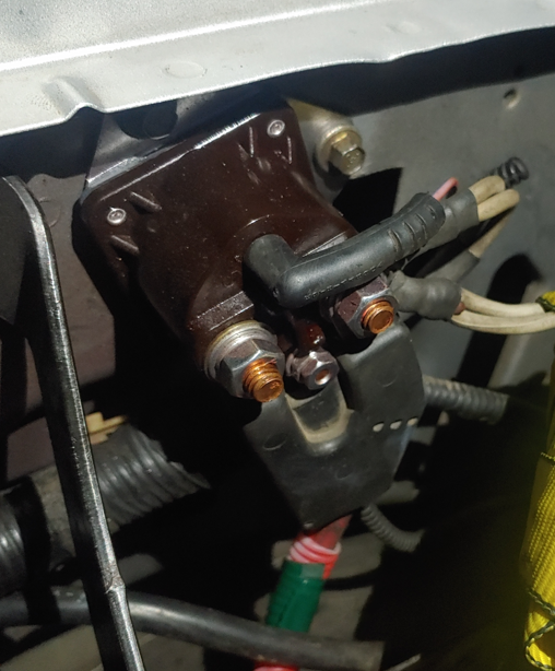

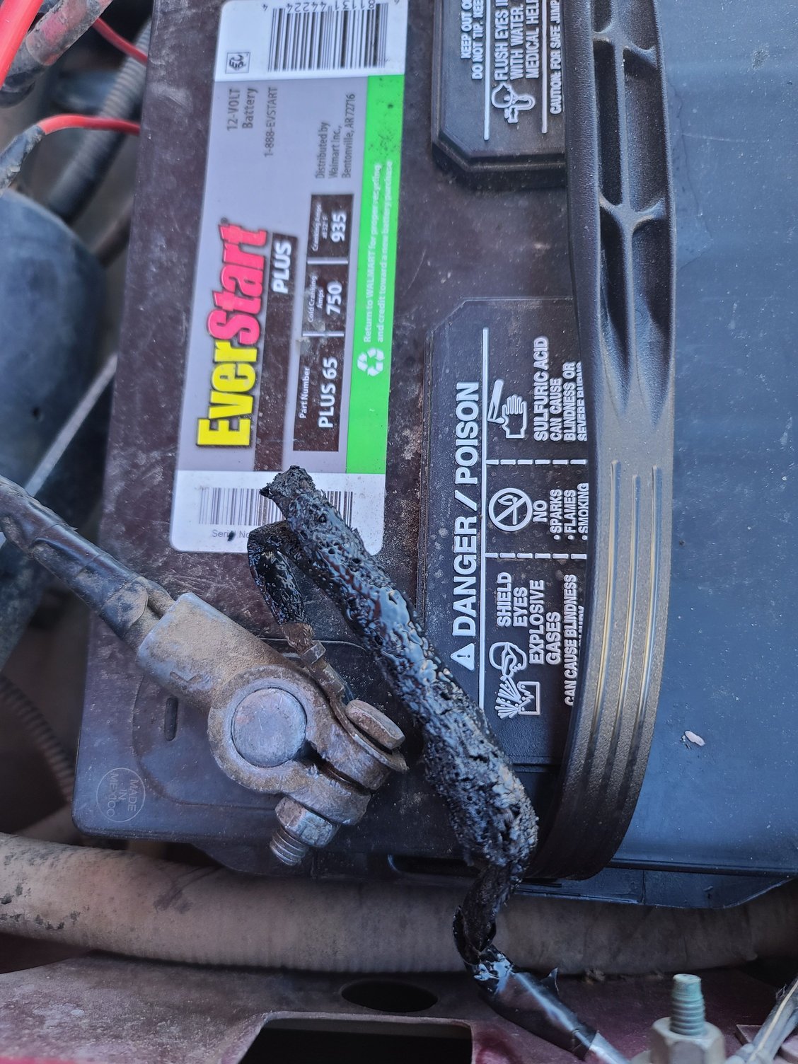

Sorry it has taken me so long to get back to you guys had stuff with the kids. I'll try and do a drop test on the starter today. I finally got the pics of the top under the hood and by the starter. Thanks for all of the feedback, I am going to keep plugging away at it. The truck was parked for about 3 years and given to me so I've been trying like hell to get it going! One other thing I wanted to add, I got the truck to start running when I first got it. It would misfire a bit so I replaced the plugs, distributor cap, coils, and rotor. When I took it out afterwards I noticed there was smoke coming from under the hood. When I parked it and looked under the hood the ground wire from the battery to the frame for the accessories had completely fried like burnt up. So, I went and got a 4 gauge wire and made a new ground which is the green wire you see in the picture. After that happened it set all of this off. Hope that helps.

if i had a **** poor positve connection like that , I wouldnt want to start either (if i was a vehicle)
Youre also missing a screw on the starter relay solenoid doodad, it needs to ground through the screws and it has only 1 of 2.

If the body ground burned up like that, it implies the ground to the block is no good.

Use a jumper cable from the battery negative post to the engine. Then try cranking the engine over. The temporary jumper will provide a ground path for testing. Your body ground cable melted because of excessive current flow due to a poor ground path to the engine. You need to resolve the battery to engine ground problem. On V8 engines the negative cable does not attach to the starter mounting bolt like the inline 6 cylinder engine (poor design BTW). It's attached to the block.
