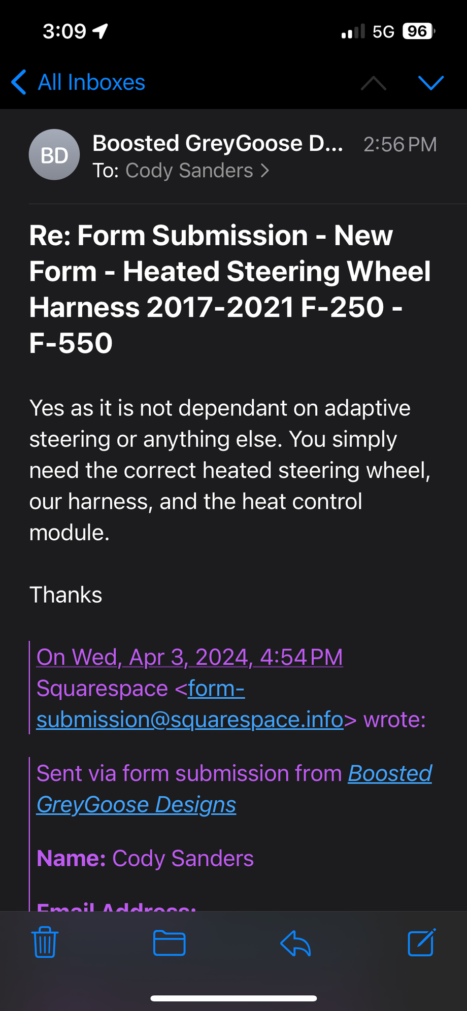

To make matters more confusing the company that makes the wiring harness in the link said this when I asked if it works with adaptive steering.
They may just be unfamiliar with the differences between the way it is setup with adaptive steering vs without. I haven't looked, into it yet, but if all AS wheels are also heated, than there would be no use for an aftermarket harness anyway, because no one with adaptive steering would be needing to add heat. (Edit- It does look like there is a steering wheel with Adaptive Steering but without heat for the Lariat)

I just told them the exact same thing you just posted. I believe the tech was unfamiliar with the truck differences and tried to make it work with the wrong components. I think the module in the adaptive steering went bad and they looked for parts that were never on this truck and concluded they were missing or never built from factory. This should be covered by my cpo warrenty with a new steering wheel to fix it imho.
