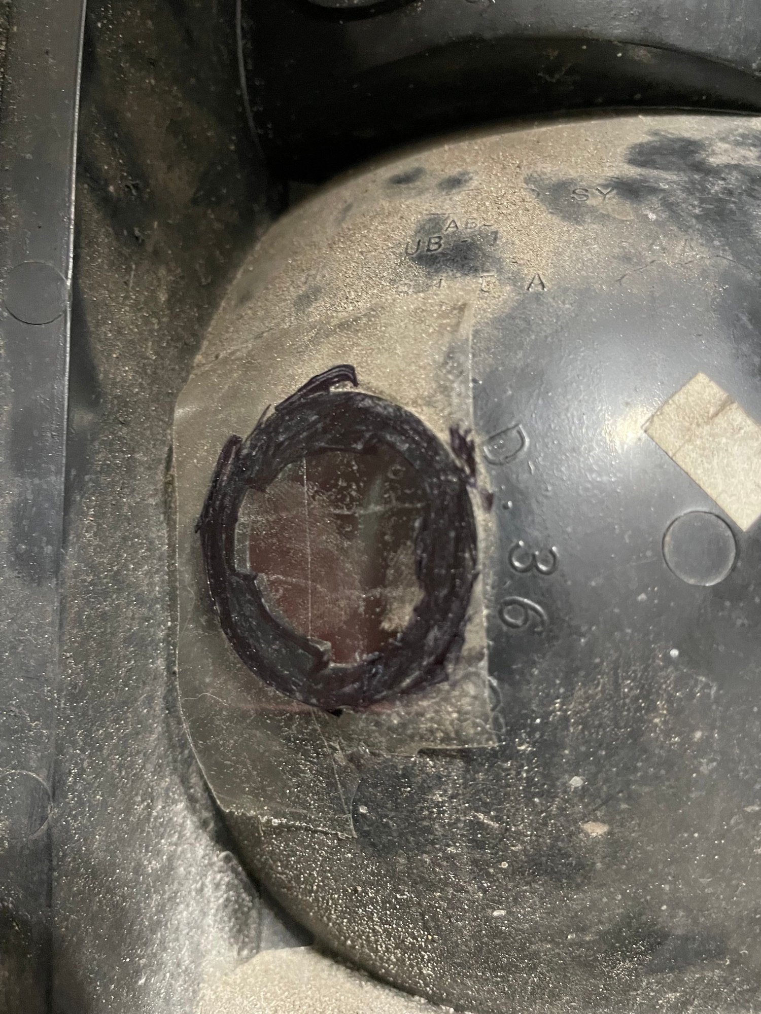

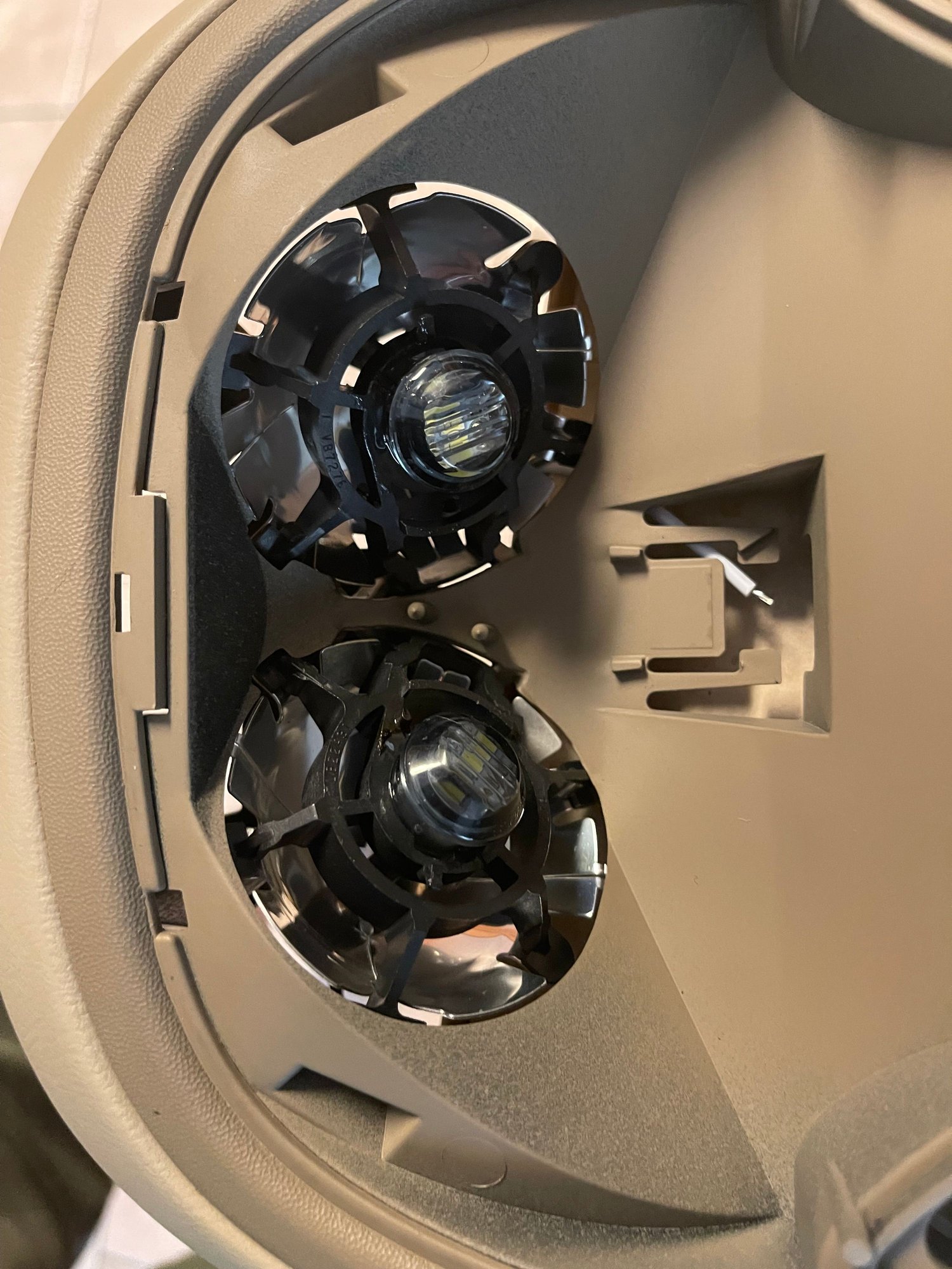

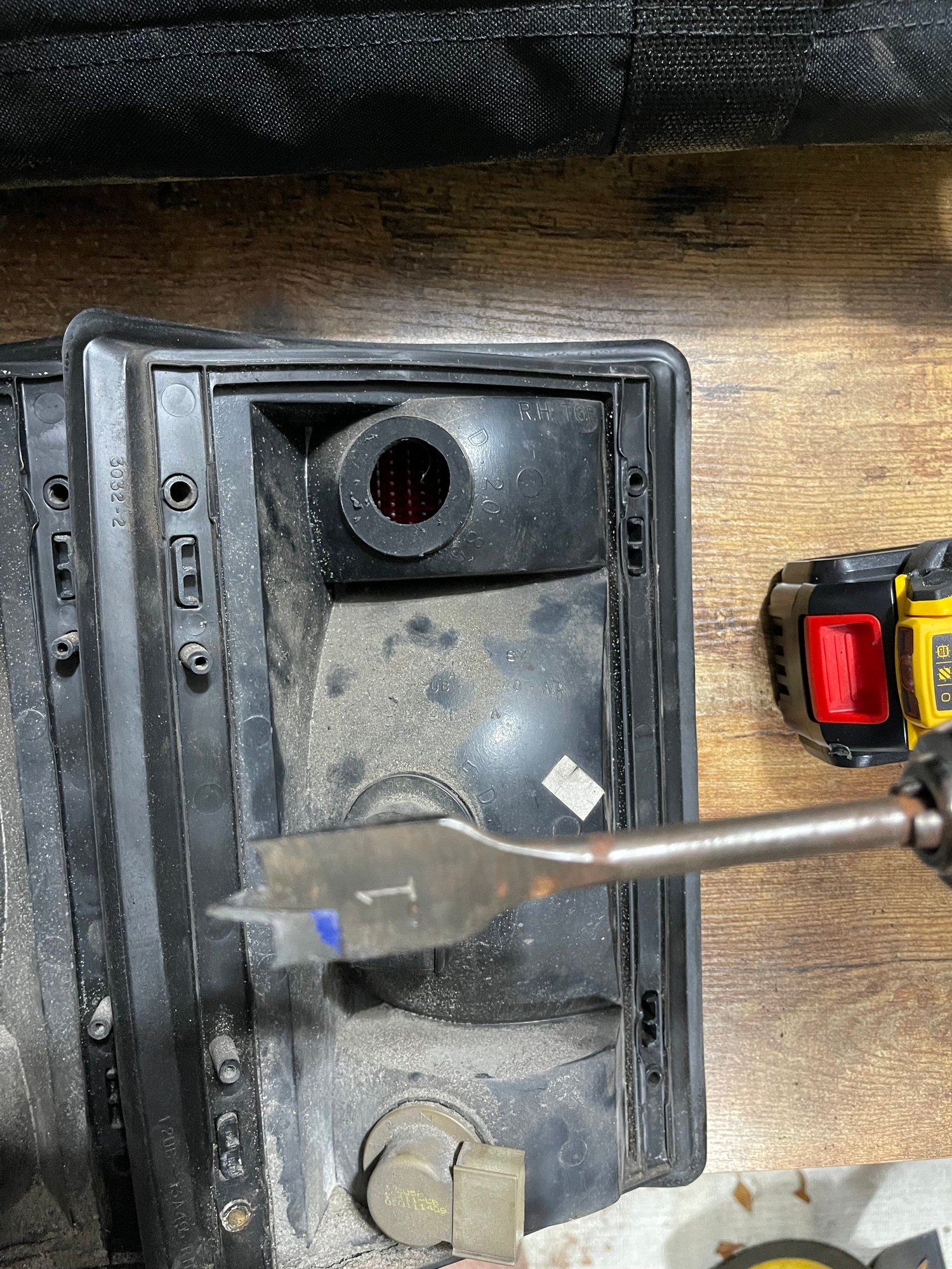

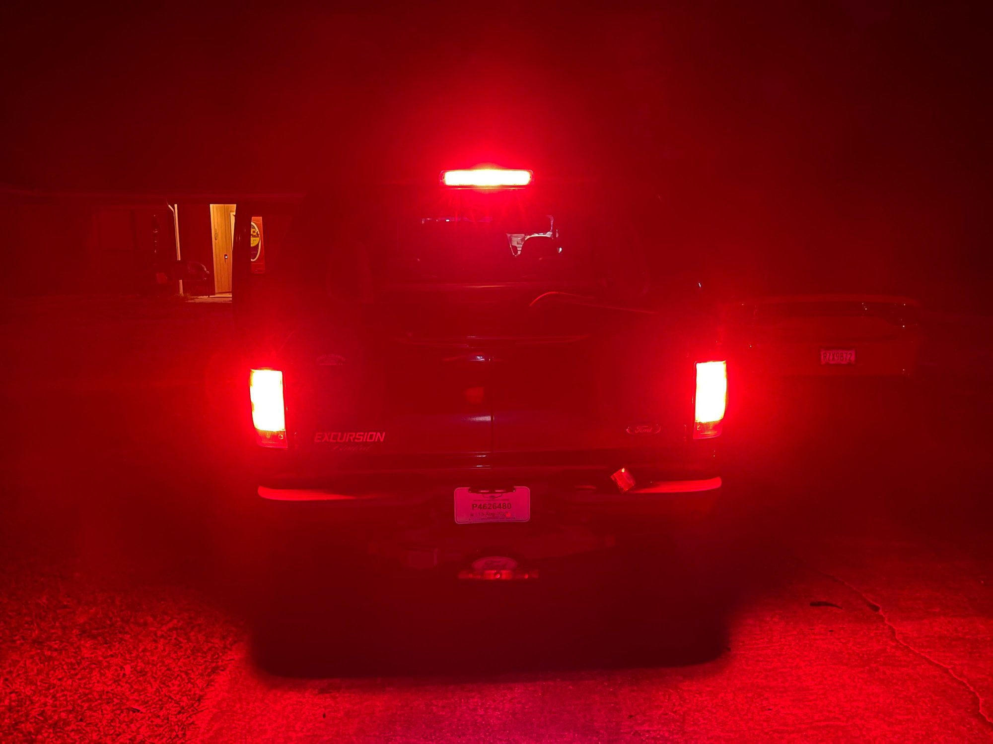

Quad Brakelight mod. Same as always. Drilled a 1" hole. Then used a dremel to fine tune the bulb socket. Spliced the 2 new plugs into factory harness and tested. Can't believe this isn't a factory thing.
also fixed the dome light. the ribbon cable had disentigrated. so I just replaced the whole thing with 2 self contained led assemblies. I think they're marker lighs?...had them for 10yrs. they fit in the cavity perfectly.

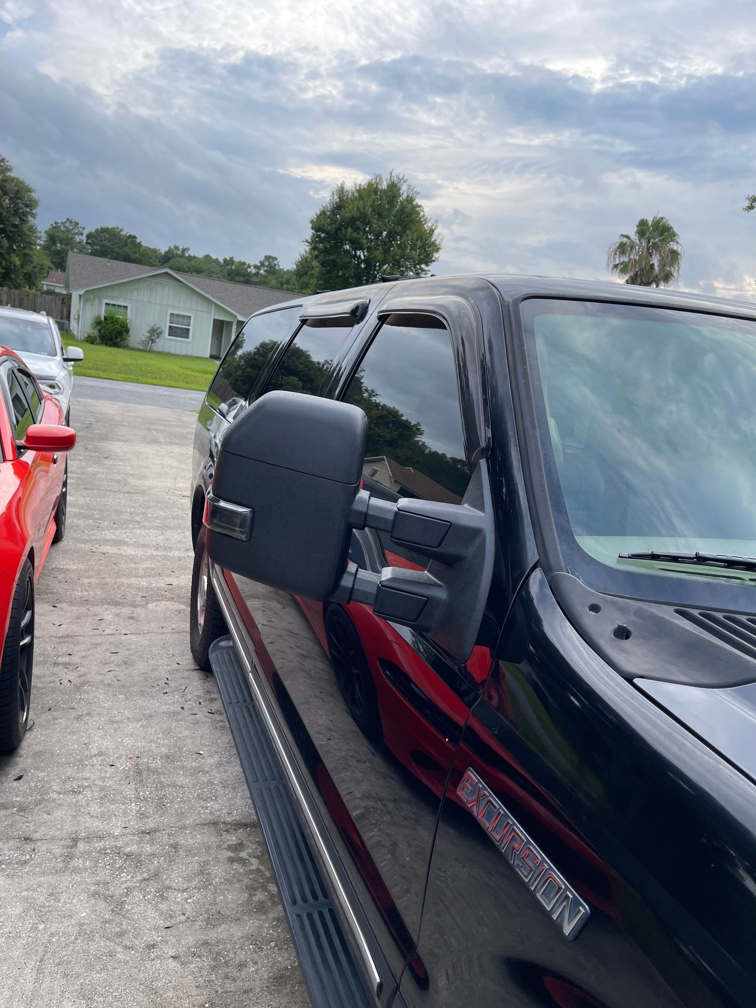

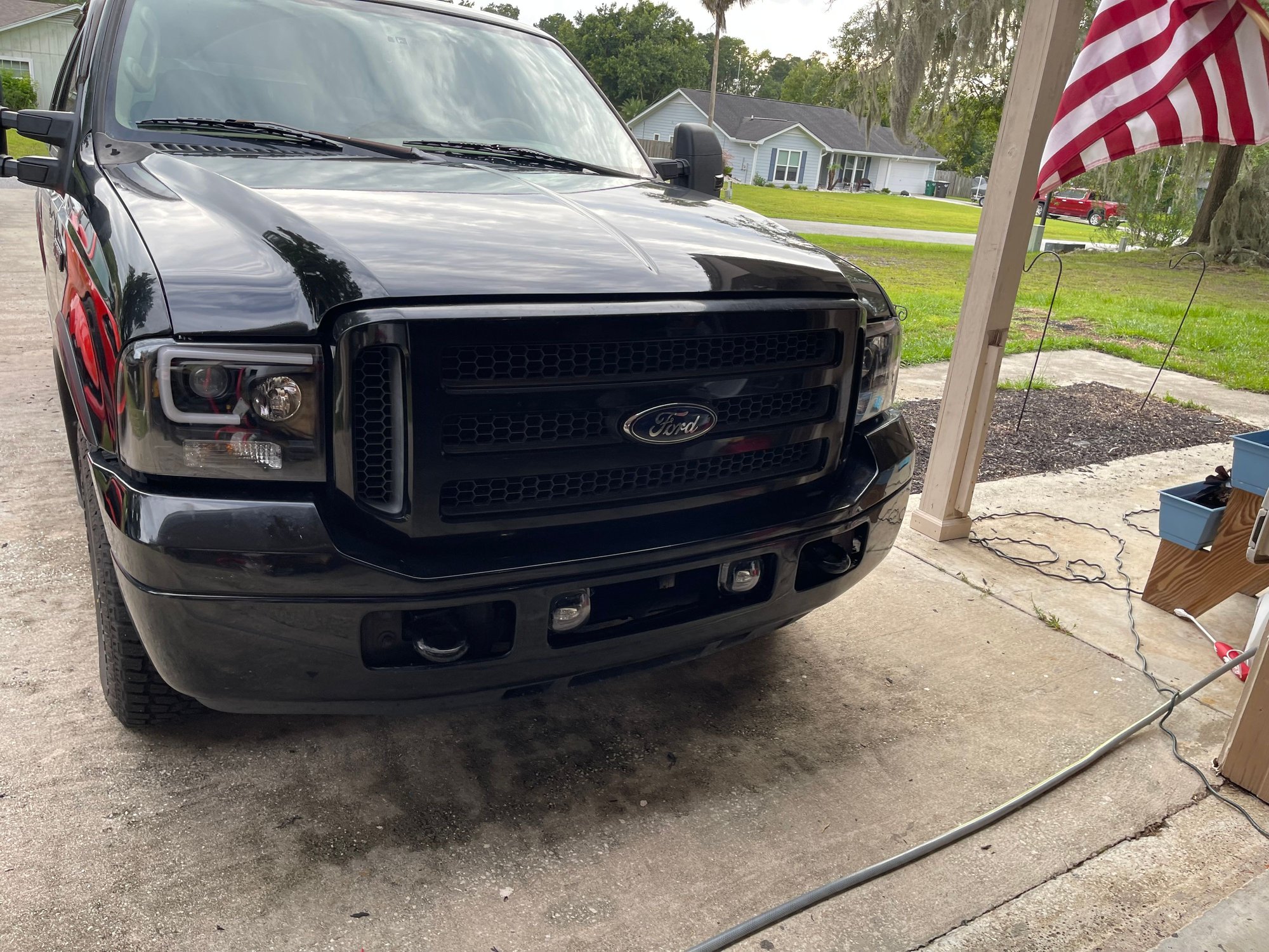

2017+ Style mirrors. They use 99-16 mount pattern. Per usual, had to snip ~1" off a plastic nipple near the apex of the "V". The 99-07 doors don't have a hole that the 08+ do.
LED foglights with running lights and blinker functions.
Headlights with projector lens. at some point I'm going to retrofit a projector for the highbeams as well.
bringing it all together

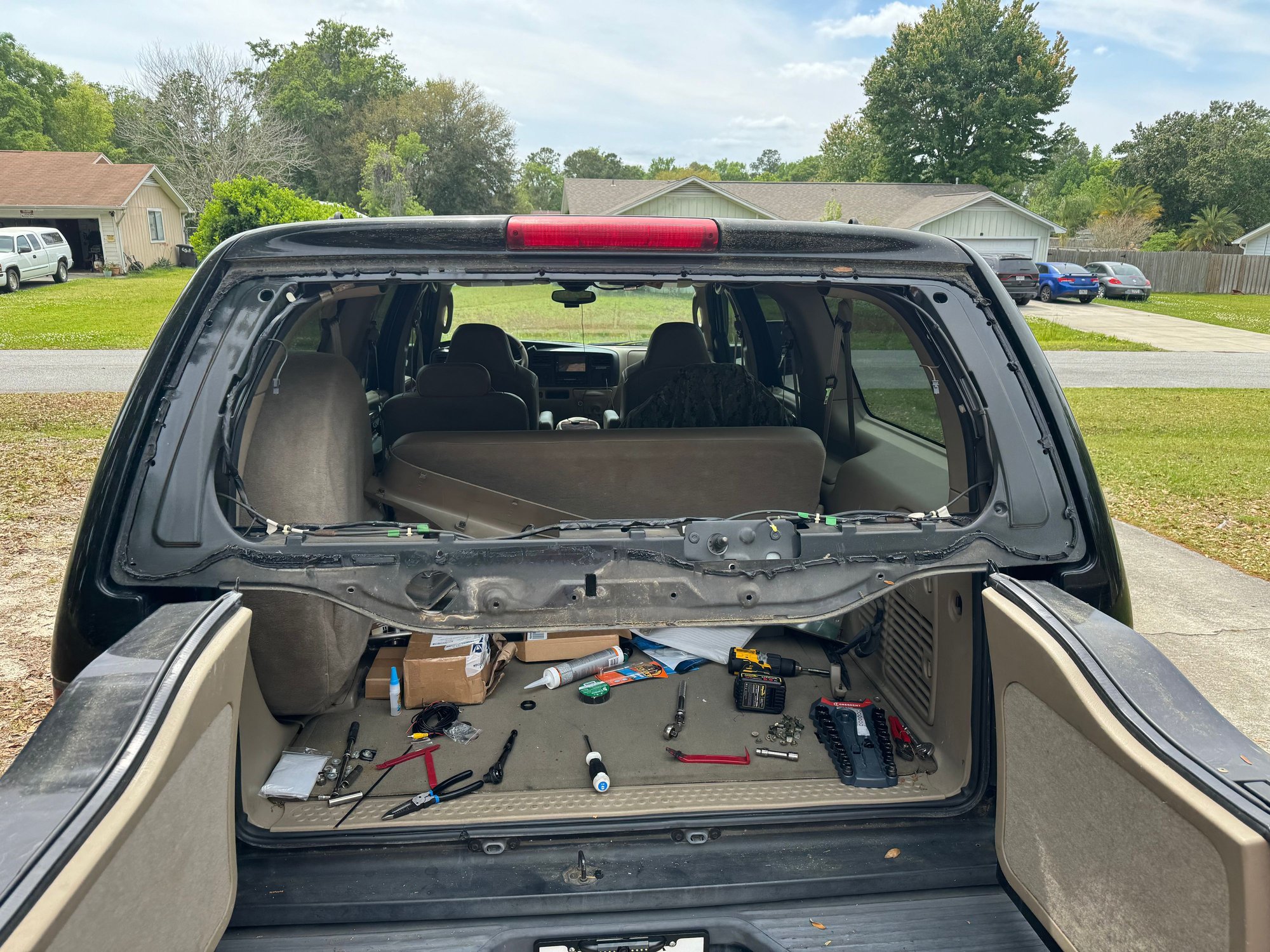

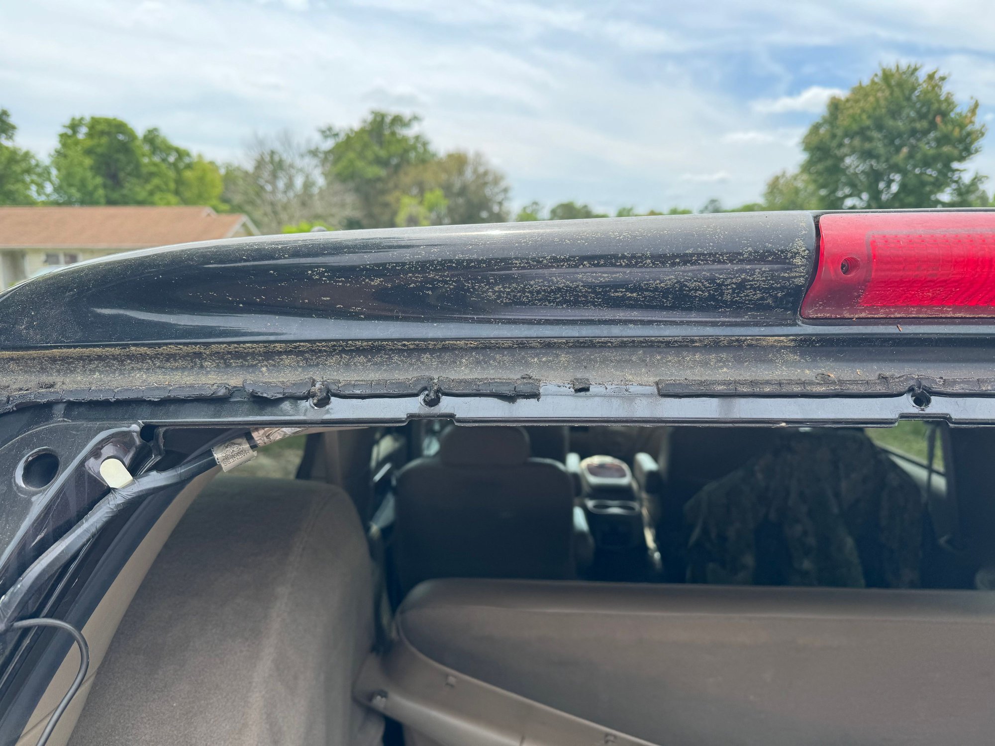

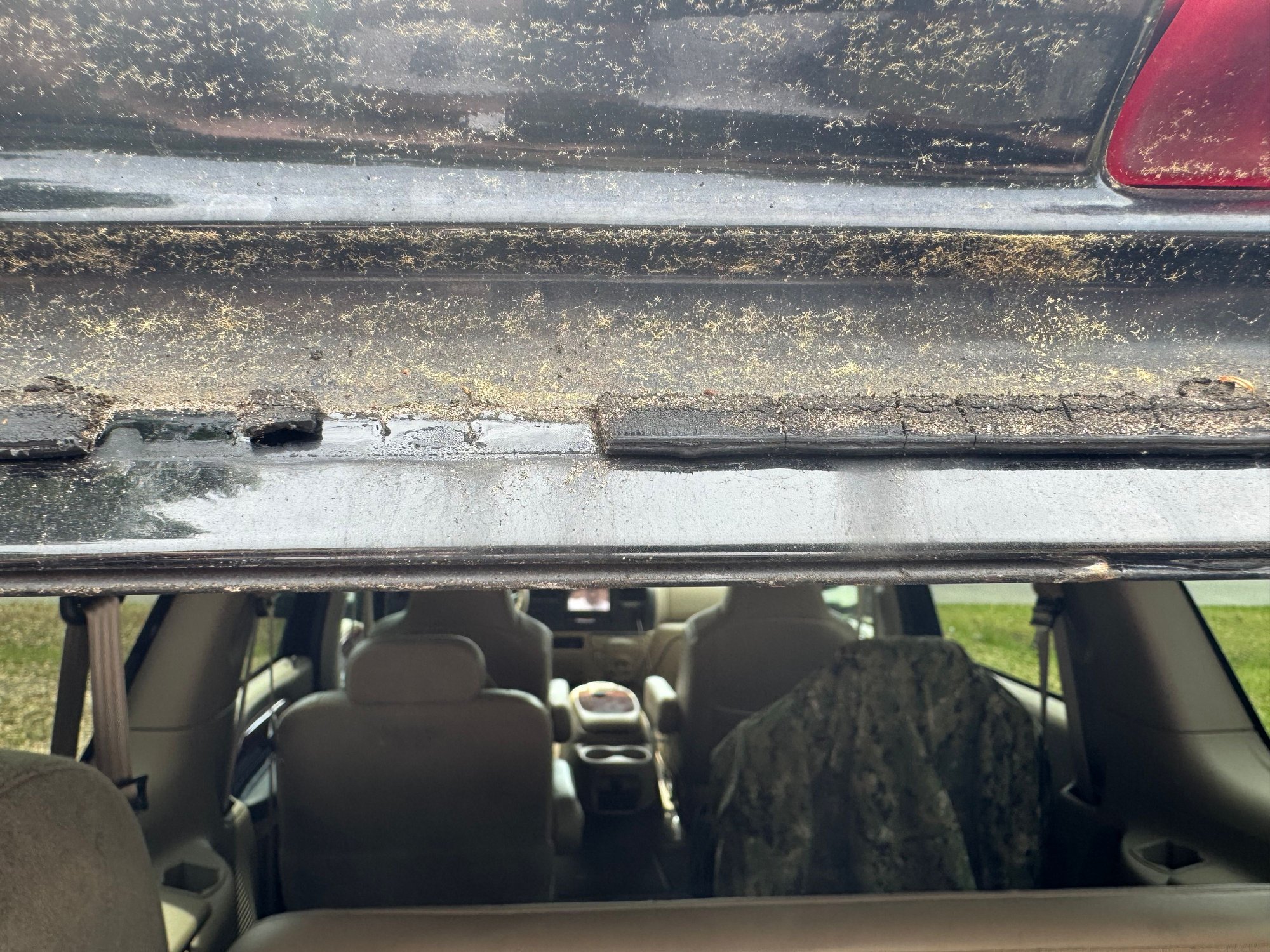

Fixed the rear window leak. The butyl had totally failed. used Nicmike guide and it was fairly painless. about 2.5hrs of my time and $25. I only needed 1 roll of the new butyl
you can see where the failure point was in upper left. what a mess that stuff makes. residue was not fun to clean off my hands

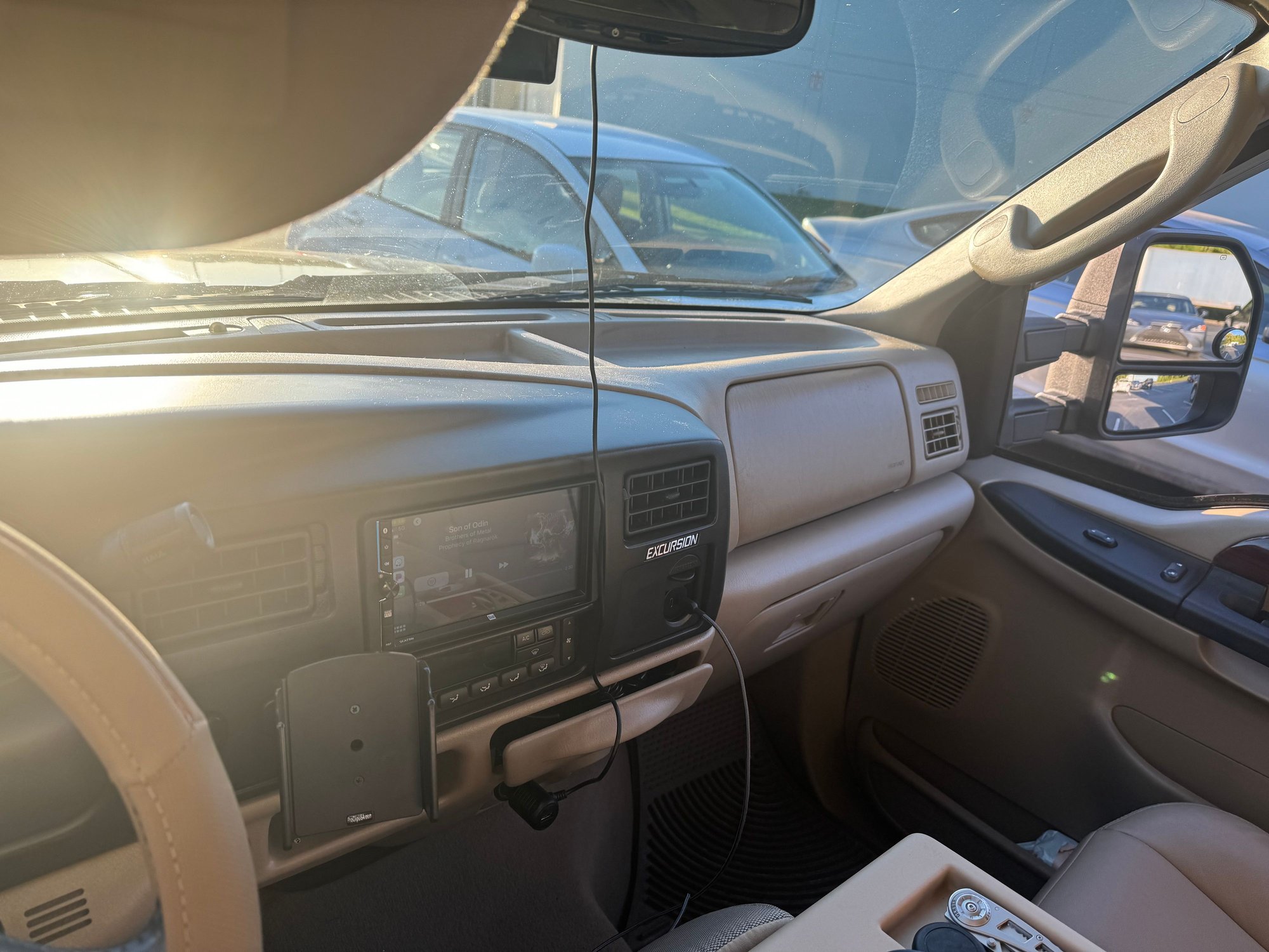

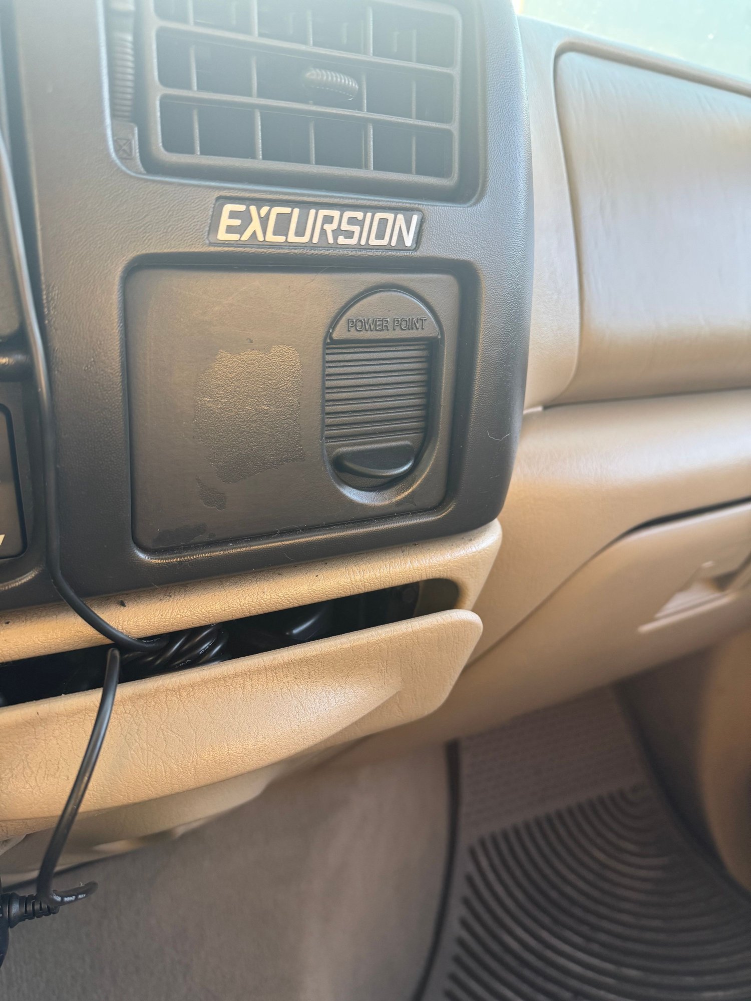

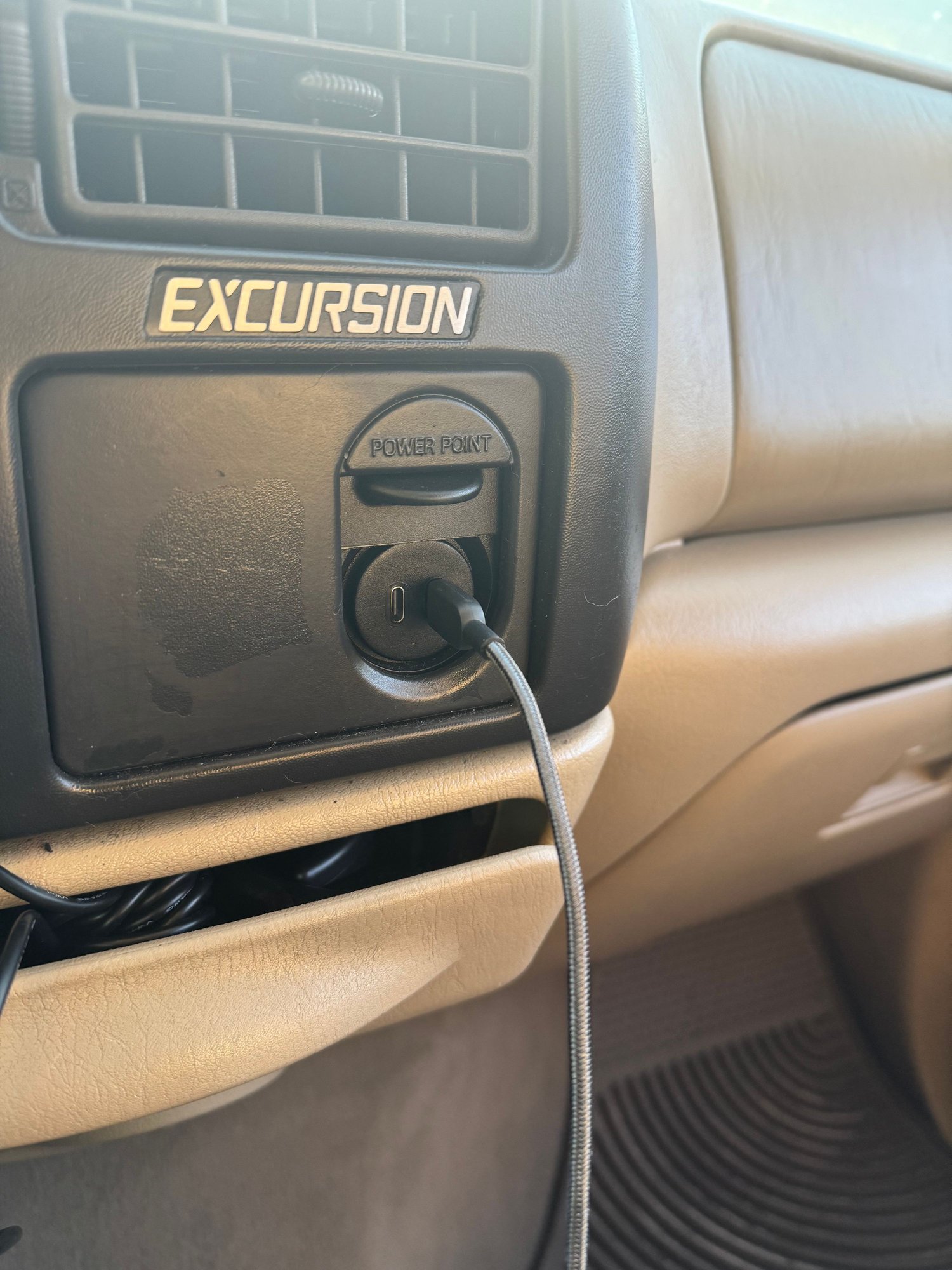

Installed Apple CarPlay (Bluetooth) radio and integrated USB into cigarette lighter position. Looks slick if I say so myself. Radio is nothing special. It works. Priced good. And the Bluetooth Apple Carplay is so nice
and a teaser of an unfinished install . lol

Do you still have use of the SWC?

yeah. There was a circa 2010 Sony touchscreen radio in there. It had been wired for Sirius and had all the bells/whistles. The SWC adapter off it plugged right into the new radio
