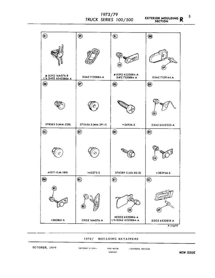

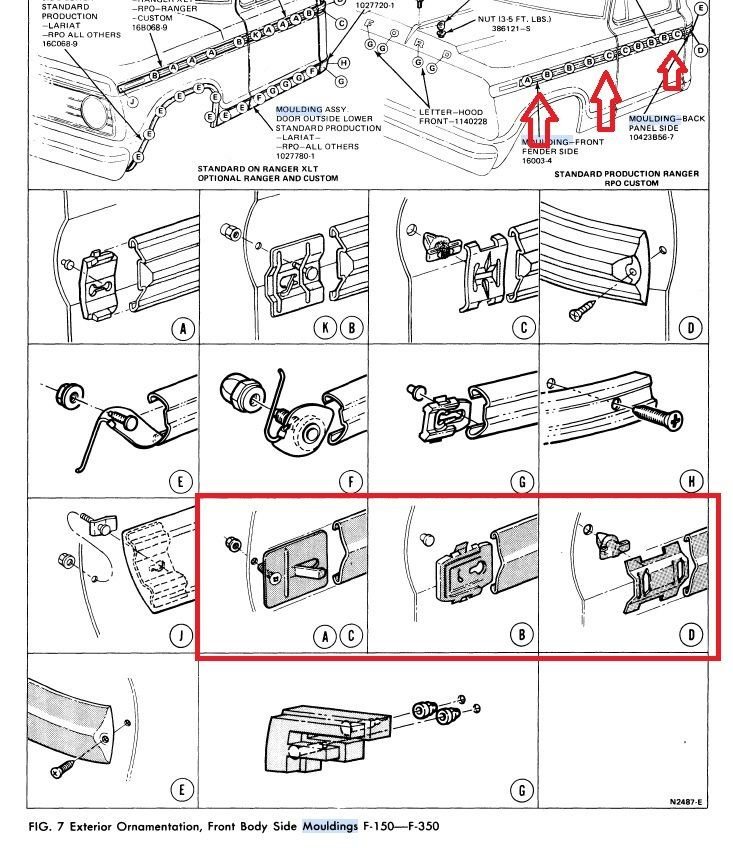

Sorry do not pay no mind to the red arrows and red box. Maybe this will help.
The 2 letters in the box, tells you what connector/trim clip to use where, according to the diagrams below. And the # required.
