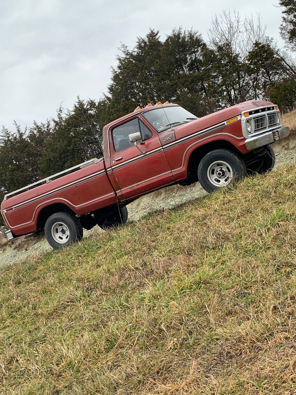

77 f150 351m. The truck starts right up when cold and has no problems while driving but after shutting it off for a little while it floods sometimes but not all the time. I can hold the pedal to the floor and it’ll start up after a few cranks and runs fine. Sometimes it’s flooded after just a few minutes and sometimes it isn’t. It has a knockoff of a motorcraft 2 bbl carb (not sure of brand). Has anyone had this problem? Anyone have any suggestions?
