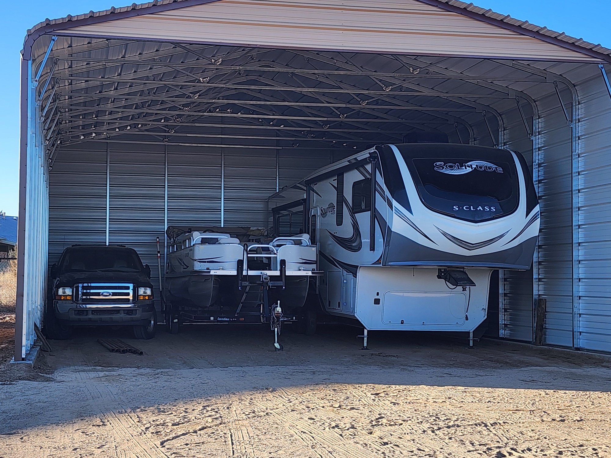

My new rv barn doesn't have power, when I went to hook it up today there wasn't enough battery to raise the Jack's and it was so low my 19 f450 wouldn't even charge it. I had to fire up my generator and charge the battery. Apparently my 2 year old battery is not healthy. I had shut the big red switch off when I parked it a month ago.
so my question is what should I buy and mount to my rv barn to keep the battery topped off?
