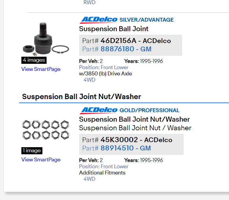

Thanks everyone. Went to oreileys ended up finding one listed as a 2wheel drive joint but it’s the exact same as my old one. I’m going to try to cross reference the part number to get a set of moogs or xrf.

In response to JJF's earlier post, I wonder if these Dana ball joints could be a potential consideration (same part number in different website links)?
Dana BALL JOINT KIT - DANA 50 700238-2X | Zoro
