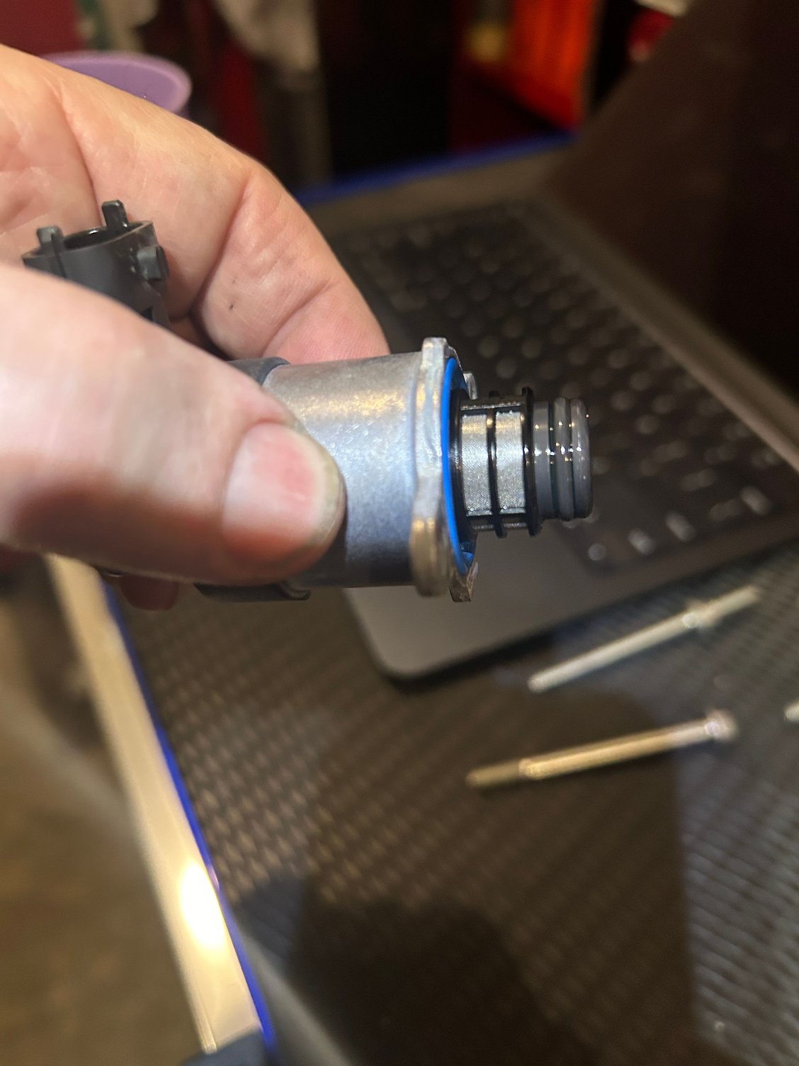

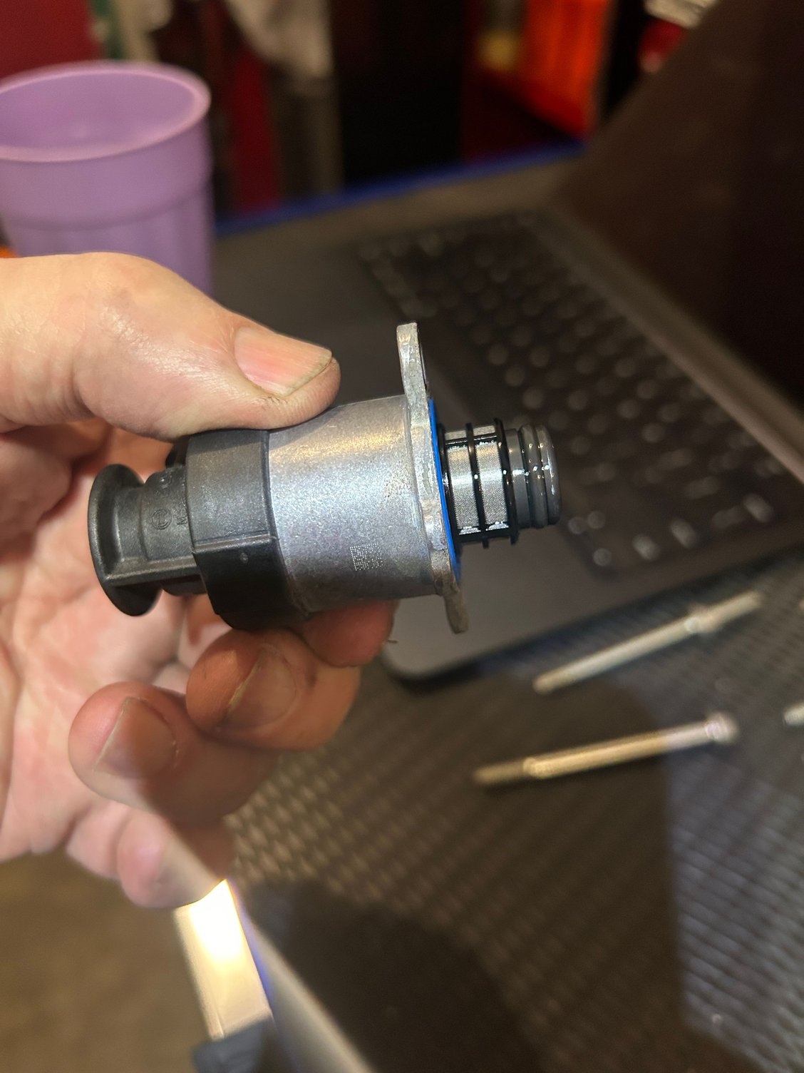

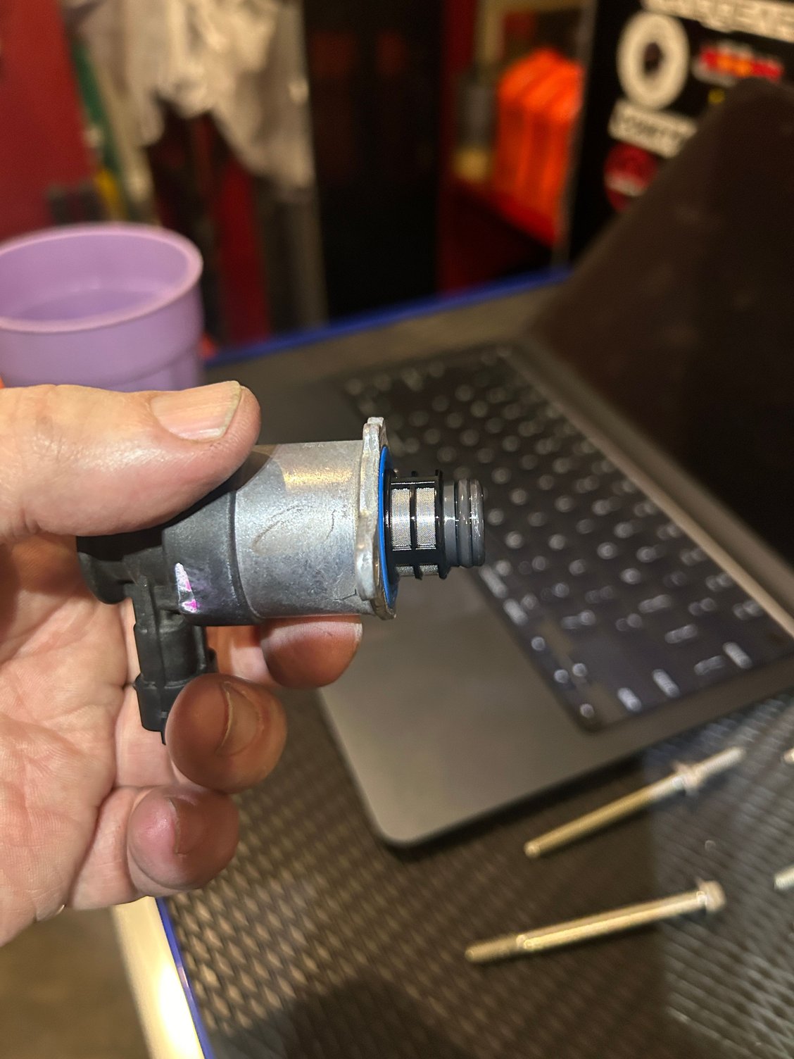

Ok, tear down to FCV is complete, photos below, one for each of the 4 sides. I see zero visible buildup of anything on any part of the mesh screens or anywhere else on the FCV or down in the pump body. I'm leaning towards just doing the DCR conversion and keeping the CP4 and all the OEM parts in case hard times arise and I need to keep the truck running.
