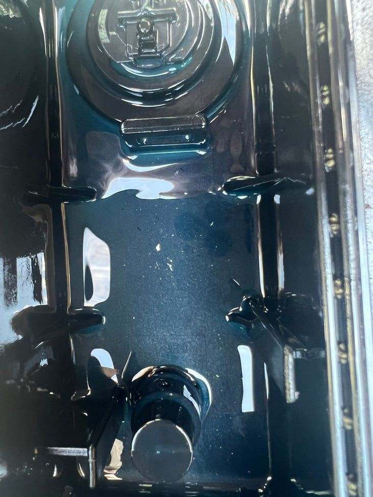

Time for DPK or DCR? Those little flakes feel metallic, not magnetic. Truck has 55k miles.

I don't believe these amount of particles is a result of a pump failure.

Glitter is found on the FVCV and is silver in color. That just looks like dirty fuel. Do you have a DPK installed?

Ok, but then I saw this. See the 10 seconds following time hack 1:36:

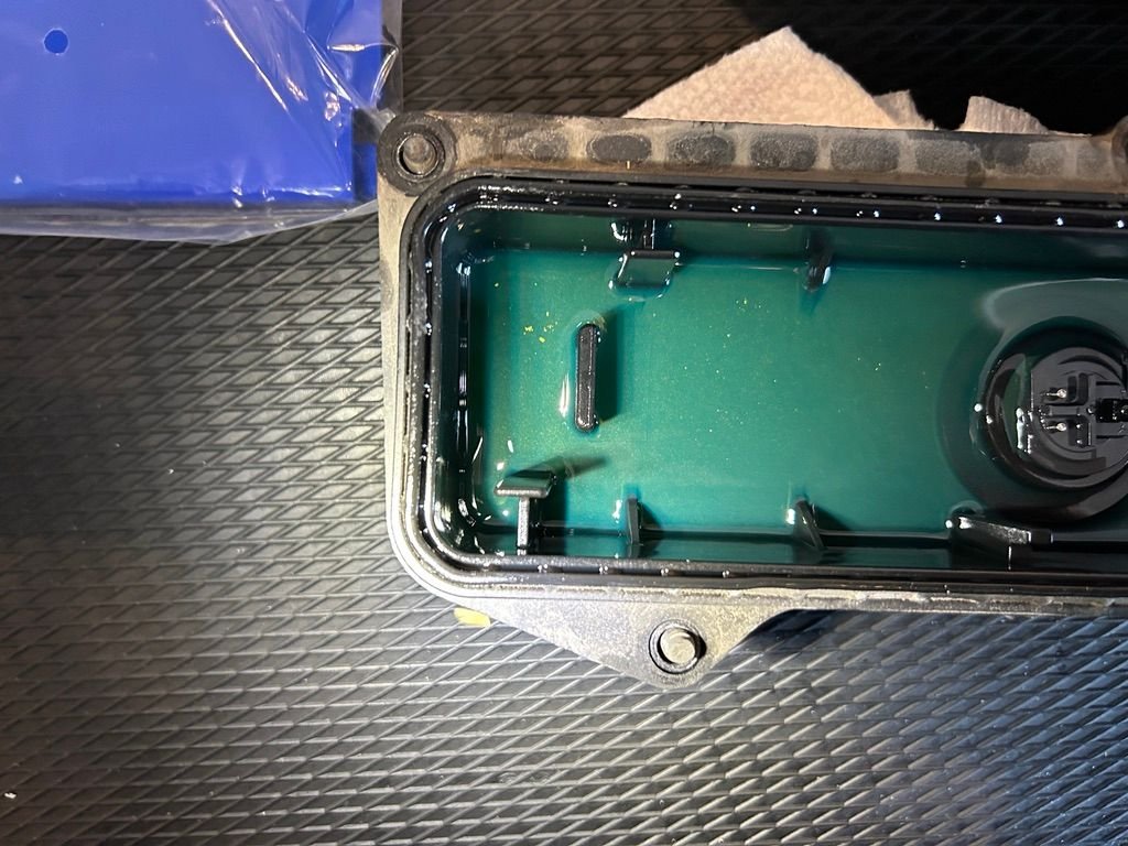

Those flakes look a lot like what I saw in the bottom of my under bed fuel filter reservoir I took a photo of.
No DPK yet. Also see video @ link above in response to FishOnOne's reply.

^^^ Above is the only way to confirm if the metal is from the CP4 or from some other source (ie. crude in fuel, wear of the pump at the fuel station, etc). That said getting a DPK on there is never a bad idea.

Thanks! I have a Banks iDash and will check this out today when I start and drive the truck for the first time since the fuel filter and oil/filter change I did when I discovered the specks of whatever in the photo I posted.

If these numbers look "normal" I will do a short drive. I'm going to tear down to point of installing the DPK and check the FCV for any debris. Then decide at that point if I will install DPK or if debris is found I will install the DCR and do the entire fuel system swap including the tank BS.

If this is the first time the filter has been changed, it is probably normal
https://www.ford-trucks.com/forums/1...l#post20903880
Been there, done that. From what I understand of the fuel system, the fuel is drawn through the filter from the tank, even though the pump is IN the tank, is still draws like the early models so the pump has filtered fuel going through it instead of drawing crap from the bottom. The fuel enters from the tank and runs outside of the filter, gets pulled through the media, then pumped to the secondary before being returned. I think it actually will pass through that filter housing twice to remove water. I saw the same thing, (see above thread link) when I replaced my filter. I believe it is construction crap left in the tank from manufacturing.
If the CP4 is failing there would be a light coating of metal particles all over the housing and filter.
