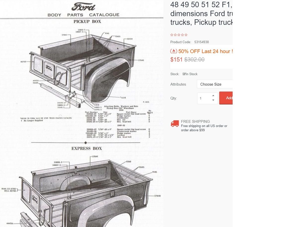

I found this and still confused...someone educate me. What is the difference between a pick up box and express box? The express box below looks like the 48-50 and the pick up box looks like the 51-52. The express box below looks to be a long bed. Also, notice the on the pick up box...there are pockets in the rear but not the front. (maybe this explains why mtflat's front pockets were cut out later??) Also hard to tell, but the express box stake pocket cut outs seem to be completely cut out so there is no tab to be "bent inwards" into the hole.
apologies for my OCD !!
Old Mar 22, 2024 | 12:35 PM
52 Merc's Avatar
52 Merc
Joined: Oct 2009
Posts: 16,194
Likes: 4,805
From: Burbank, WA
Yeah, you're way overthinking this. The pickup boxes had a stake pocket on all 4 corners. The lazy artist there just didn't draw a hole. It's there in real life. The Express bed was Ford's name for the long, 8' bed used on the F2/3 Express trucks.
