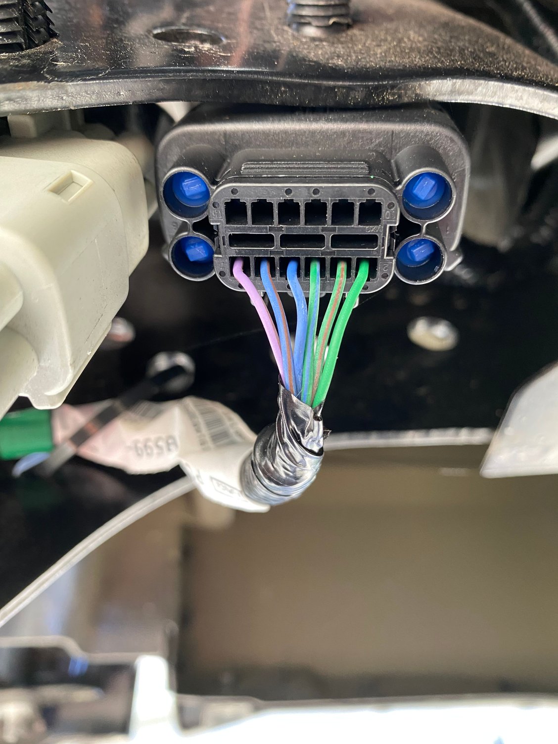

My 2024 Lariat Ultimate CCSB came with a Tailgate Delete Cap Kit PC3T 15A562 GB4WA. FYI it’s been determined these kits are missing some wiring pins on the large jumper harness, which grounds the tailgate ajar sensors.

Wow, so no tailgate ajar warning? If not, could you post a pic of the black end connector wires, on that large jumper harness? Mine looks like the pic below. Perhaps a shot if the Ford part number on that jumper, would be super helpful!!
Thanks for your assistance.

did you figure this out ? The harness that came with my 2024 f350 does not work , I keep getting the tailgate ajar warning ⚠️
Check out this thread on the Tremor forum. The issue is the Ford tailgate delete wiring harness is missing some grounding connection's. There are a bunch of pics and links to premade wiring pins to solution. It’s pretty easy.
https://www.fordtremor.com/threads/2....18096/page-14
