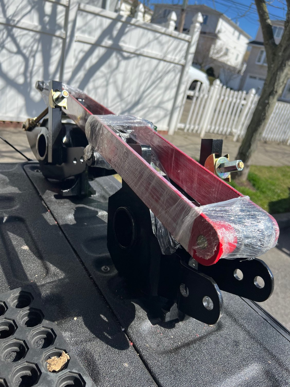

Sulastic HD install

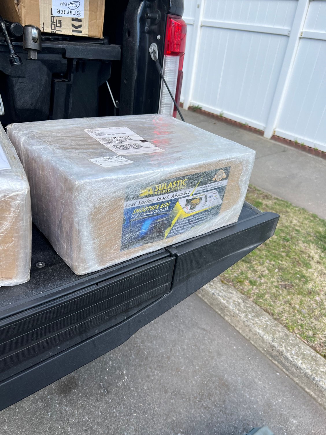

working my way down the bought but never installed list
Bought these sep/21
not sure if I’ll finish today but unboxing to decide if I’ll start today or tomorrow

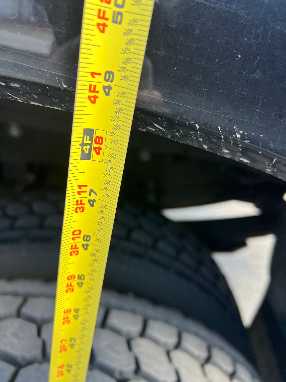

Measuring height…to figure out if there is a height change.
im going to call this 48 1/4
my rear has 5” lift block
i I have a 4” I want to put in ….assuming height change is minimal from sulastic’s. Gail is to go from 5” to 4” …but don’t know what the sulastics will do

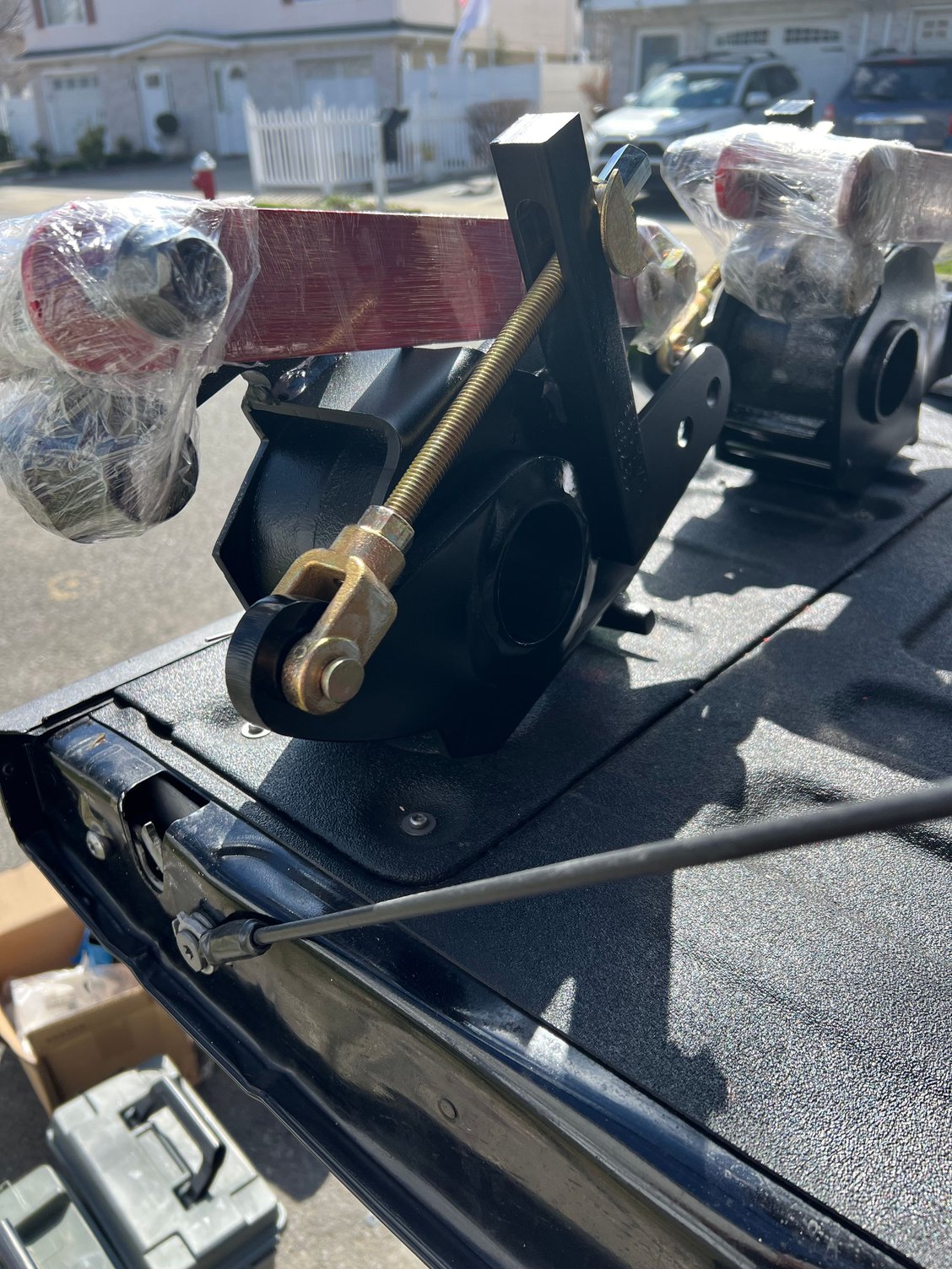

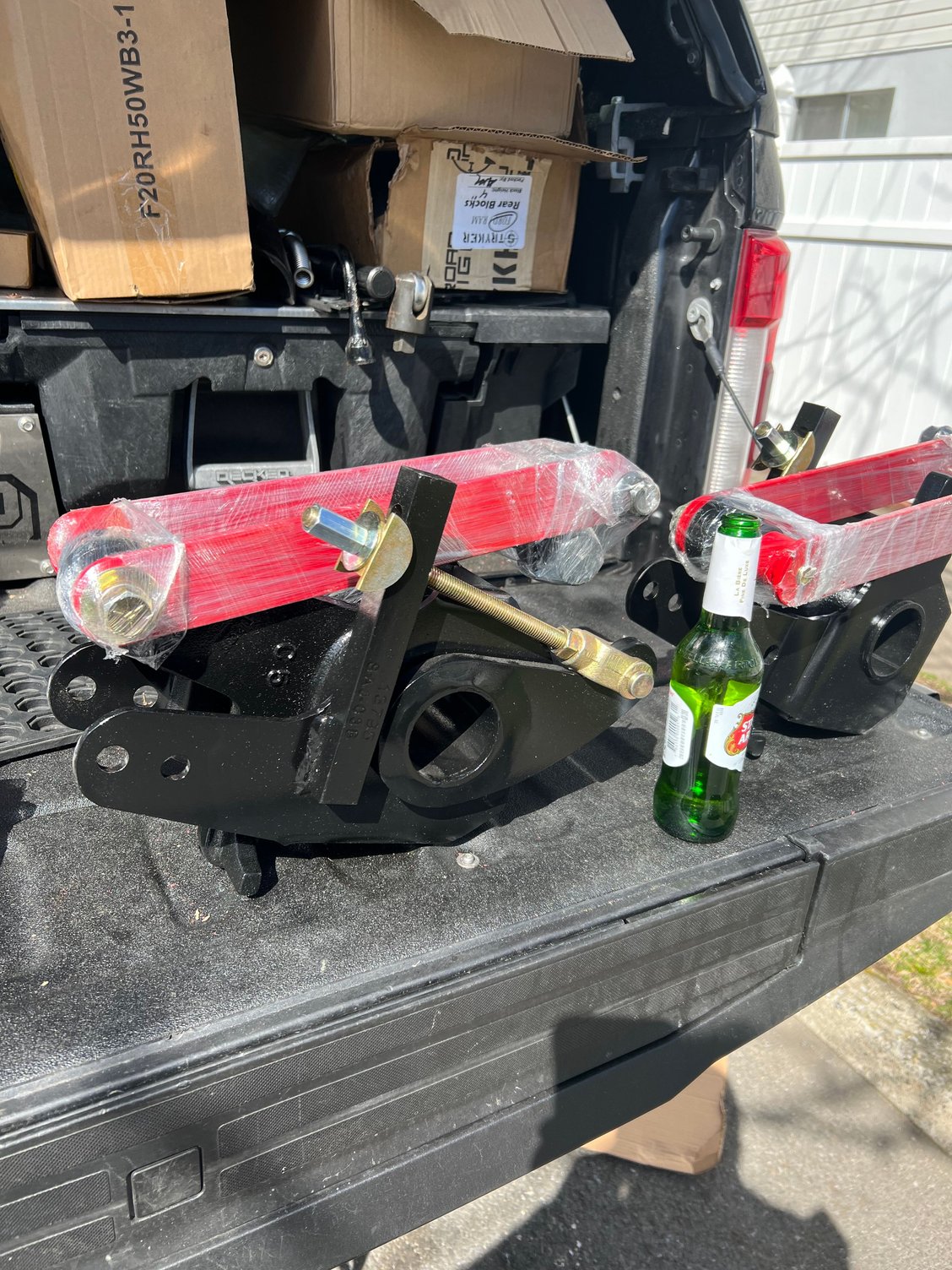

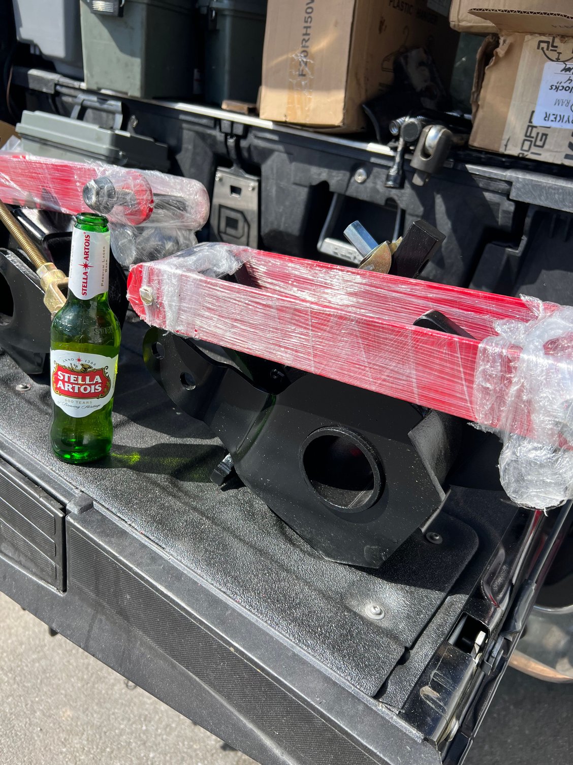

These are the HD version
there is a lever you throw if you are going to tow. The regular versions don’t have the lever.
these are big and heavy…not sure if this is a 2 person job. We will soon find out.
beer is for size reference

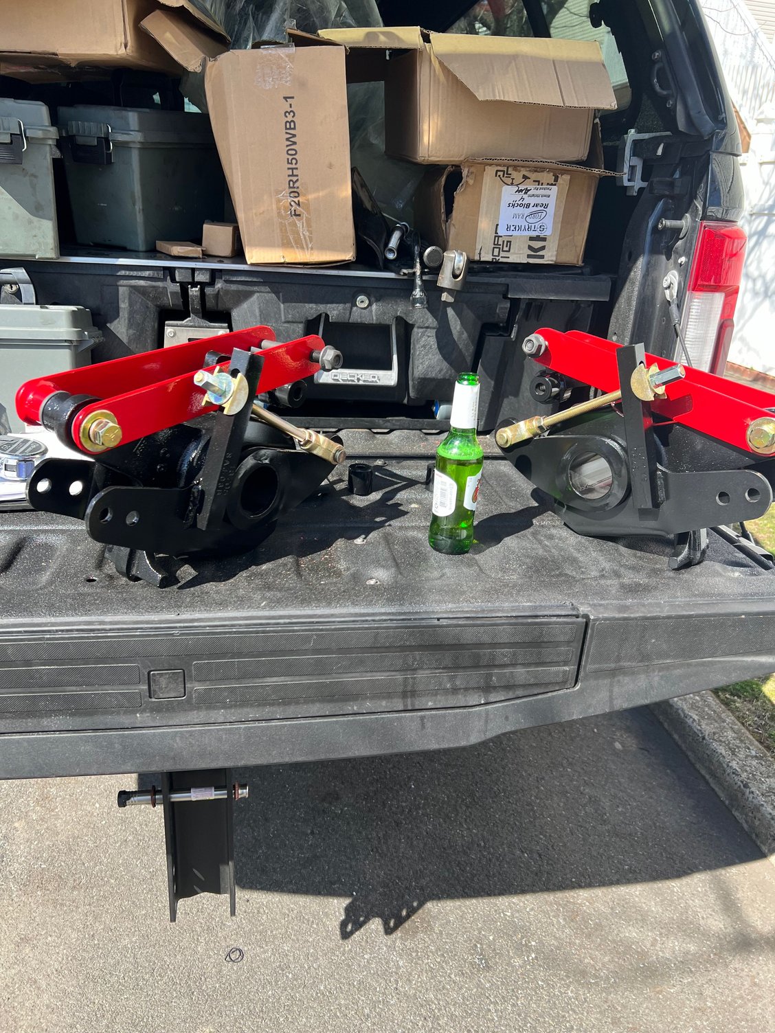

Instructions sheet says…
we don’t have instructions for your vehicle
just take off stock hangers and damper
and put these on.
there are a few pages about how to adjust
moving on.

No markings as to which is L or R

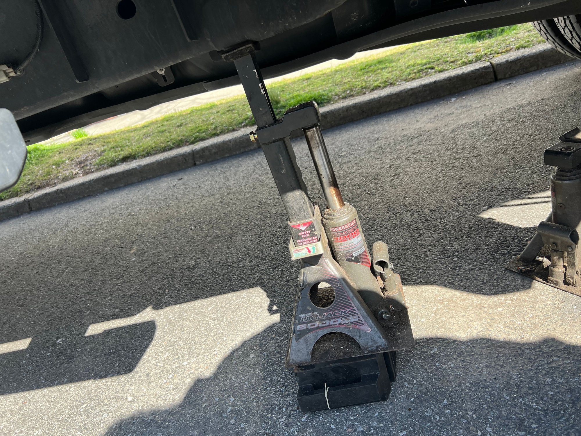

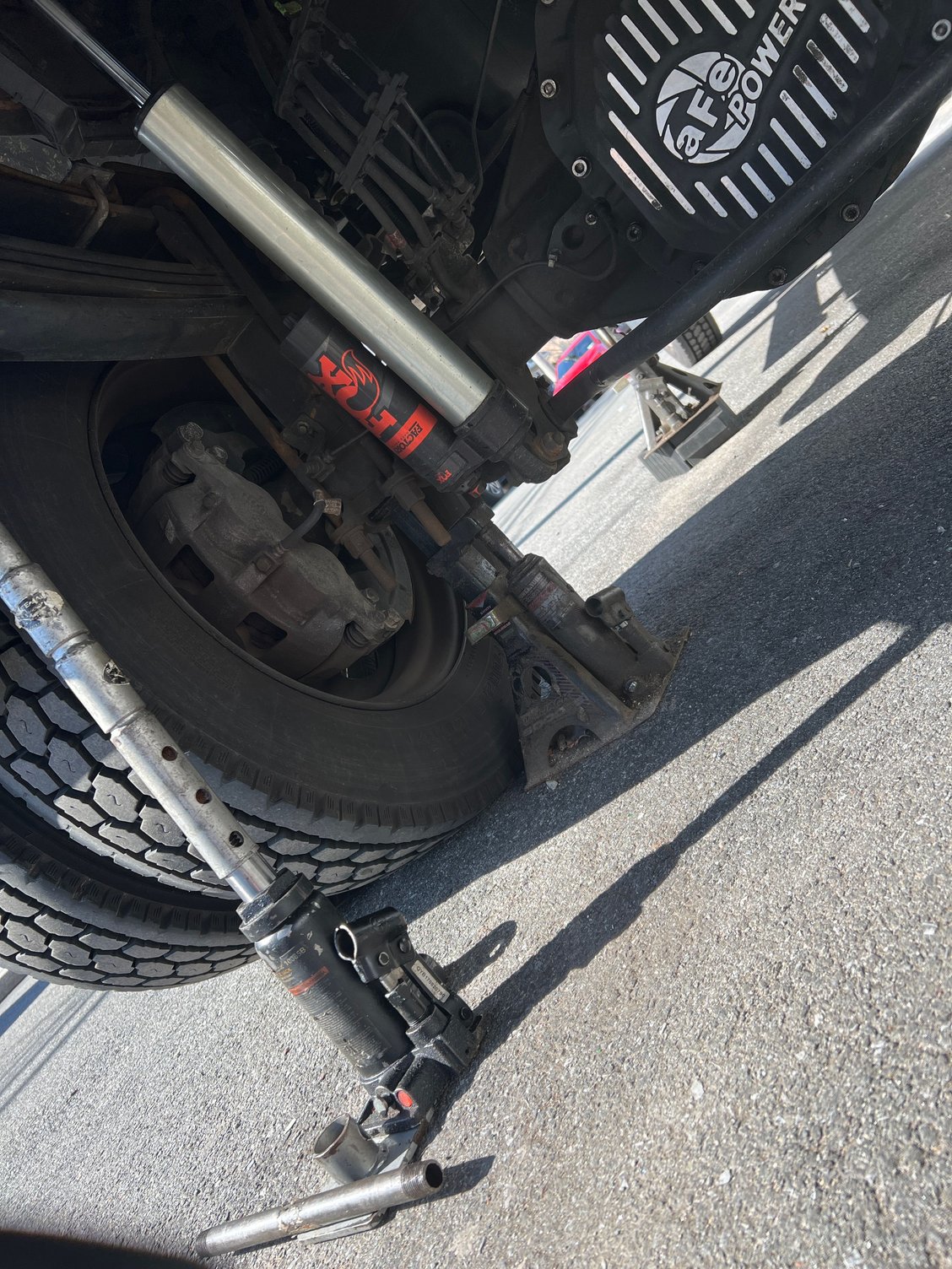

Plan is to use 4 jacks
2 on frame
2 on axle

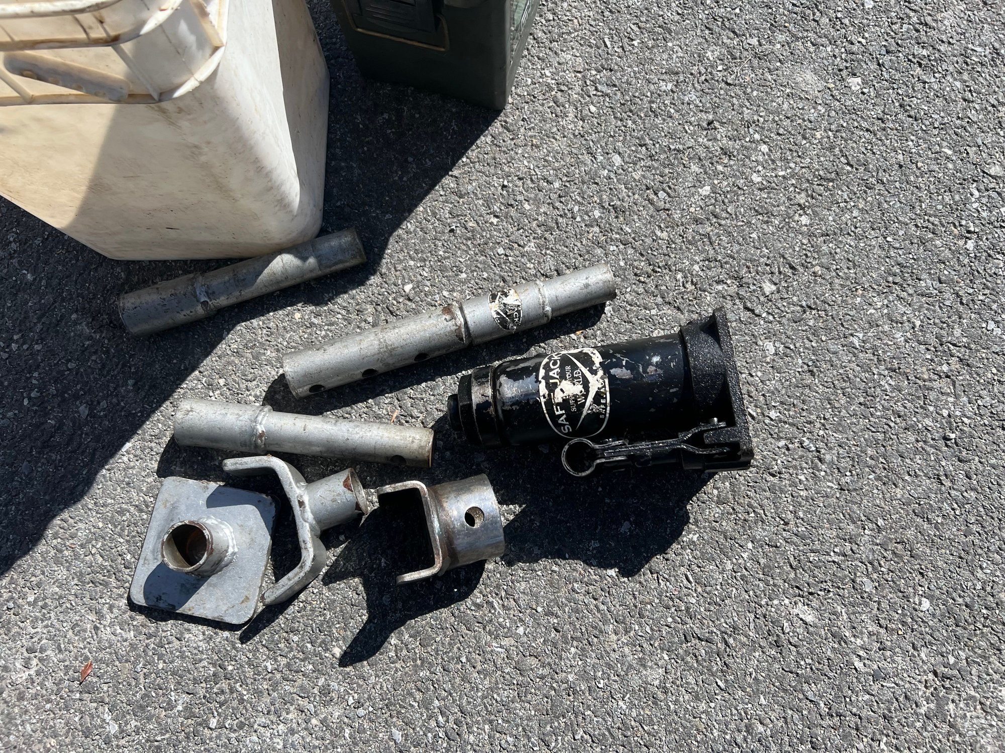

I also have this hack which I will use to replicate leaf springs

there are two sizes
regular
HD
a lot of folks try to use the regular version on trucks that tow slow…they wind up breaking the sulastics…if you tow a lot you need the HD version.

All supported

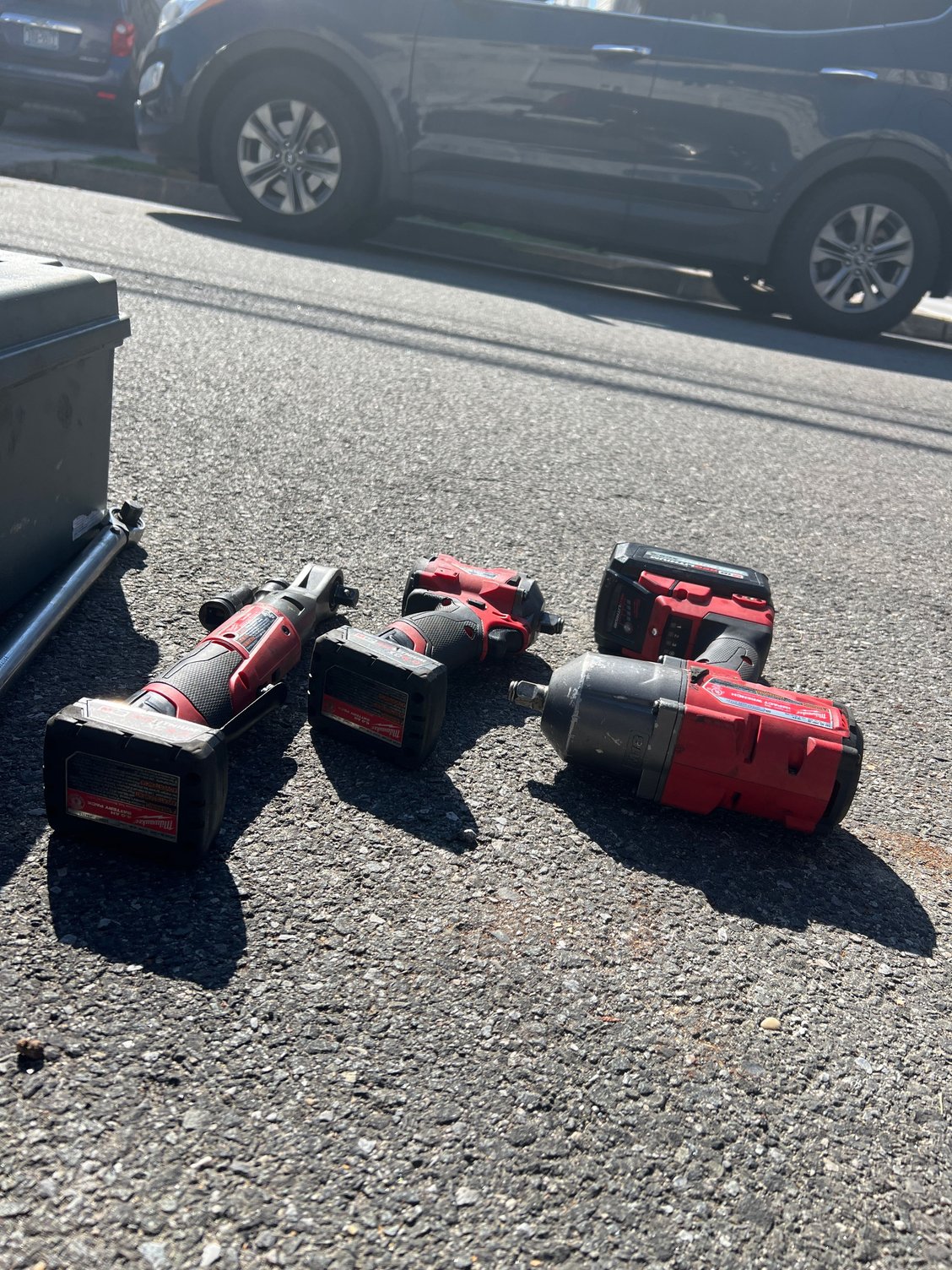

Let’s see if I can breaker bar it he damper and hanger loose then use power tools

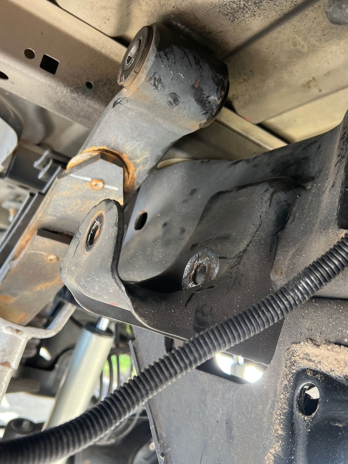

Now trying the leaf hanger

hanger is out
