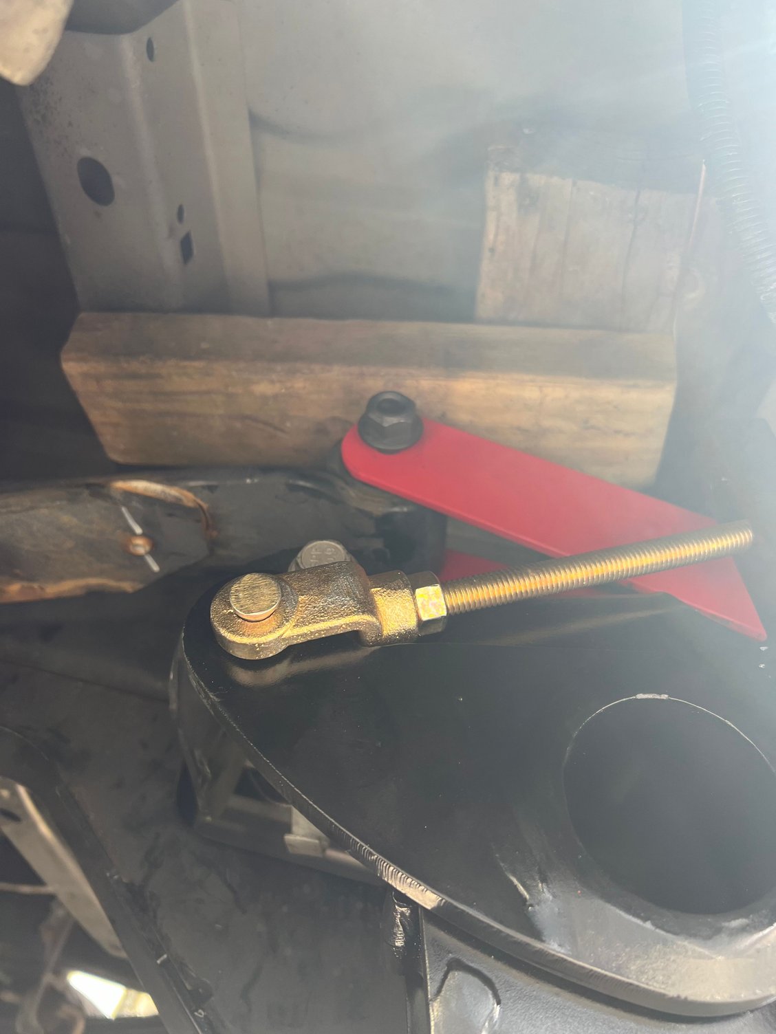

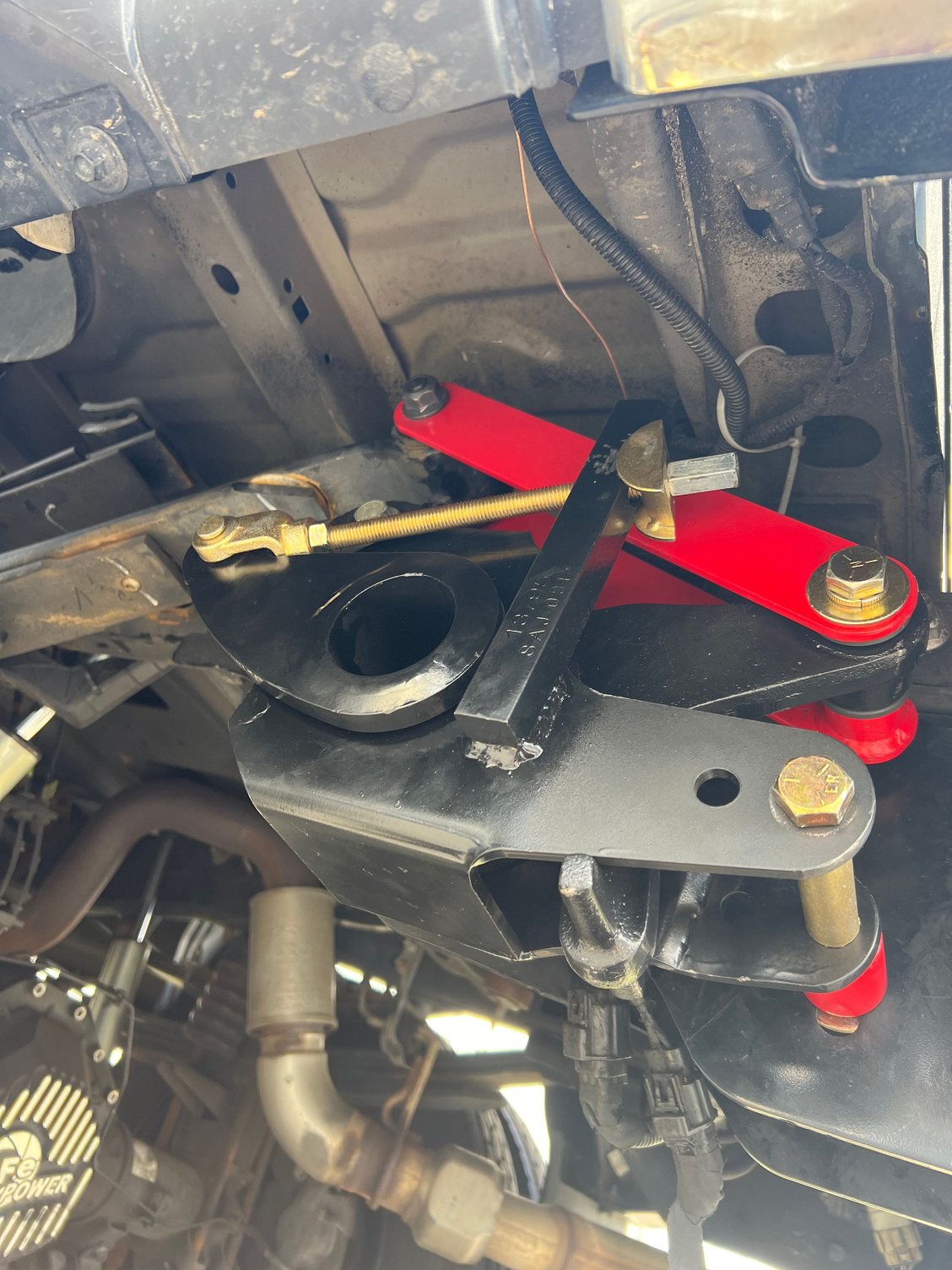

So with the updated install instructions in hand…started round 2.
the major difference with the new install instructions is using some wood as a spacer along with jacks to compress the leaf springs so that the red bar holes line up.

you can see the wood blocks here

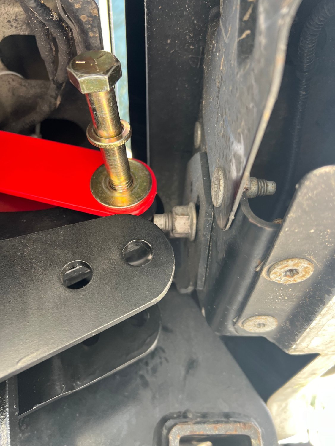

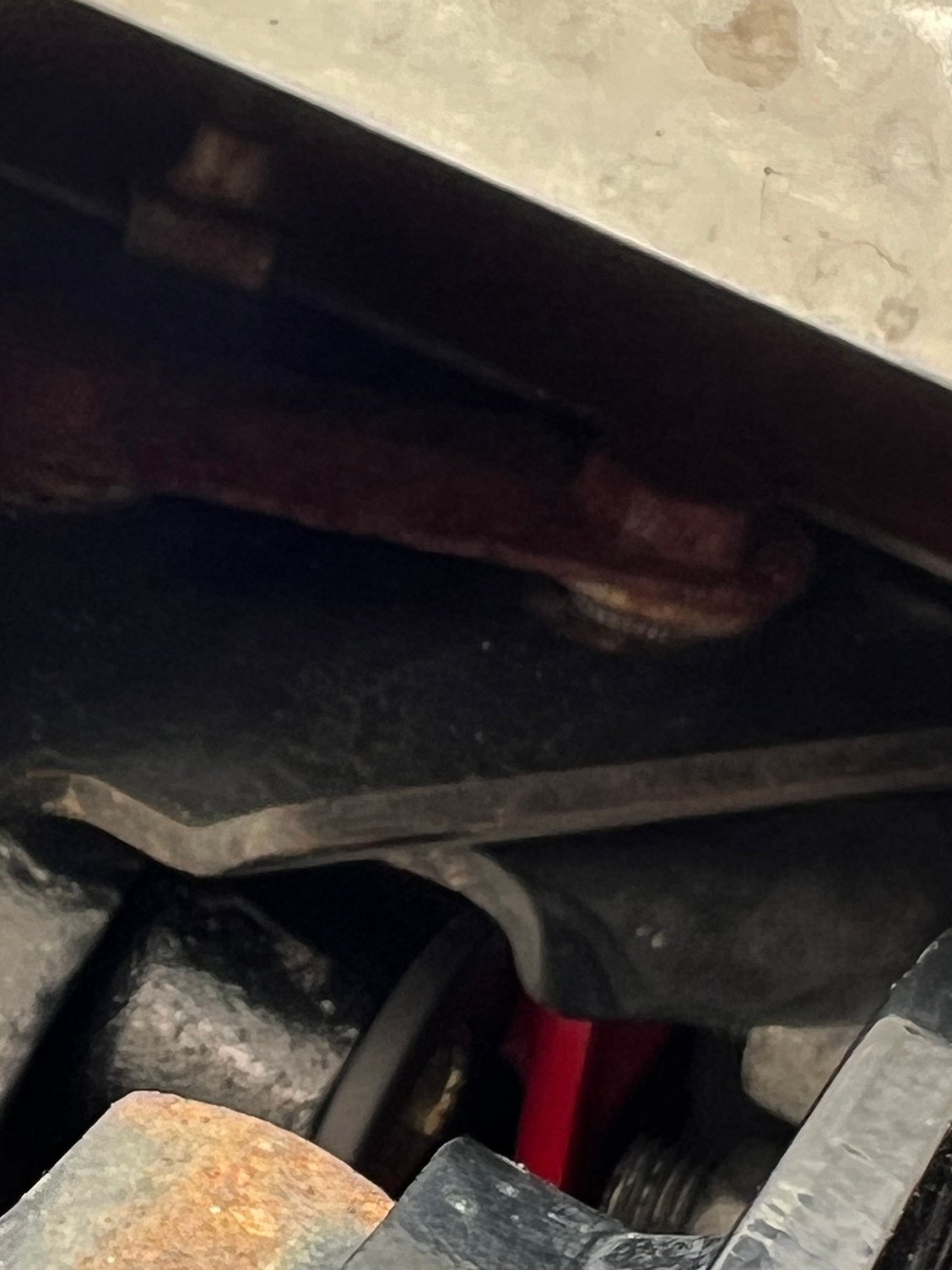

this is the deal breaker bolt that has to be lined up by playing with the jacks once you have the wood blocks lined up

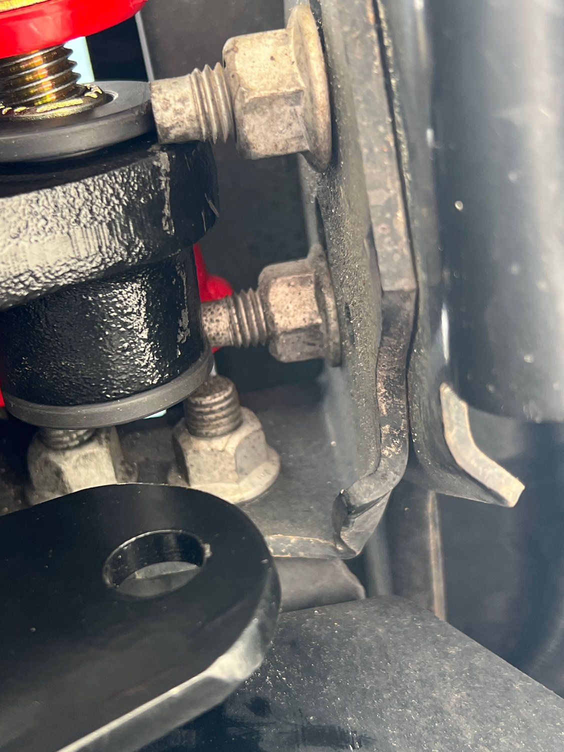

there were some bolt ends and nuts in the way.
Old Mar 17, 2024 | 01:20 PM
speakerfritz's Avatar
speakerfritz
Joined: Jul 2013
Posts: 14,301
Likes: 2,197
it looks like I can reverse the bolts / nuts

did t ha e to reverse the bolts/nuts
once i removed the nuts, the bolts pushed out of the way.
install complete on 1 side.
2.5 hours to get drivers side done.
Next is pax side.

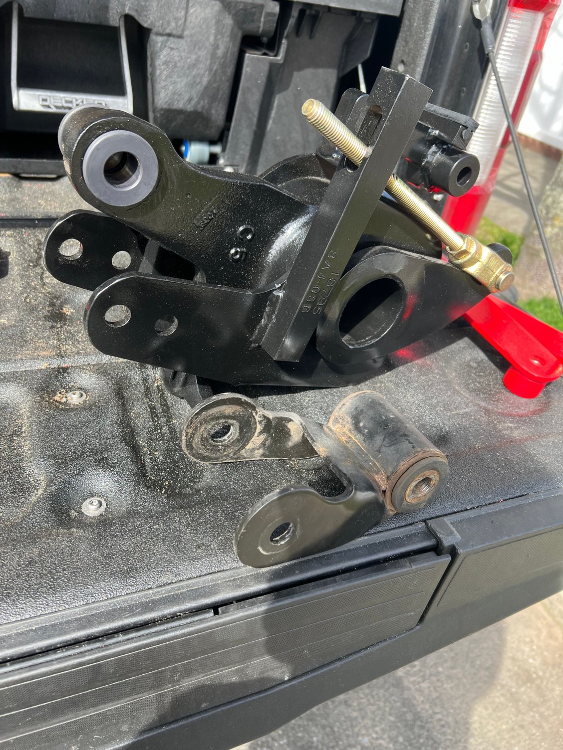

here is a side by side between new HD sulastics and stock hanger.

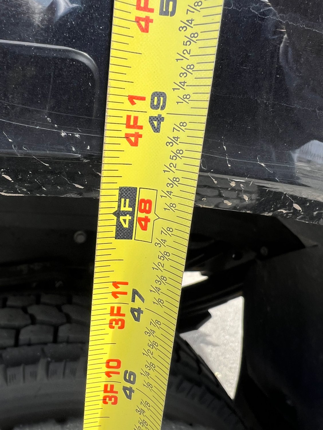

looks like I lost 1/4” on height.
not a problem since from is 3.5 and rears are 5. So when I put the new 4” block in I’ll be almost level ( 3/4 higher in back)
