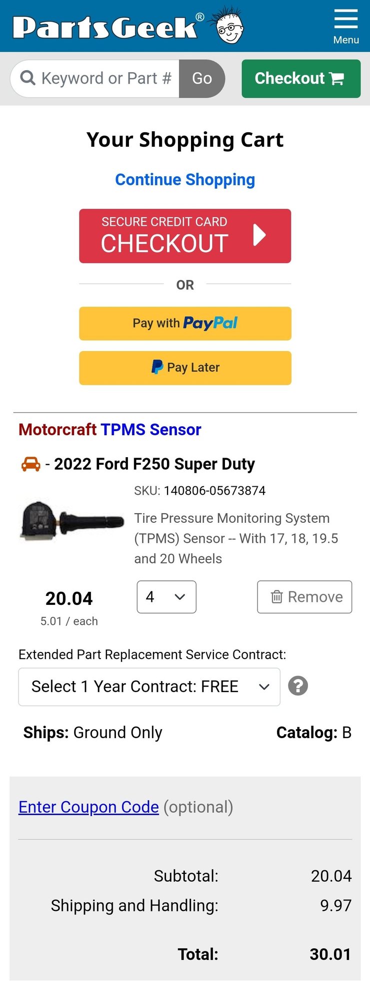

Search partsgeek.com and they have sensors for your truck for $5.01 each.
