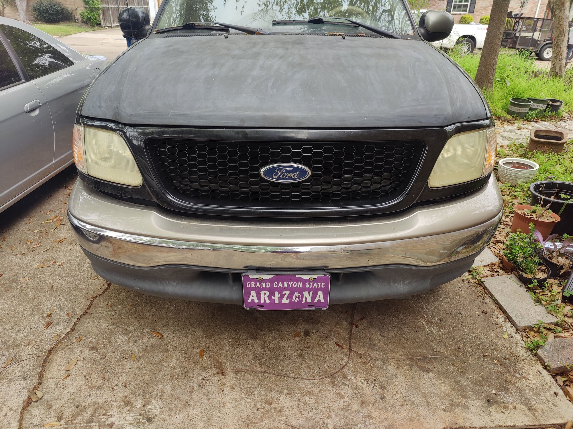

Here is mine before I swapped in the headlights (sides already done). It was Rust-Oleum stuff for trim and bumpers. Did self etch primer first and two cans of the trim/bumper paint.

Looks nice. Did you remove it to paint it, or tape around it?

Thanks! Removed, prob took about 15 min after farting around with it slowly. Ford badge came off easily.
Just washed with Dawn a few times and rattle can time once dry.
