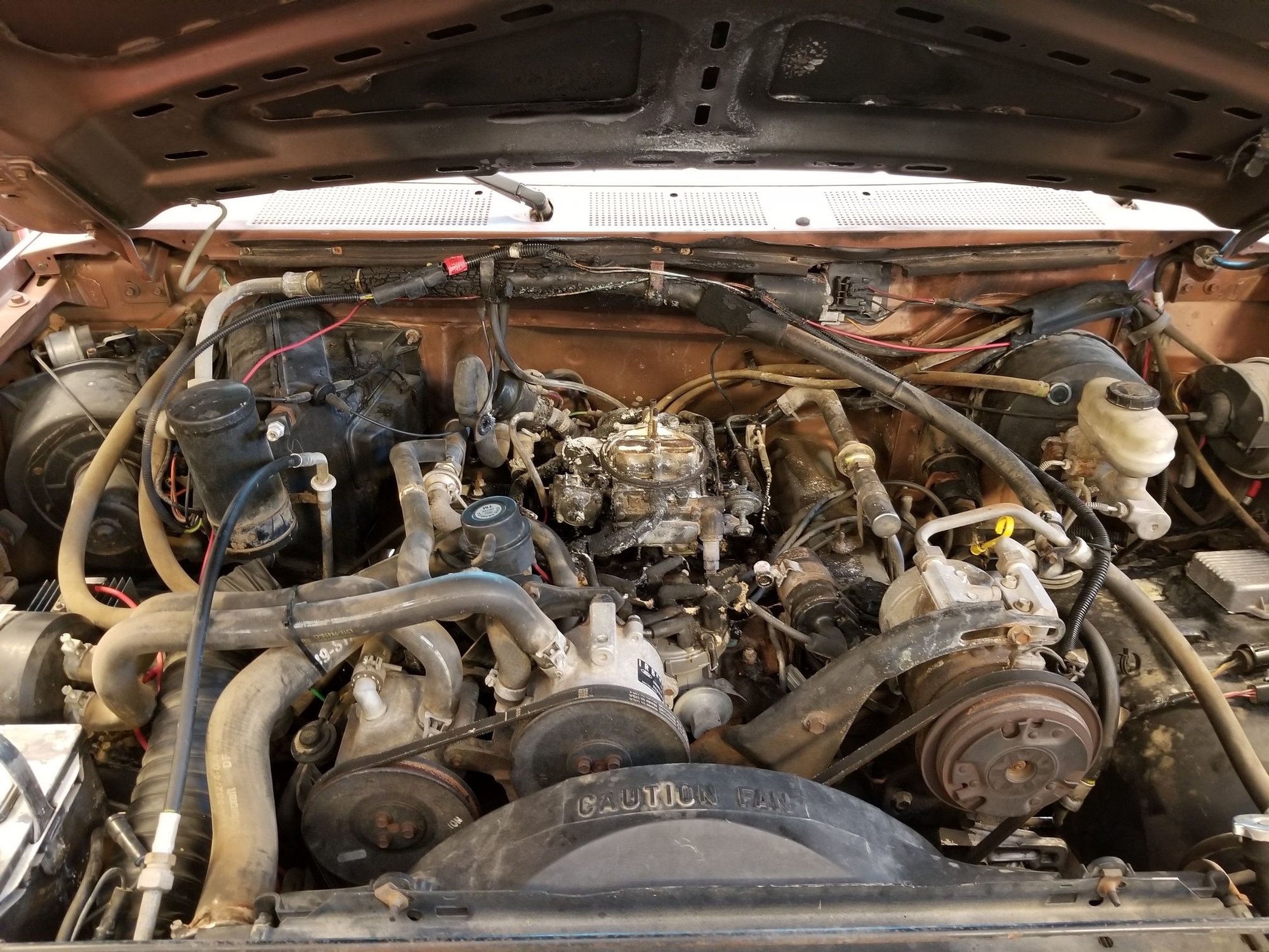

Originally Posted by BigBlue2
Give that man a Cupie Doll! Looks like a fire caused you to go full on "race". I hate all that smog gear that chokes the life out of an engine. The idea was to decrease emissions but in most cases all those bandaids led to increased emissions and reduced mileage, IMHO.
Yep. It was a project I picked up that succumbed to the dreaded Holley loose fuel line connection. It had been sitting awhile but only had 45,000 miles on it, so I thought it was worth resurrecting. It looked worse than it was as most of what burned was the emissions stuff, so it was an easy decision what to do. You can actually see there's an engine there now and it runs amazing.
