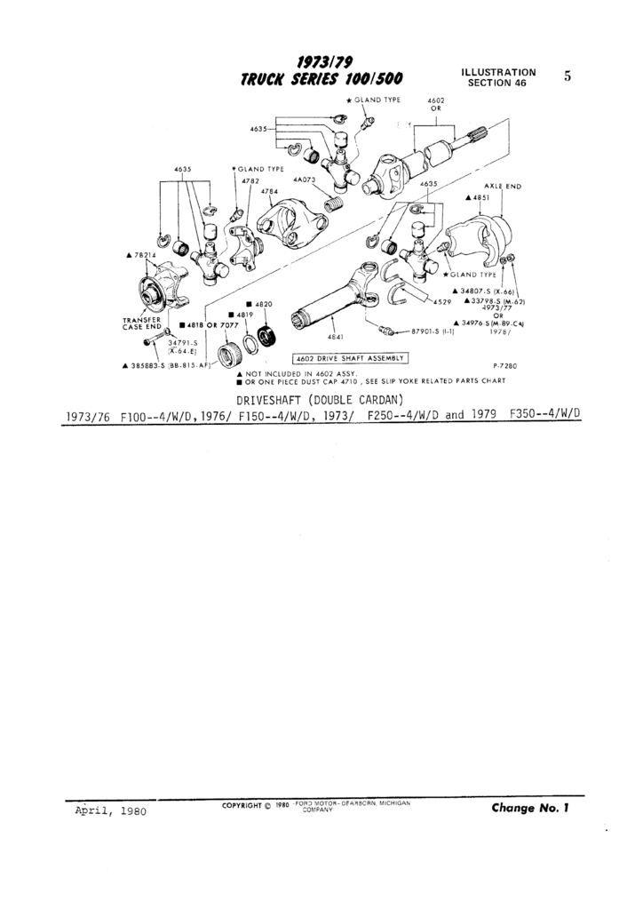

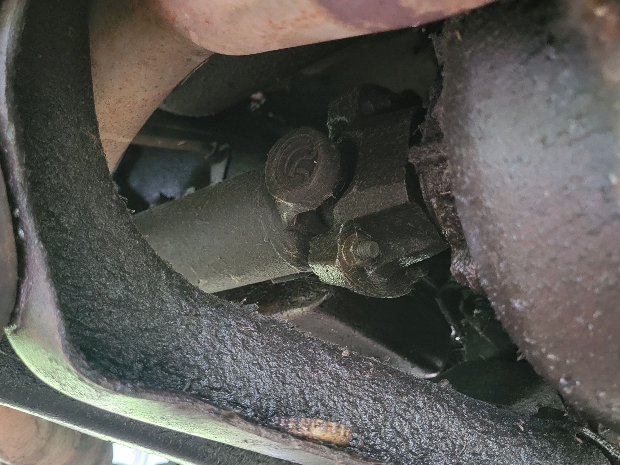

Anyone able to give me the part number for the wretched front driveshaft CV ball joint thingy. I've put it off, but it needs doing.
I was thinking about just taking the front shaft of of the Bronco for the nows, but strangely, it doesnt have the double joint & I don't think it'd clear the trans crossmember of the truck with the lift. Least not without a bit of pipe & some creative welding.

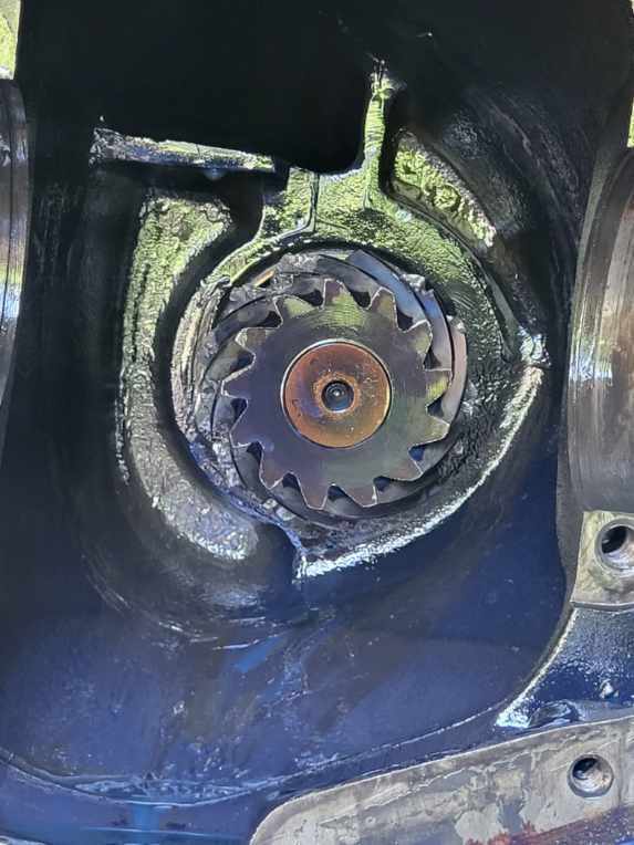

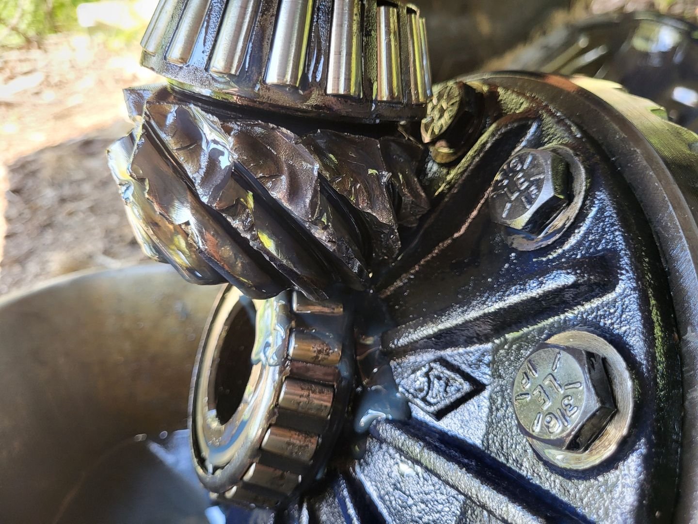

Fiddly bits suck
Whole heck of a lot of sealer in the tubes.
Found the chunky bits up between the pinion bearings.

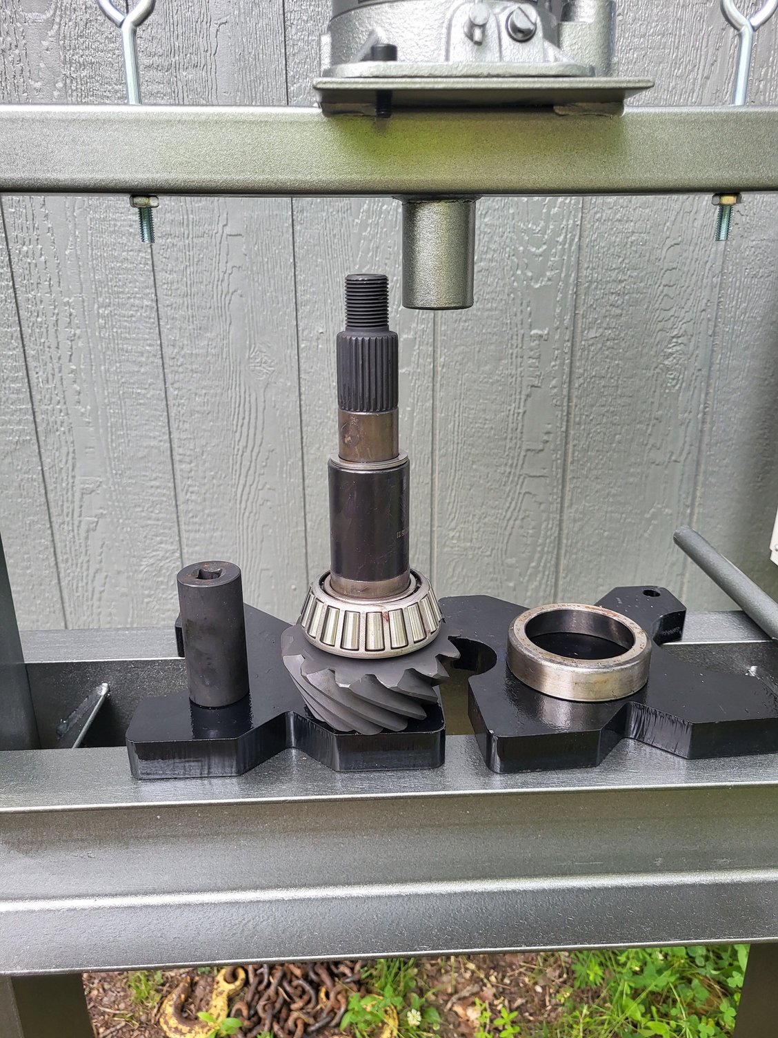

The fancy pants bearing puller is flipping awesome. Three bearings pulled in maybe 5 minutes.

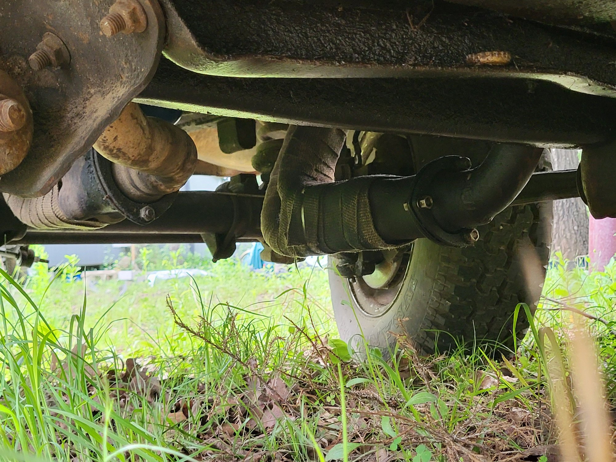

Headers made an appearance finally. Fenderwell exit. Wasn't expecting these for another couple of weeks, so I've not yet begun to soak the manifold bolts. This is gonna suck.
Managed to fall into a good trade today. A replacement for my clapped out front driveshaft. Some assembly required.

Are those inside the frame rail exit? If so I feel for you already. If they are fenderwell exit...here you go. Read both threads to catch all the info.
https://www.ford-trucks.com/forums/1...l#post14696882
https://www.ford-trucks.com/forums/1...l#post14880910

Fenderwell exit. I've learned from past headaches like these before.
Chassis exit are 10 kinds of a pain in the butt. Thanks for the threads, had the first one bookmarked. Hadn't seen the second one before.

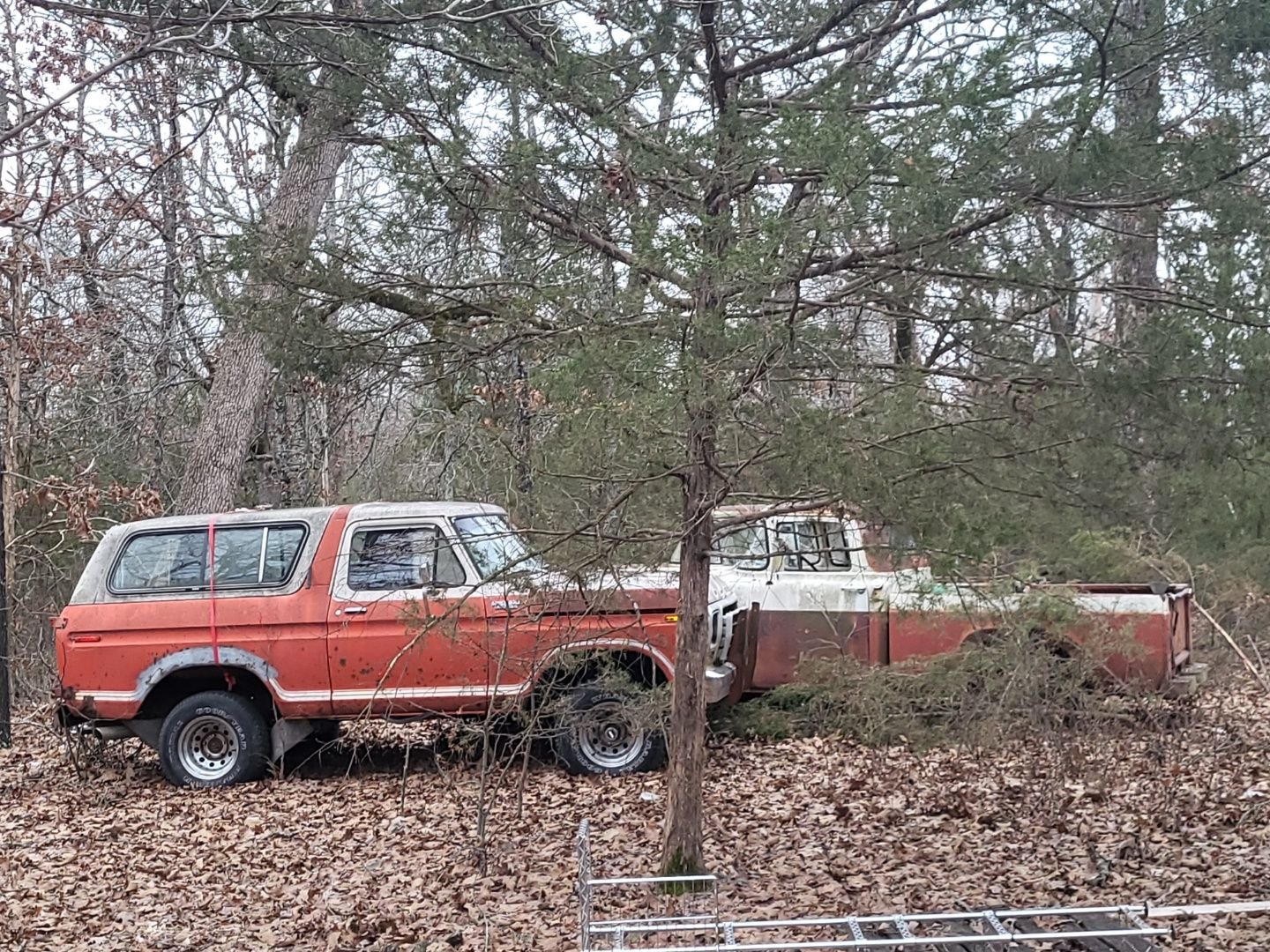

Is that your Bronco? I spy a coil spring.

It is Bob the Pumpkin Bronco! Currently only kinda sorta runs. The ring gear on the flex plate is massively trashed & only works if I hand the engine over to just right place. I've got a new flex plate sitting in the seat, but have been to lazy to put it in yet, plus he needs floors. They're rotted badly. I've had that rig longer than I've had kids & the first one of those turned 20 last week.
I've a perverse desire for many years to shorten a 3/4 ton 4x4 frame & do a swap or gather the highboy specific suspension parts & get creative. A highboy Bronco would be awesome in my mind.

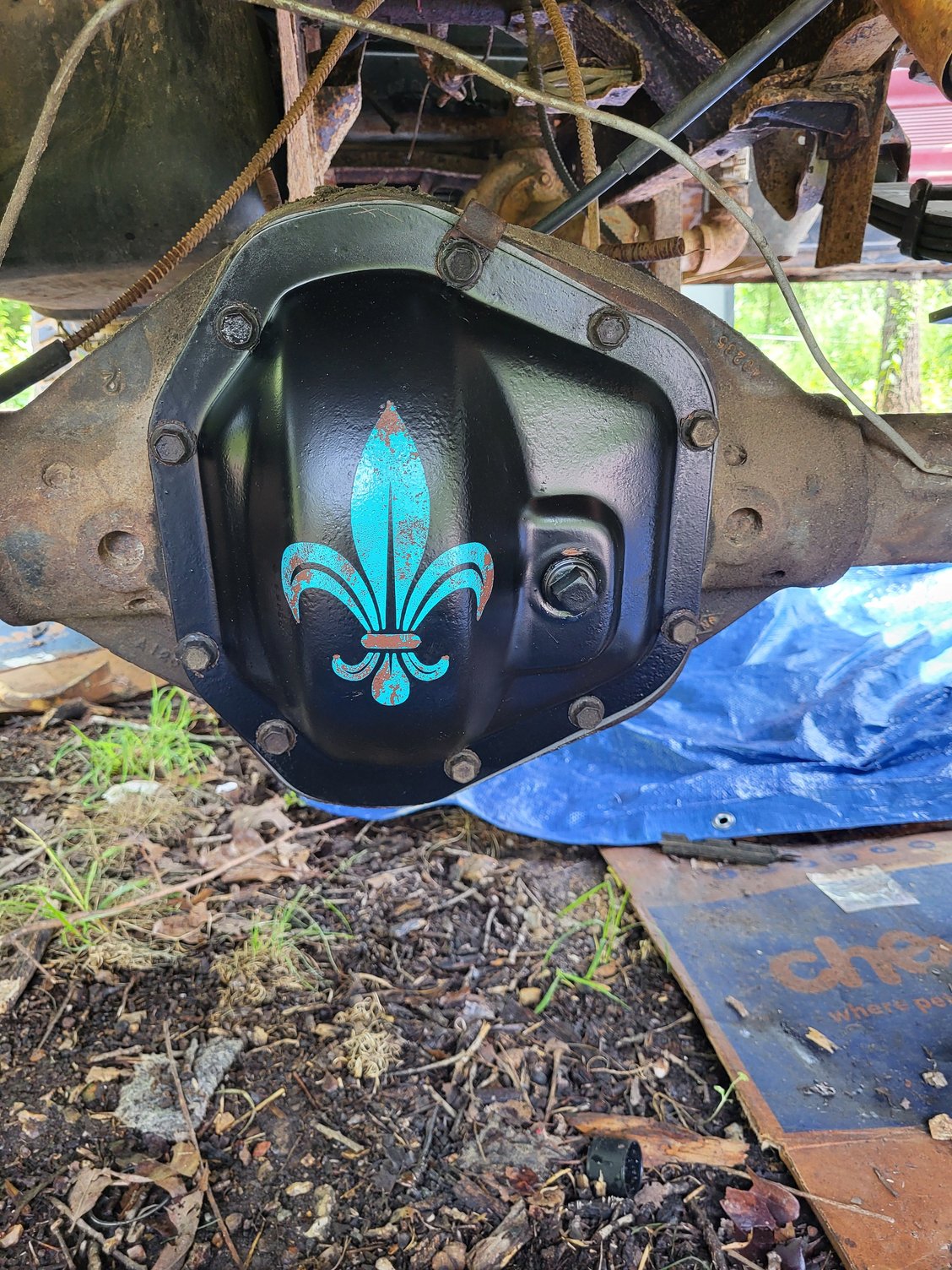

Would be tiny with a divorced t-case, would probably have to go with a married case.

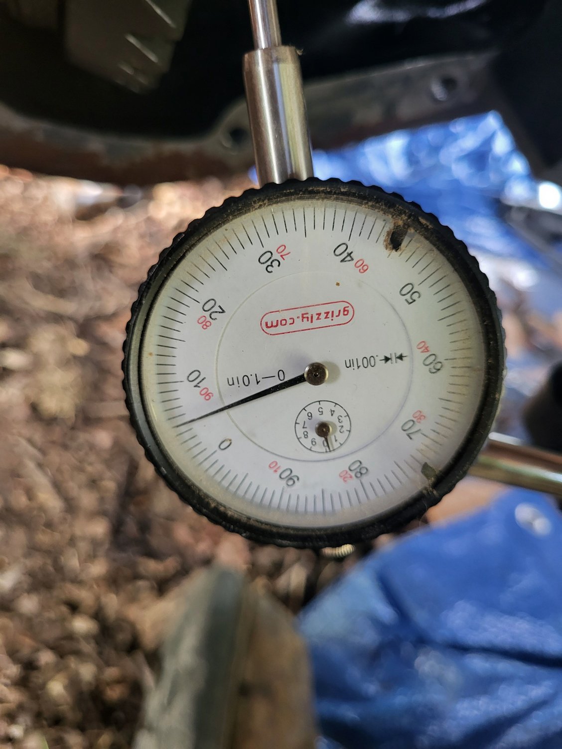

Fun day gear day it was. So he's almost drivable now.
.005" back lash.

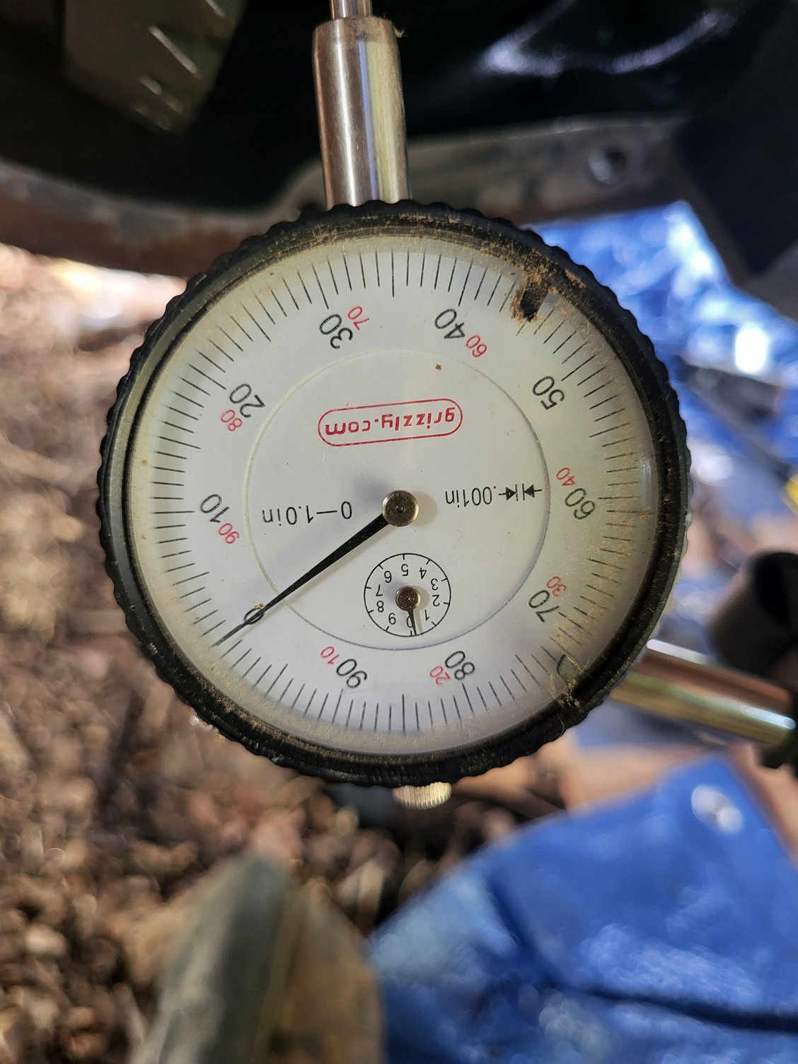

The rear-end is back together now and seems to be happy now. Went for a run around some & it did great. Now I'm curious if the transmission gears are or not. I was figuring he'd be kinda gutless with 37's and 3.54 gears, but definitely not gutless.
This bearing was an absolute pain in the butt.
Run out.
