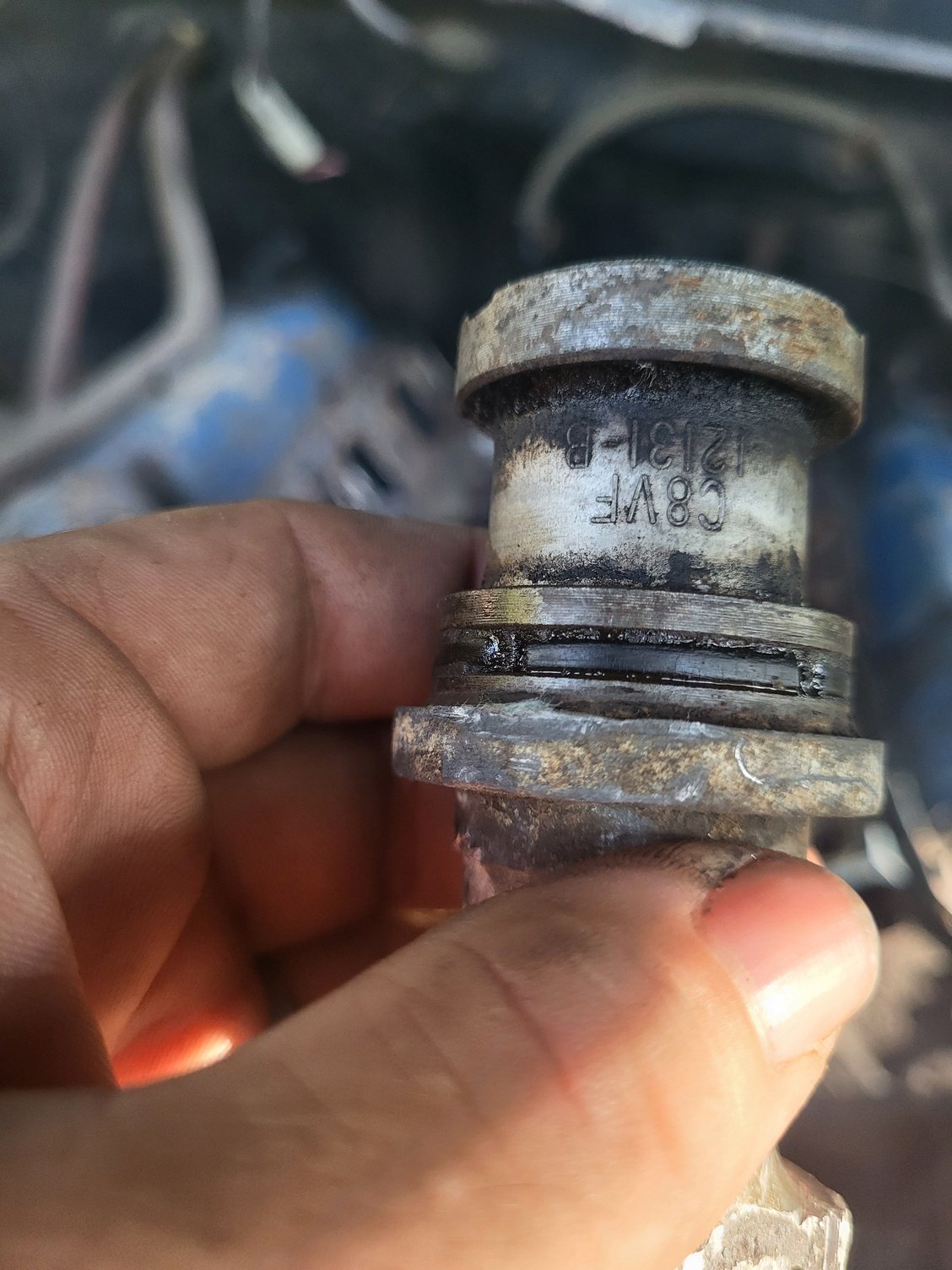

Well that was fun, but it could've gone oh so much worse. Few days soaking & the gentle ministrations of an 18" pipe wrench and a 3' cheater bar.
I wish that some folks would realize 2 things, rtv is a privilege & not a right & that the distribution O-ring is a maintenance item.
Yes, i cleaned all the junk off before pulling it. Gonna do an oil change anyway as a precaution.
O-ring failure let a lot of goop in, wasnt a bit of corrosion. This was after I cleaned it up, was just a solid black mass of grease, grime, & dirt.

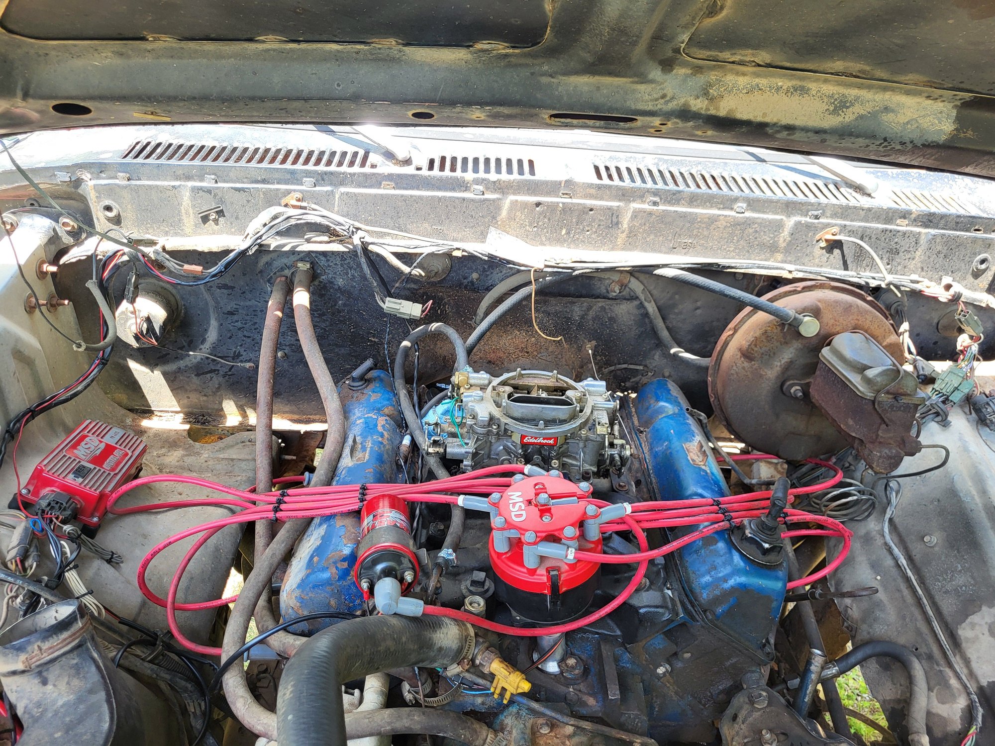

All mounted up, cleaned up & tidy. I need to play with the timing some more, but I've got to color fill the timing marks on my balancer. I just can't see that well. Could probably use a new set of metering rods ad well.
Then went for a little ride through the backyard. We'll at least the flat part of it, I still have to do the front driveshaft.

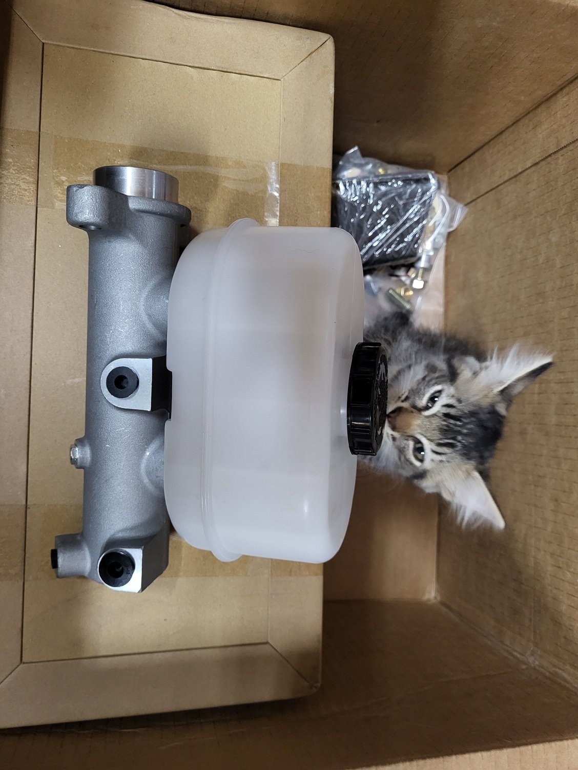

My parts arrived, but I'm not sure were this extra part goes.
That's Holly, the unexpected little Manx. Her mama disappeared for a month then came home & had kittens. Holley was the only tailless one of the bunch.

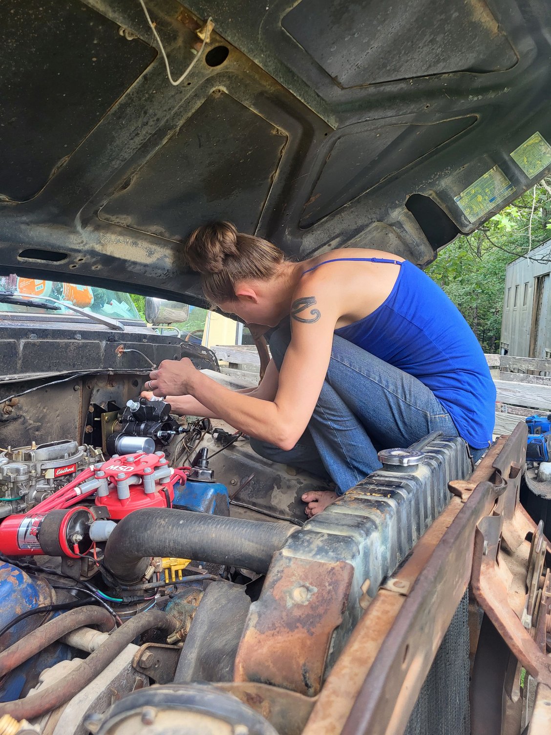

Well that went in "almost" without problems.
But it's the little things that hold a feller up. I got great big fat bag of connectors & fittings for the pressure lines and guess what, not a single one fits my steering pump. Which is my fault, I've got the old small neck Thompson pump & completely spaced out that they're different size & type connectors than the C2 pump. My credit card absolutely hates this truck, got a Saginaw pump & bracket coming.
Was a fun day though. The wife was the main wrench turner today. I like hanging out with her.

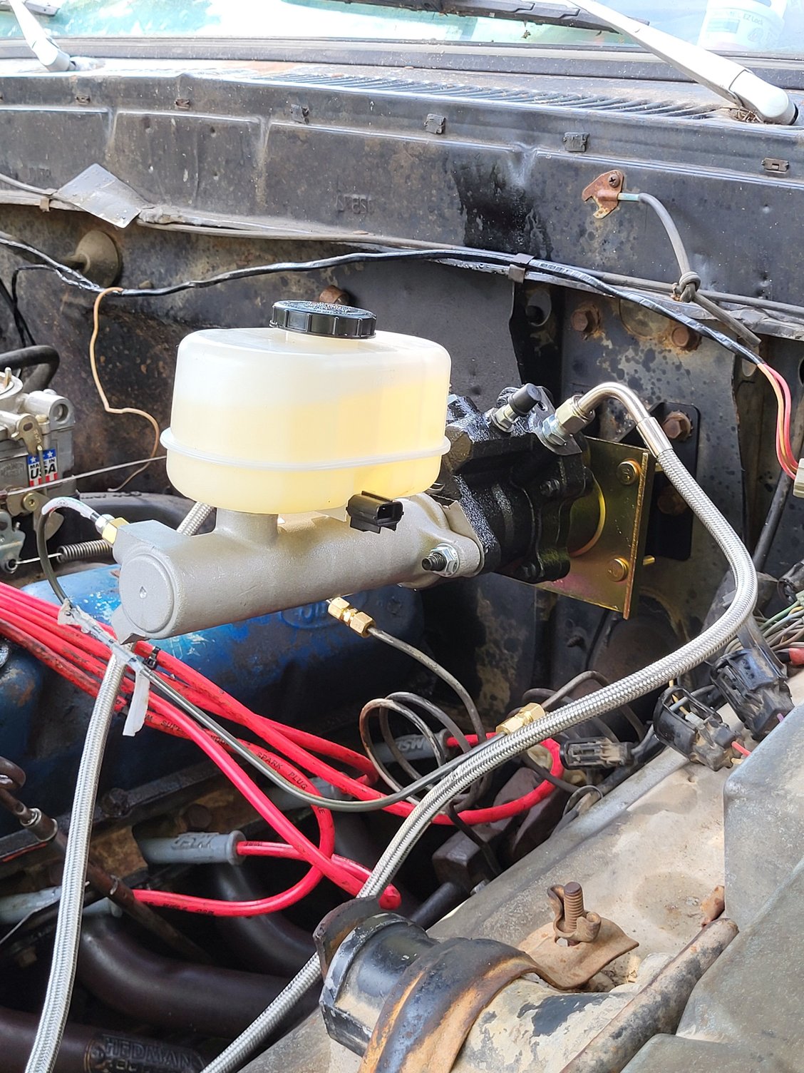

That brake set up looks good, was it bolt and go for the rest of it? And where did you get it from?
Old Jul 28, 2024 | 07:27 PM
  #99
Fleur de lis 82's Avatar
Fleur de lis 82
Joined: Feb 2020
Posts: 471
Likes: 247
From: South Central Mo
Aside from digging through the supplied fittings (which are marked for what they are & go to) it was bolt & go. Took maybe an hour & a half to install, bleed the MC, hook up the steering gear & realize my steering pump snafu.

And now I've got me some super brakes. I need to tidy things up still, but he stops reeeeeeeeeally good. The steering was good before, now it's better. I didn't want to cough up the coin for the saginaw, but I suppose it was the right decision.
