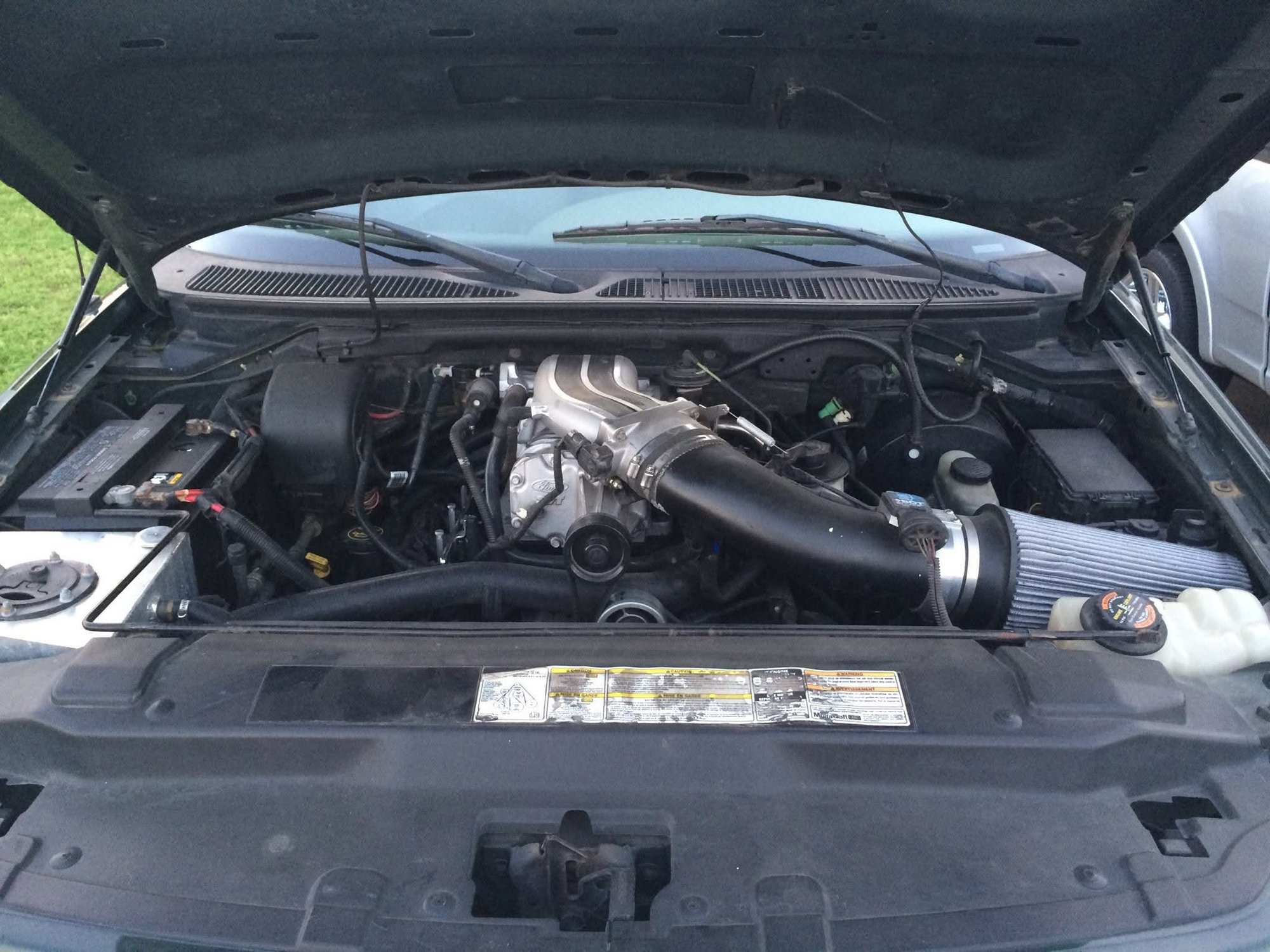

I flog my truck, sometimes I tow with it instead of my powerstroke
my truck is sporting:
6# lower
Jokers Port
filled silencer holes
long tubes
108mm JDM CAI
SCT MAF electronics
midplate spacer
Magnum Powers Big O throttle body
dual H/E’s
Jabsco Bilge Pump for the I/C
JLP street tank
Old Apr 30, 2025 | 08:46 AM

looks like you’ve got all the supporting mods down basically enough besides opening up the block and putting in rods, right.
Right on this information is definitely helpful
Maybe I’ll save the money from the transmission controller put it into a ported blower something
