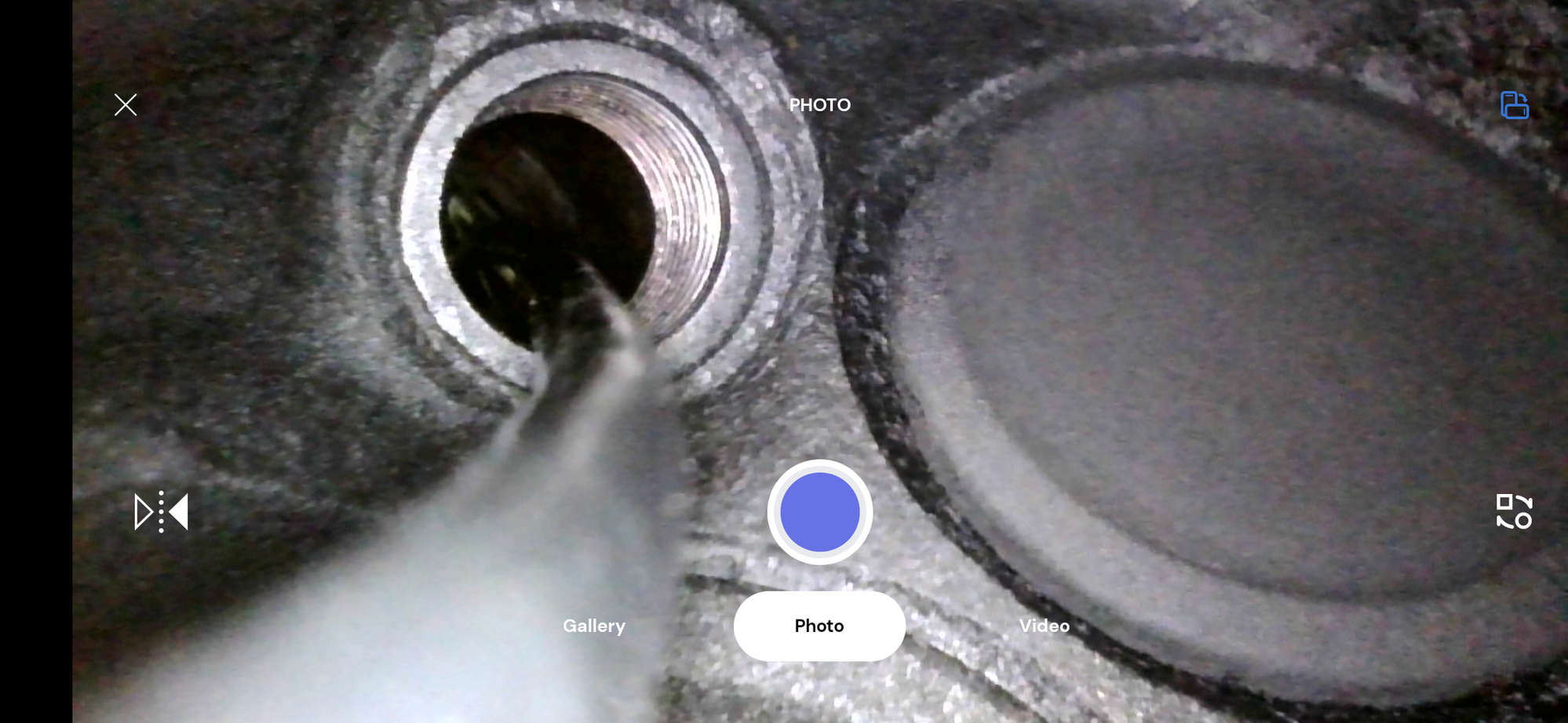

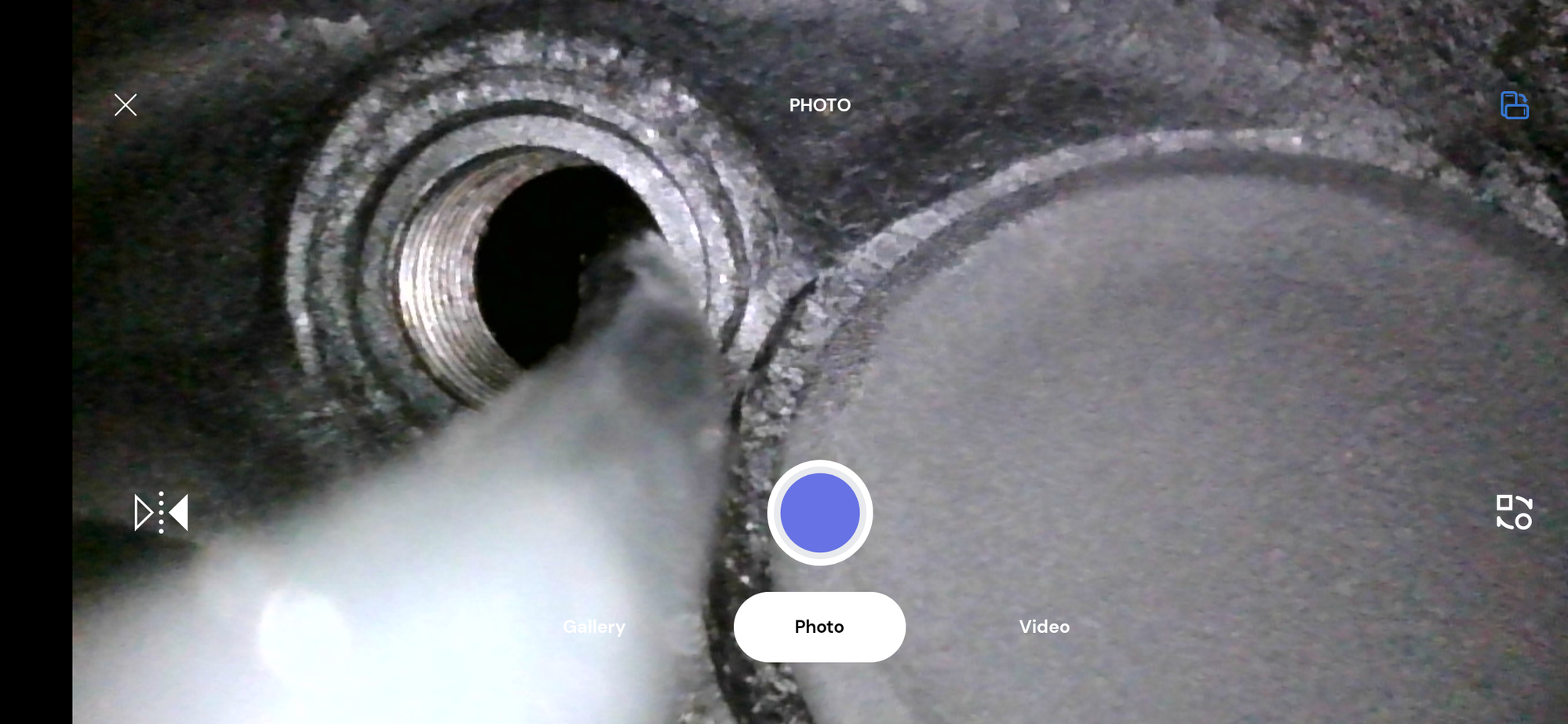

Here are a couple images I was able to get. I cannot really see much with it being in the back. Hopefully you guys see something obvious. I also took my cheap bore scope, bent it in a U and stick it down the plug hole to get a little glimpse of the valves. The one thing I noticed is shown in the first photo, the line in the middle, I didn't notice that on anything else.

Great photos, especially for being under the cowl. Looks like a lot of carbon in the combustion chamber, which suggests oil.
How does the top of the piston look?
A leakdown test is your next free diagnostic option, one that would tell definitively where the compression is going. Rig a setup to go into the spark plug hole where you can run a compressor into it, with intake and exhaust valves closed, then listen to see where it's going.

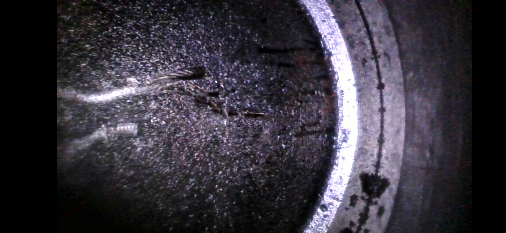

Here are a couple photos of the piston top from awhile ago that I guess I didn't share. Not sure it shows enough detail, but hopefully so.

That piston and cylinder look beat up, with high carbon buildup....unless thats something you did with the bore scope.
Move the piston down so you can see the walls too. All arrows point to it being a trash cylinder from foreign debris, unfortunately.

That really looks like it had an insert was installed in the plug hole and the debris was never cleaned out of the cylinder, they should has packed the ream and thread tool with grease to catch most of it and then vacuum out the cylinder to get the rest. If you look at what's on the top of the piston it looks like what you get when you cut a thread.

I can confirm the cylinder has an insert. It came out when I pulled the plugs originally. I don't think I hit the piston enough with the bore scope to cause that pattern either.

yes it sure looks like something embedded in the piston top which COULD mean it has a bent valve head that could be the cause of zero compression, that line in the rocker roller is from a binding roller, some blue smoke? blue is oil,white and sweet smelling is coolant .

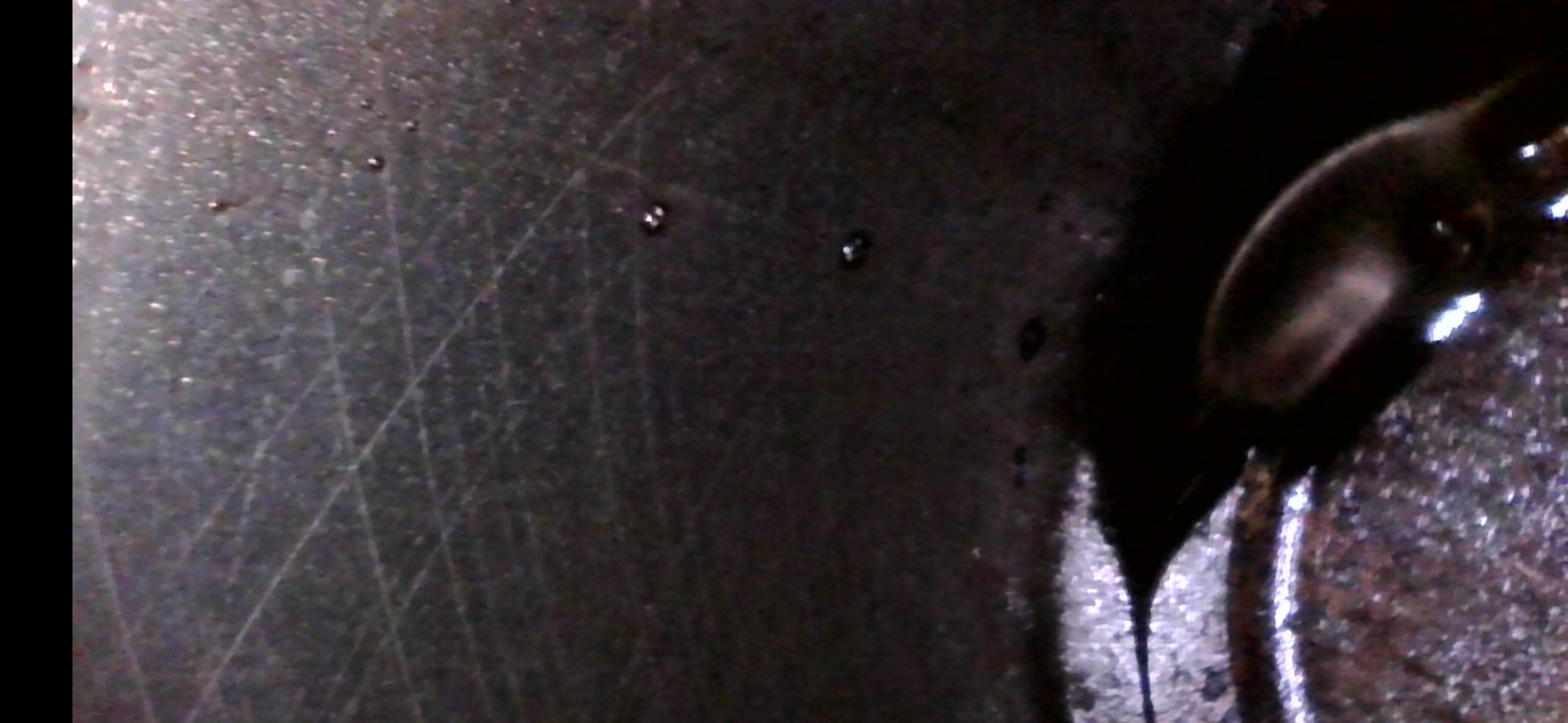

Here are a couple photos, only showing one section of the cylinder wall, couldn't twist the camera around to get others, will have to try to manipulate it later if needed.

Well, the pool of oil is weird. The vertical lines on the bore look like they could be gouges, but hard to tell without running a fingernail across them.
That's a lot of oil for a valve seal to be leaking by, but I'm not sure what else it could be coming from. It's possible that the oil hdyrolocked the cylinder and took out the rings, resulting in your 0 compression.

I thought the oil was interesting too. I thought maybe because I cranked it over to get the piston down the cylinder, but that doesn't make sense. I didn't notice it in there though before when sticking the scope in, though maybe the cylinder was too high up and I wasn't getting a complete image.
