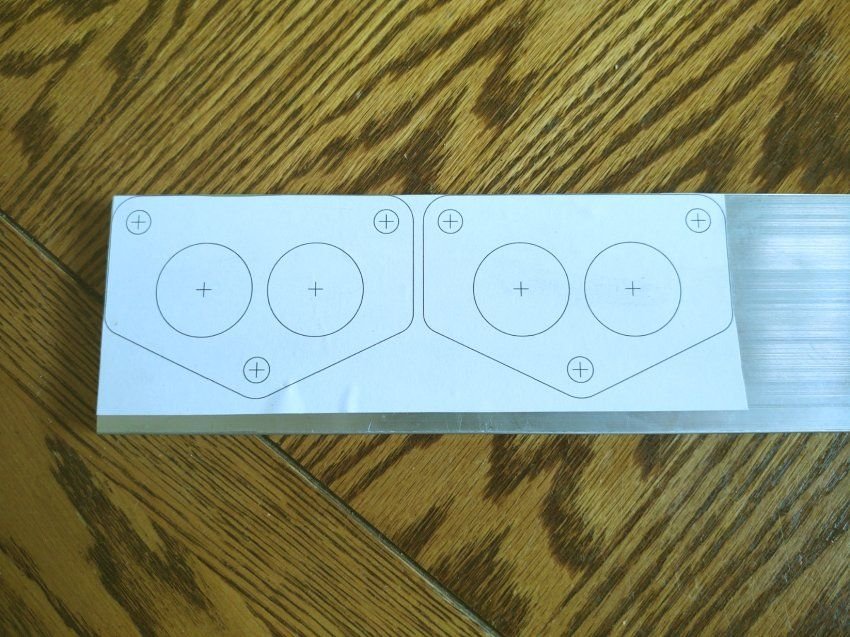

This is kind of getting away from the main discussion but still related. I made carb spacers for the dual carb set up in my '37 Buick. The dual carb set up was only offered in the Special in '40 and '41. I have have '40 engine in the car. In '37 and '38 the engine sits level in the frame, the later models the engine sits at a slant toward the back. If you install the dual carb set up in the earlier models the carbs will be uneven and tilt forward. I made two aluminum blocks that have a angle to compensate for the slant. It was pretty easy with a piece of 1/2" thick aluminum, a drawing, hole saw and a friend with a mill. I could have rig something up in my drill press but I knew someone with a mill.

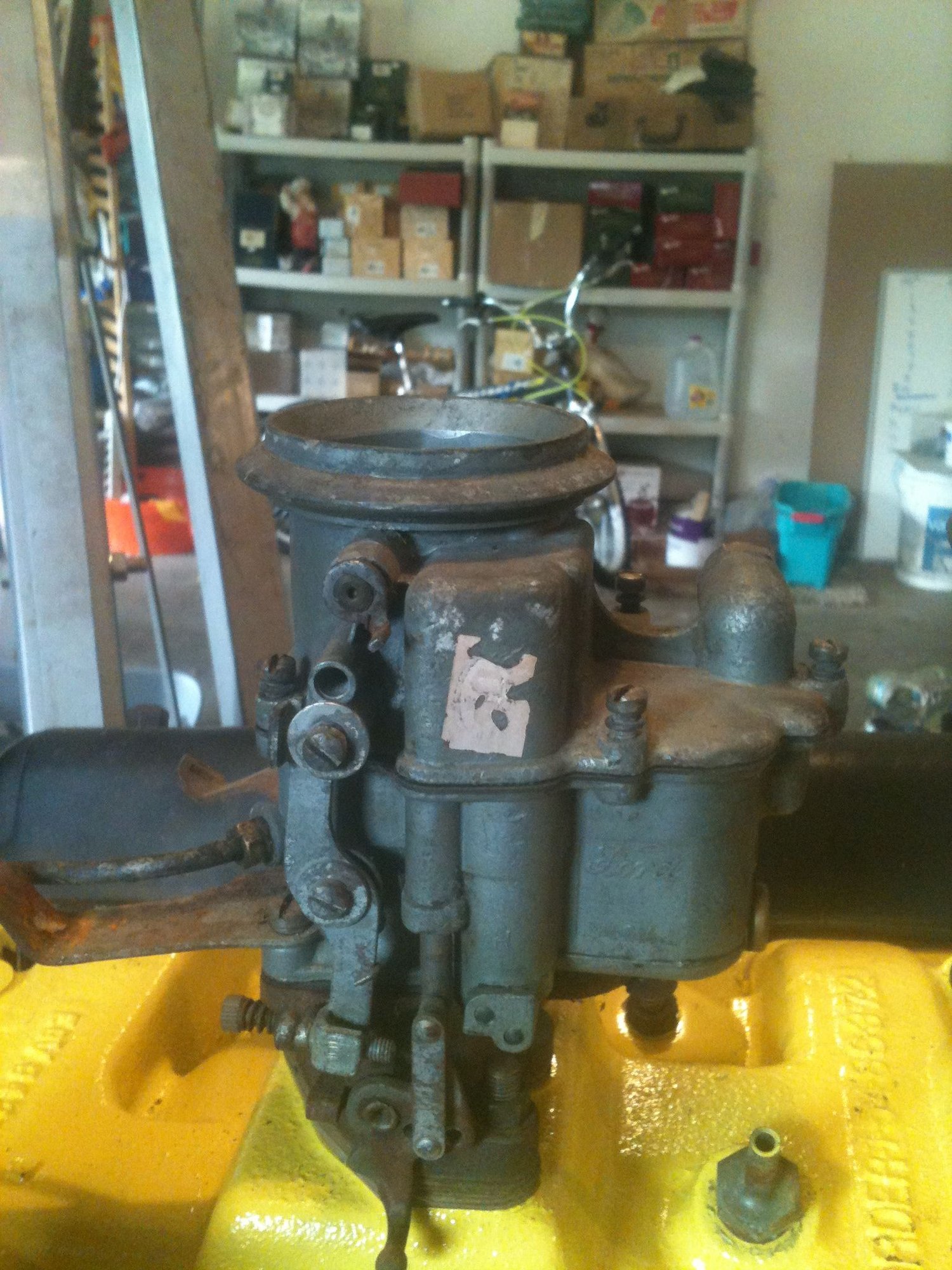

Does your manifold have a boss right behind the carb, where the plug is in the pic below? Big Truck manifolds had that for power brakes. If you have the boss but it isn't drilled/tapped, you could put one there, but you need to be sure you don't drill into the exhaust crossover passages.
