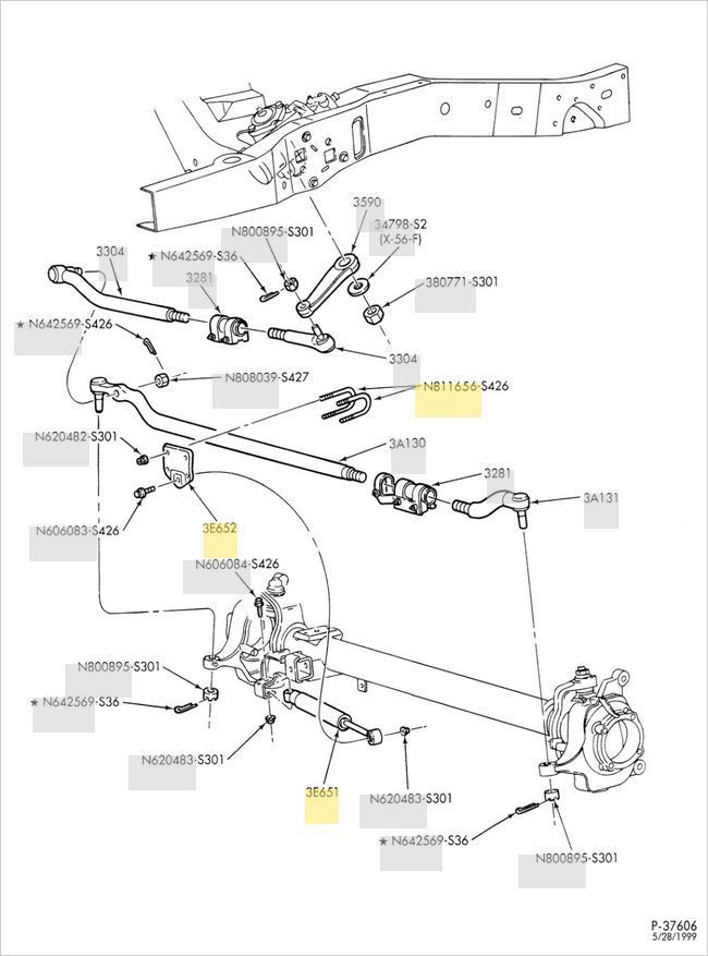

At least on the 4x4 7.3 Ford thought it did something as standard equipment.
