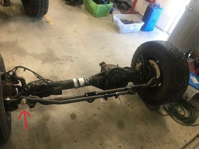

AFAIK all the leaf-sprung Ford Dana 60's had the same T- link style setup like the 4x4 Excursion's had. Yeah the drag ling connects to the tie rod and not directly to the knuckle, but the tie rod is still solid between each knuckle. Below is a pic of the Dana 60 currently in my Excursion. There is a solid tie rod going between the two knuckles and the drag link is zip tied to the tie rod so it doesn't flop around during installation (read arrow at the connection point)

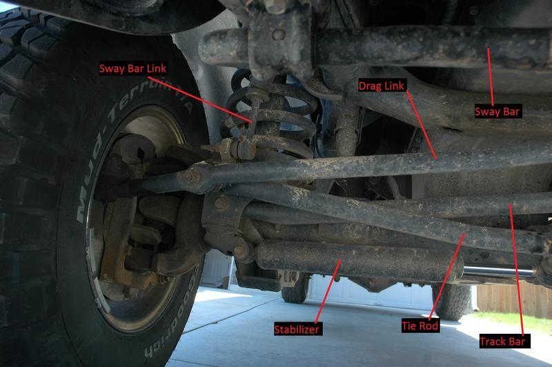

A Y-link steering (like the Dodge setup I mentioned hating earlier) has the drag link going to the knuckle, but the tie rod for the other side connecting to the drag link. So the two steering knuckles are not solidly tied together. So while a Y-link setup doesn't really have bump steer, the toe number changes every time the suspension cycles, and change differently side to side for a given amount of suspension travel. Below is a google image search pic of what a Y-link setup looks like. This is what my Dodge (and my old Jeep XJ ) had in stock form. They have their advantages and disadvantages, didn't hate it on the little light Jeep XJ, but hated it on the heavy Dodge Cummins truck (hence why I converted the Dodge to a T-link setup from a later year truck with an HD steering option).
