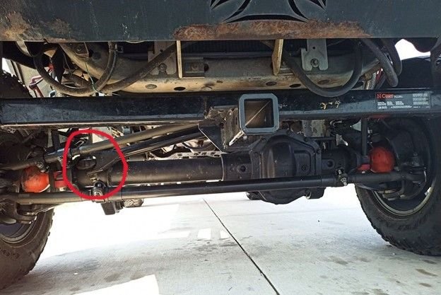

Not related to the thread topic, but I'm assuming there is a rod end /johnny joint of some kind at the axle end of track bar (red circled in pic below) allowing for the misalignment. Does this not bind/ limit articulation when the suspension articulates such that passenger side is in compression and the driver side is in droop? Or does something else limit articulation before that binds?
And are those legit birfeild joints? If so I'm jealous, always wanted a real set of birfields, just never could justify the cost as I really don't need them for my mild stuff (still want them, just don't really need them).
Yep yep yep ah hah. RCV axle shafts. One of those staring at the freshly cleaned housing and deciding to just go for it situations. $2400ish at the time of the build, but bind-free steering in 4WD is so very worth it and I'm not getting younger to enjoy nice things.
Srly tight turning radius with none of that u-joint jerkin shakin poppin lockin going on.
The track bar end you have circled is a uniball cup turned down to fit and takes maybe 20 minutes to rebuild. Made by Baja customs, called the tracinator. I highly recommend it. If for nothing else, never messing with that balljoint or death wobble ever again.
All I can say about bind is that it hasn't happened yet. As far as I could stuff that side, it still had clearance. I might have a pic.
Baja Customs was on the forum at one time, they could give you the nitty gritty. https://bajacustoms.com/product/the-trac-inator/
As she is, the sway bar binds before anything else can get in trouble. I still haven't measured for limit straps so that's all for the best.

In the link to Baja customs you posted, they have that joint at center travel with the vehicle at ride height (see pic below copy/ pasted from your link), so the tab on the axle side must be welded on at matching angle to the track bar. Your picture the bolt/ joint appears to already be misaligned some at ride height, that's why I asked about possible binding during passenger side up travel/ driver side down travel situations.
Baja customs pic/ joint centered at ride height.
Below maybe not centered / already mid travel at ride height?. Hard to tell as camera angles can be tricky I suppose, but it appears as though the joint is already at mid travel with the vehicle at ride height as the bolt coming out the bottom looks way off center from the axle tab (again maybe an optical illusion, and just appear that way in the picture IDK). But if its working, then I guess it really doesn't matter much.

I think you might be on to something there. It looks to me like their pic has a drop bracket and I don't.
Won't hurt to take a look at mine to recheck everything.
