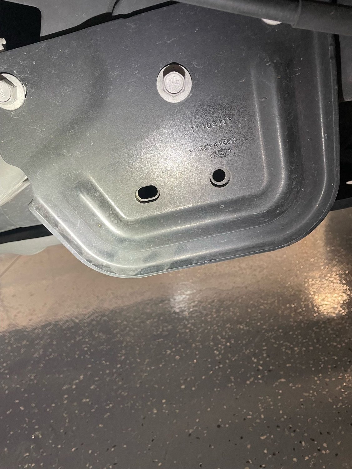

Originally Posted by SARDiverDan
As a reference, here is mine and it has no marks on it
That's on your '19? The holes on my '19 had corrosion in short time, as if something had removed the paint before or during delivery.
And here it is today..

Yes, that’s a pic I took yesterday on my 2019.

Originally Posted by Chickenguts
I wondered why it looks like it has 2 bolts missing. The 2 bolt holes look like they have been used before.
The two holes are tooling holes for locating the part as it is run through the stamping die. Most likely a progressive (prog) die.
As the sheet coil stock moves through multiple stations in the die, the holes locate in each subsequent stamping operation. But more importantly, the datums are used to certify inspect the part against the released engineering drawing upon completion of stamping. The surface that the bracket touches the frame would be the primary or A-datum, the round shaped hole is a 4-way locator or B-datum and the slot shaped hole is the 2-way locator or C datum.
