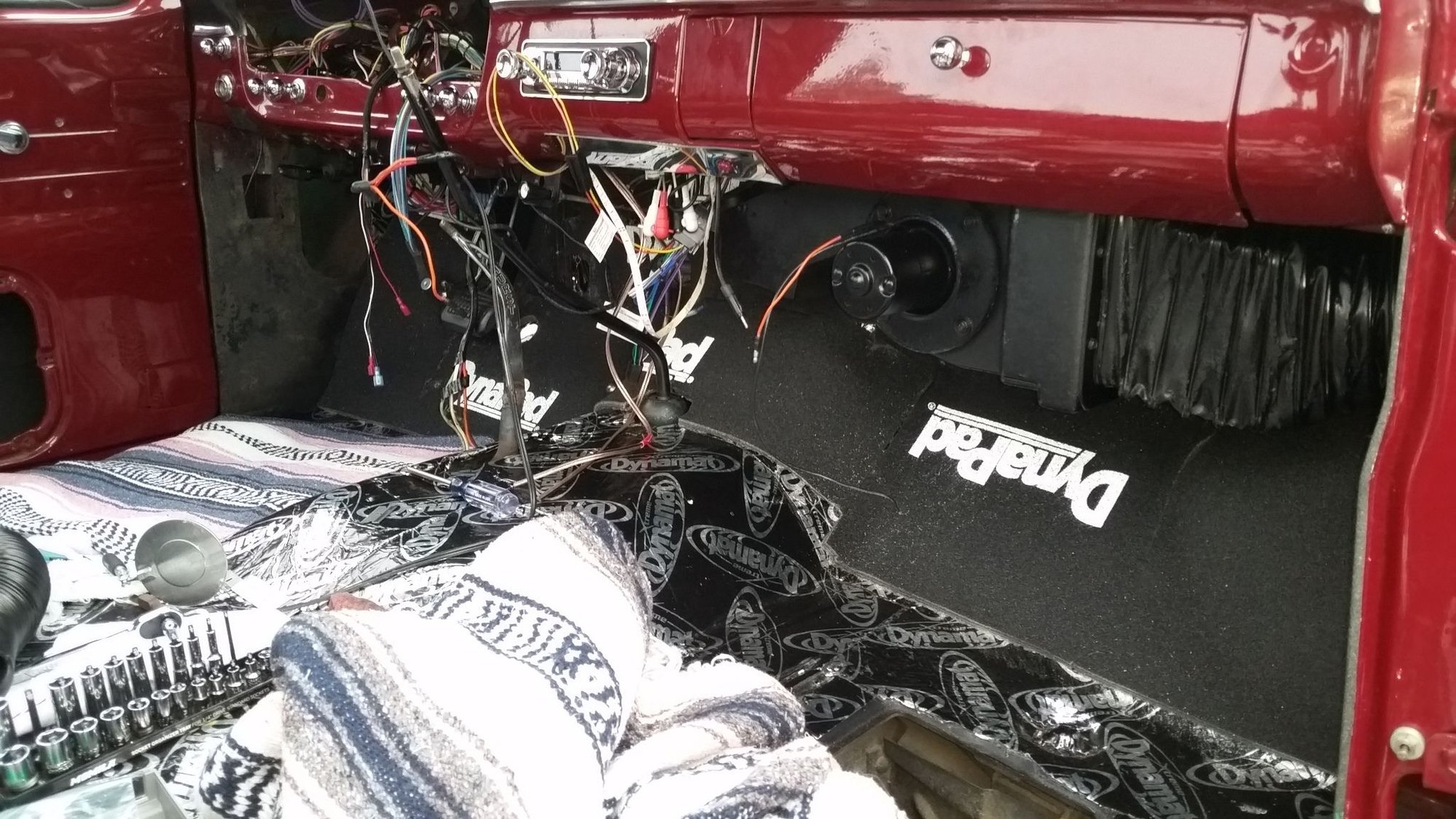

Well, for better or worse, here's the every square inch approach...
(The worse is that the butyl/mastic (?) stuff is never going anywhere without a big fight, so if you want to get access to the underlying surface for any reason, beware)
To work around the features, such as humps and curves, the stuff bends pretty well with use of a good roller. I highly recommend a good roller such as this
Amazon Amazon
rather than the cheaper ones they like to sell with the material.
To work around the pedal brackets etc, I just slit it with scissors or a razor as I went. But just as often cut it short then pieced it together with smaller sections.

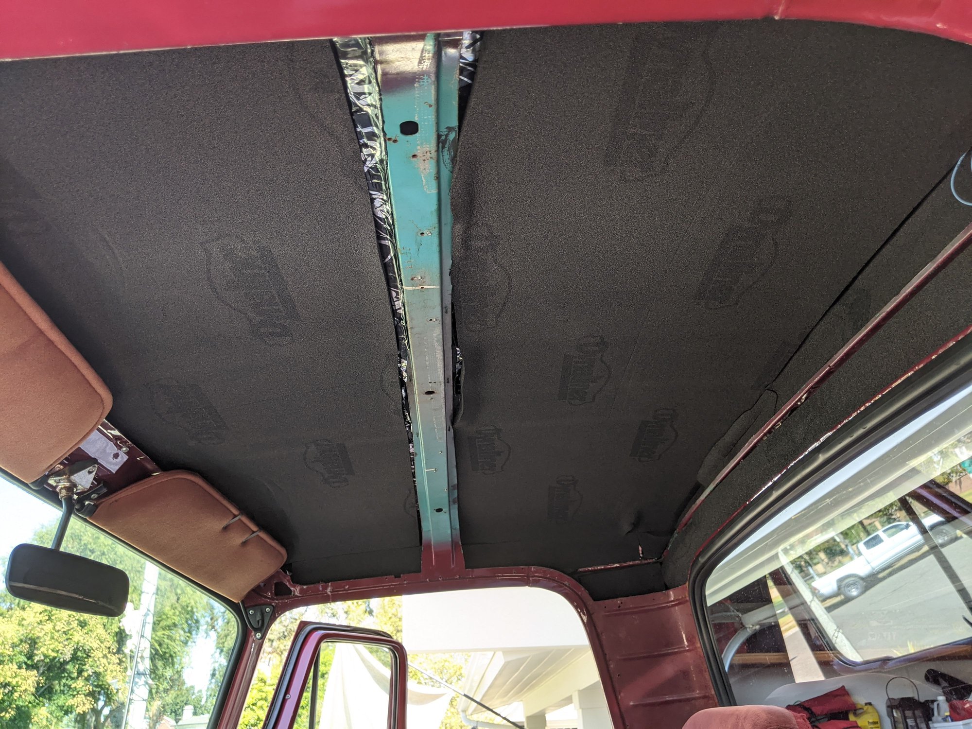

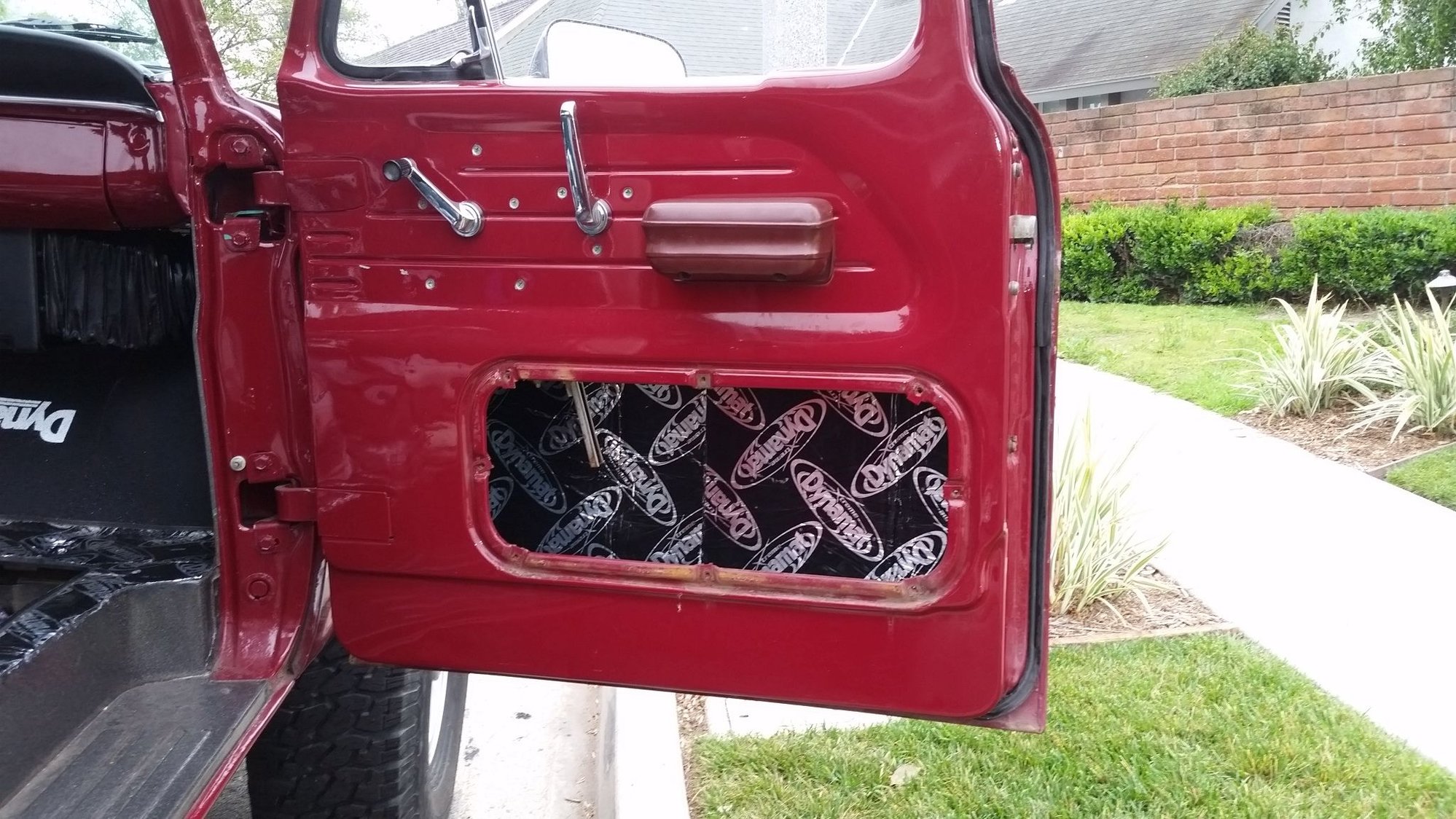

I assume you are trying to insulate the cab from noise and heat/cold.
I highly recommend the inside of the doors. That made a big difference for me. As well as the ceiling, floor and behind the gas tank.
