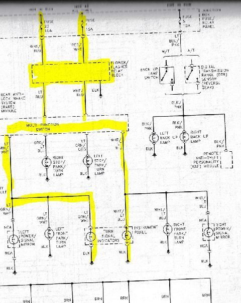

Posts: 29
I was able to take a look at the schematic this is the general exterior lighting schematic for F250s and F350s. If I were trying to diagnose, this is the circuit I would start with if switching the bulbs didnt work:
This is not applicable for his year truck, there is no flasher relay, the SCCM reads the turn signal stalk and converts it to a CAN bus message that the BCM reads, the BCM will then turn on/off the FET for each turn signal on the truck.
Great catch, I cant believe I missed that. For some reason I thinking the truck was earlier than 2011.
Sorry Jkern361x, please disregard my previous post.
