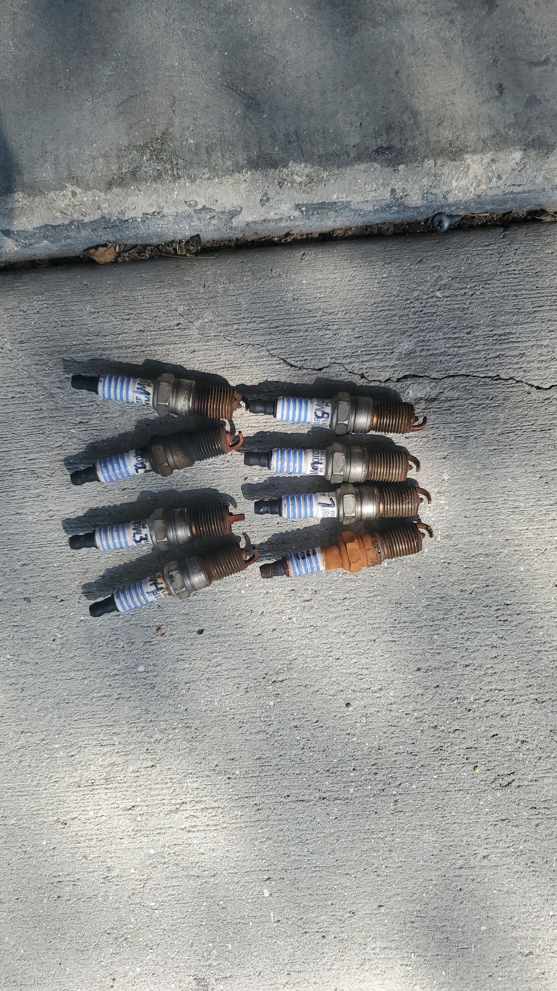

Thanks for the information. That would make sense. These particular PIDs are a bit out of my depth, but I am doing my best to keep up and learn. Does that apply to the ISC Trim as well, or would that be mostly for LTFT & STFT? The reason I ask is now the ISC Trim is behaving a bit differently. It still reads 65K but now it is getting other values as well intermittently like 1 not 100.
After hearing that the computer was probably calibrated for OBD1, I decided to spend the day forging ahead with some neglected maintenance. The first was the plugs and second was the IAC. I cannot express how much smoother the truck is running. I am also glad I checked because cylinder 2 was a problem waiting to happen. It was only in finger tight. Cylinder 8 was extremely corroded. Here is a pic of what the plugs looked like at 80k and change on the clock.
