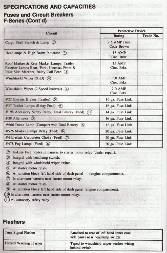

Have you been able to verity that you have power to every point in question? And for turn signals and 4-way hazard flashers, there are two separate flasher units/relays under the dash that could be at fault.

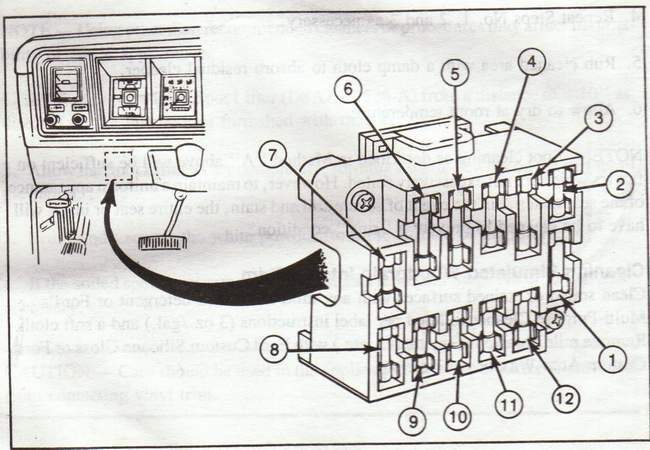

Get a good test light or 3 and place them in different areas (truck, tool box in garage next to meter, 3rd?)
The first thing I would do is pull ALL FUSES and clean the holders and the fuse ends.
They get a funk on them an dont let power thru.
