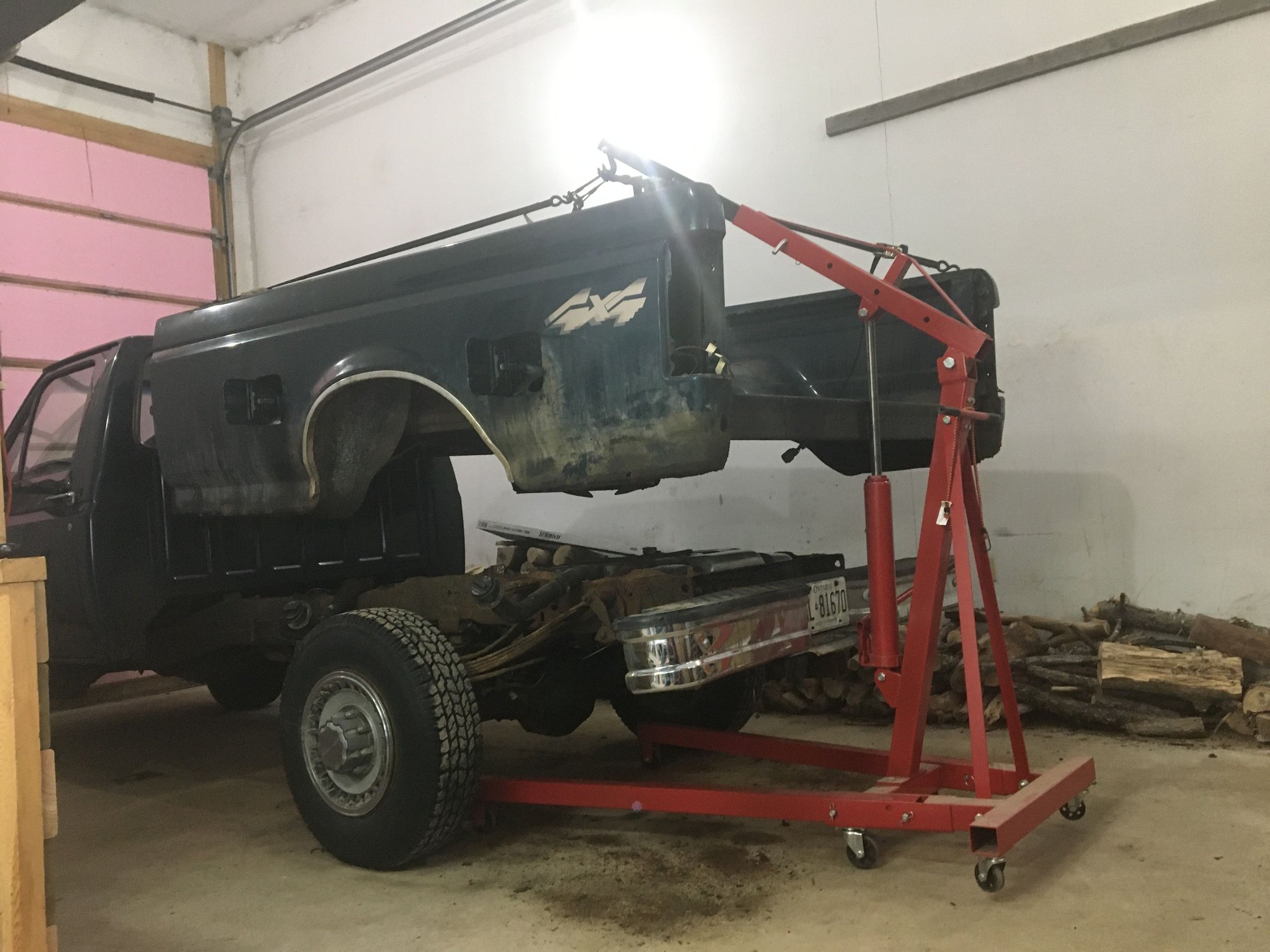

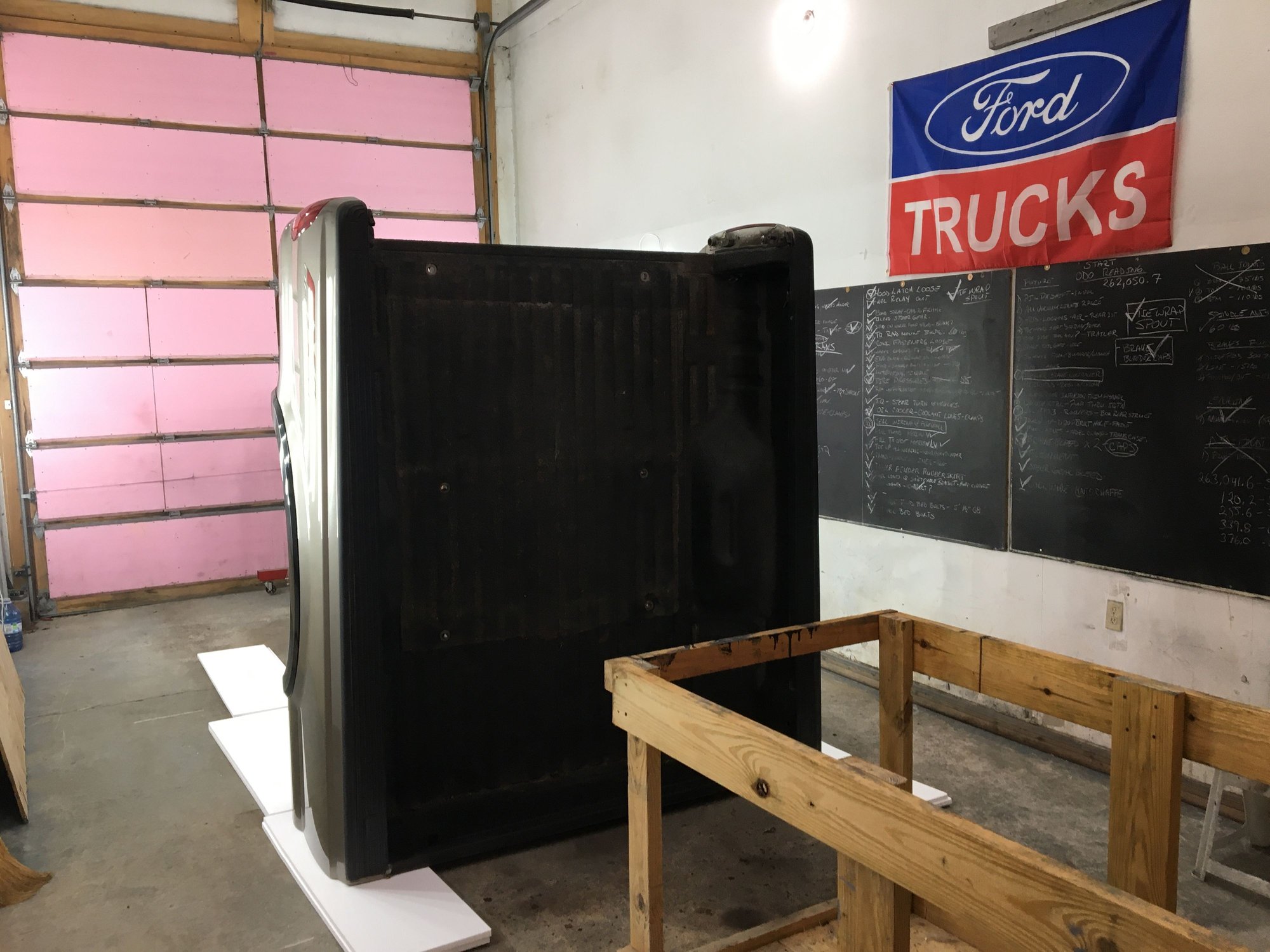

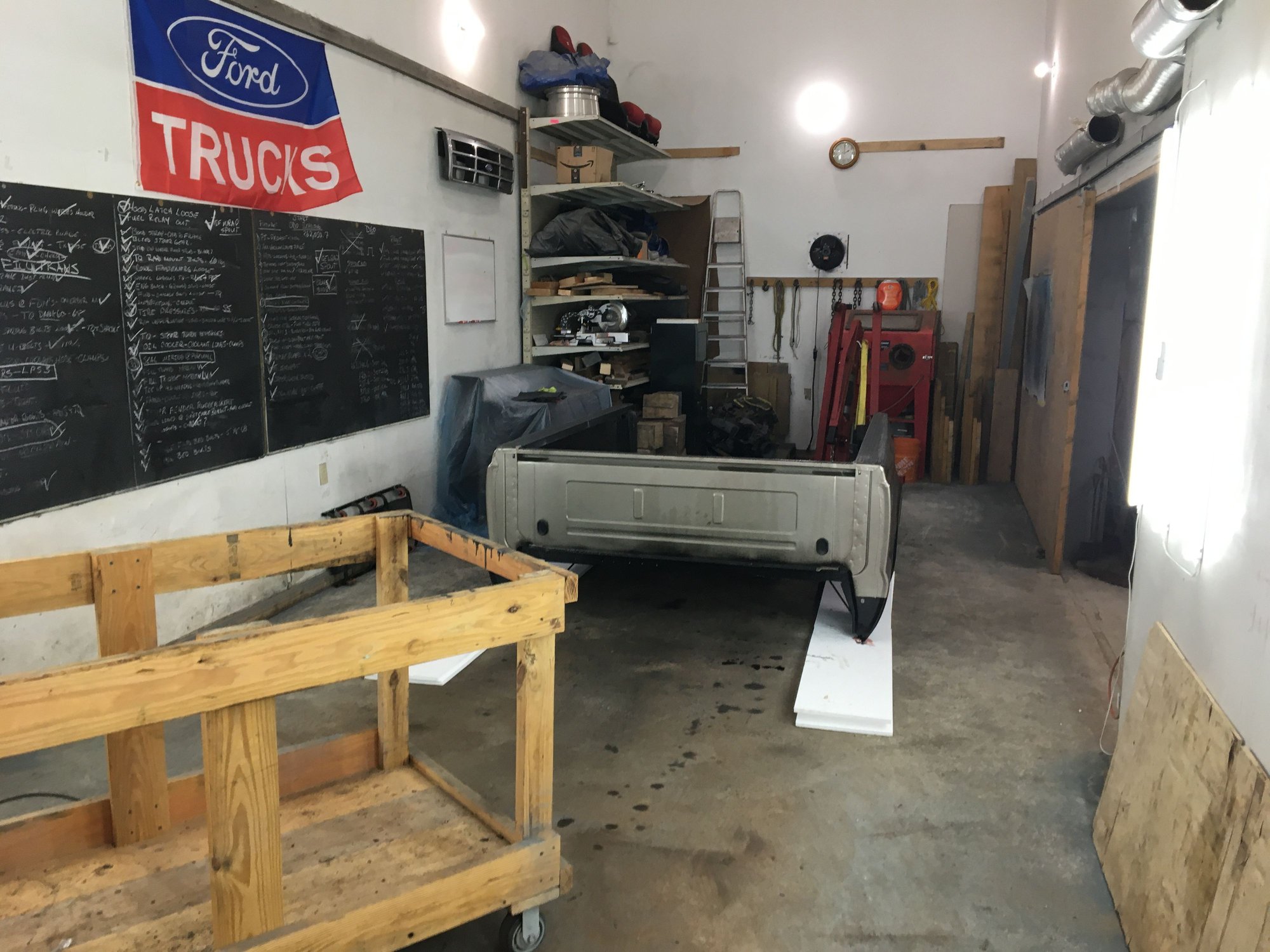

Above works, your boom Im sure would work too.. if you have a shop floor and shop crane that’ll work too. I use ratchet straps with a cable loop in the center, others use lumber etc. If you lift it up, you can drive it out if not enough room to maneuver it around. Two guys with good backs can get it off, one on each corner works even better.
I built a rolling stand. I can stand them up on end by myself, and lay them down on the stand. The stand doubles as a rolling shop table when not needed.
Pics for reference..

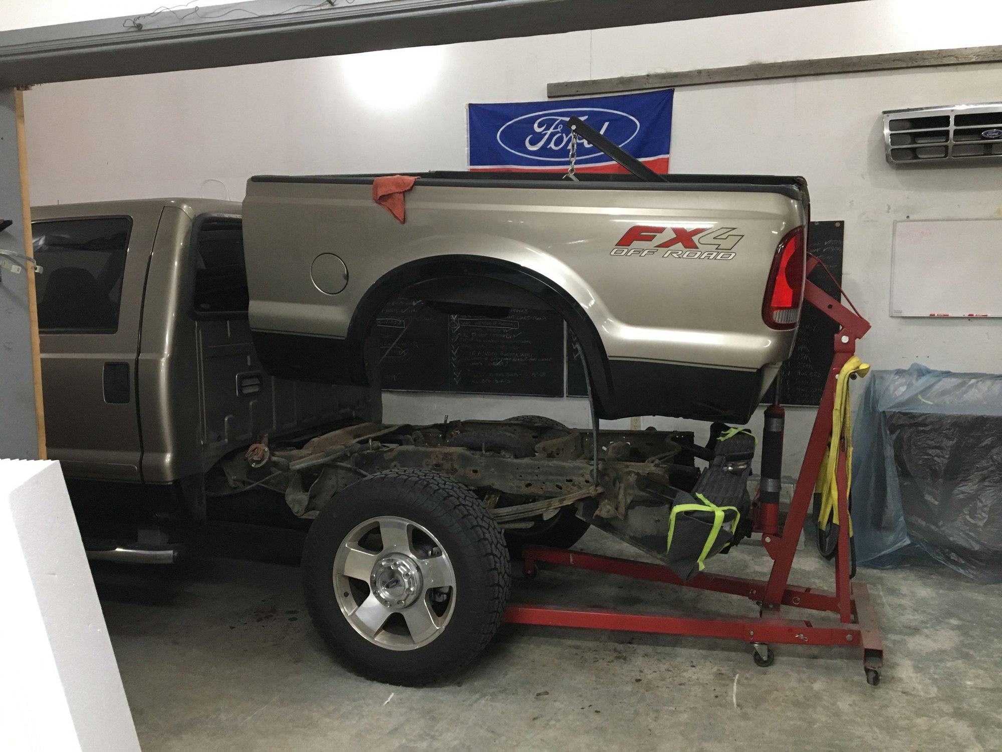

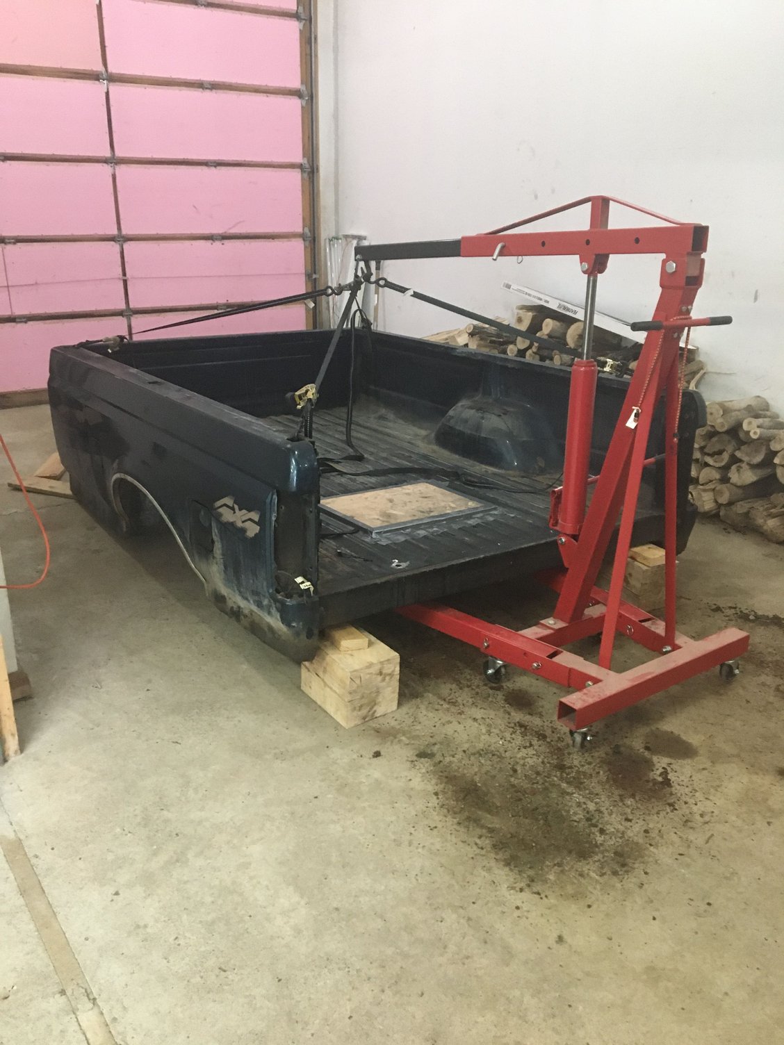

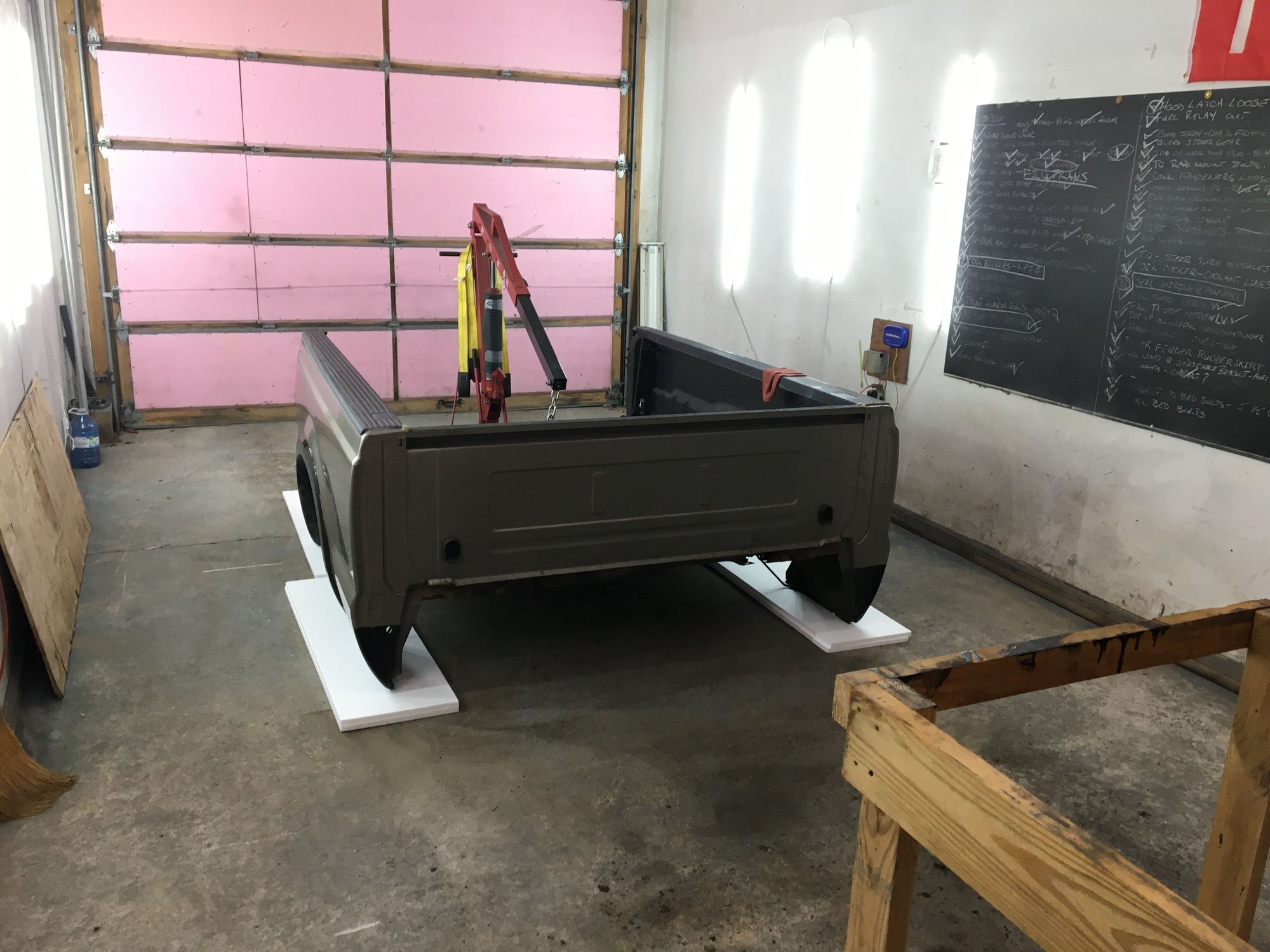

I did it the same way Jeff did.
A cherry picker reaching to the center with tie down straps from all 4 corners of the bed to the center hook.
Lift and slowly drive truck out from underneath and place it on a wheeled cart
