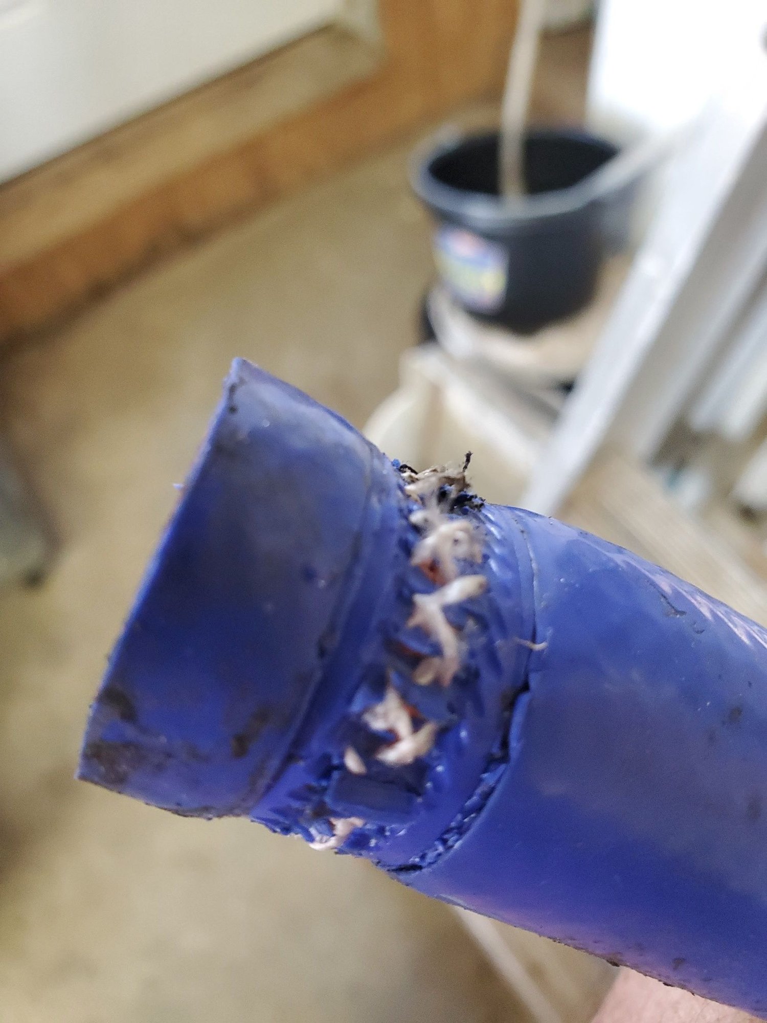

Coolant filter and manifold removed, back to stock.
The only breakdown my Ex has had was a ruptured coolant hose from the manifold to the filter, thankfully an old farmer let me use his tools and gave me a piece of heater hose. I replaced the hoses with silicone hoses, trying to avoid this from happening again but it was about to happen again.

Hose leaking, then radiator leaking ...... not to freak you out, but you might want to check coolant pressure to be cautionary.
