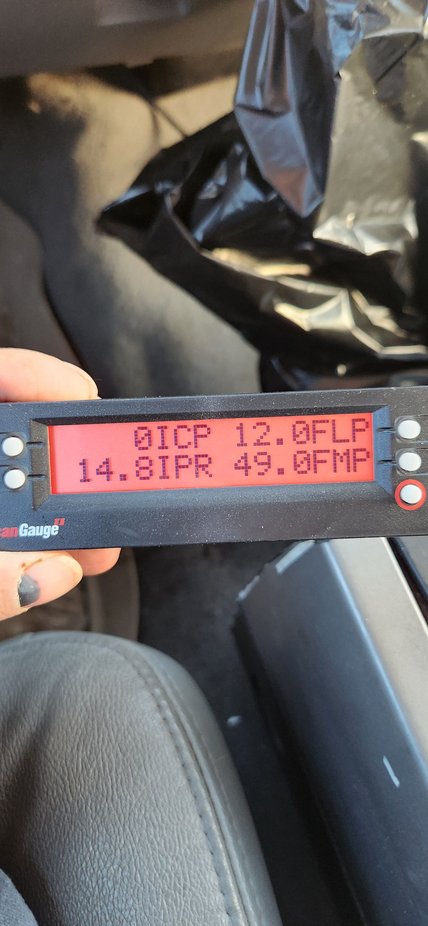

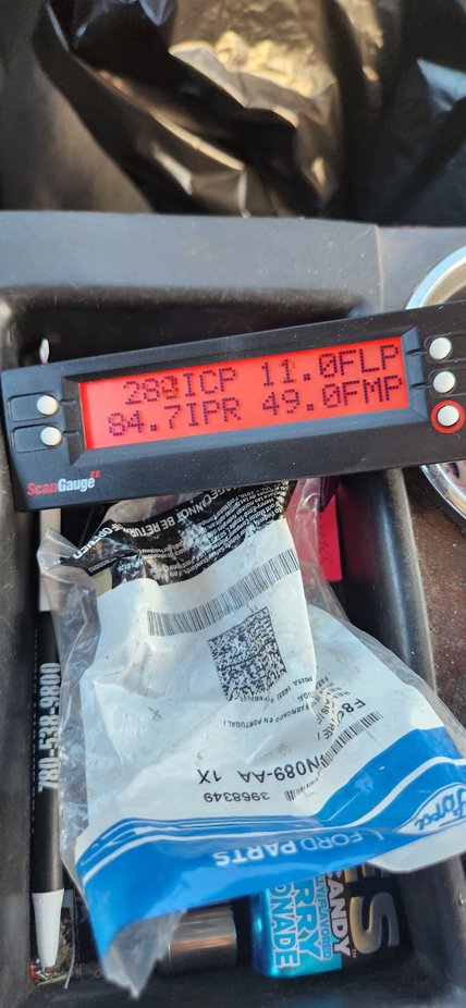

Hi all . I have a 2006 6.0 that's been studded, blue spring,egr delete, new ficm with atlas 40 tune. In the last year I have had dummy plugs,stand pipes,starter,fuel pump, all injectors,batteries, ipr,icp and alternator replaced. The truck has 500000 km on it.
The truck died on me while driving but fired right back up.
Today I have a crank no start.
February 6 cold at an idle
From February 6 koeo
February 14th koeo
February 14th cranking

Clearly you have insufficient pressure in the high pressure oil system, based on today's crank no-start data.
Were all the parts OEM (and from a reliable source, not EBay, Amazon, Autozone, etc)?
Has the HPOP discharge STC fitting been replaced?
Oil filter cap an OEM one w/ an OEM filter?
The troubleshooting process is going to be essentially the same as if you hadn't replaced all of the listed parts - ie do an air test of the high pressure oil system.

What are your cranking rpms?
Air test time then.
