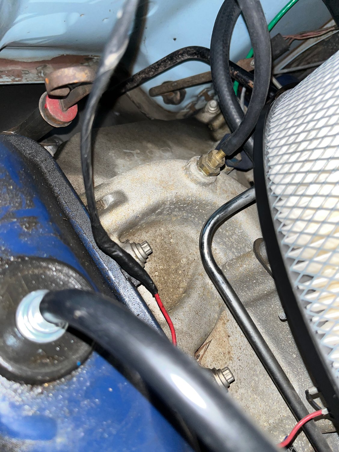

This is all I have on the backside. I could get a tree that you described and connect both the brake booster and the vacuum line from the transmission here. Would something like this work:

That looks like it should work. Seems kind of pricey, but what doesn’t these days.
You could even make your own out of brass fittings found at the parts store. Which is what it looks like the previous owner did for yours.
I can’t tell from the picture if there’s anything in the way of you threading it in though. This is sometimes the case with one that is shaped like T, rather than one that is shaped like a tree and taller with shorter extensions or angled extensions so that they don’t hit peripheral equipment as your spinning the threads into the hole.
There’s often some little widget in the way that has to be temporarily removed.

I would recommend leaving your pcv connected directly to the carb base, not tying it into the line with the brake booster.
1) I don't like taking vacuum away from the brakes if at all possible. I'm kind of funny that way and like my brakes to have priority. Small lines like would be connected with a factory tree is one thing, but PCV is a big draw. FYI, the factory vacuum tree would have a restrictor built into it to help hold vacuum in the booster and cut down on the radical swings whenever the throttle is cracked.
2) and maybe this is the more important one from a function standpoint, vacuum is created by the piston drawing down on the intake stroke, pulling the air and fuel mixture into the cylinder. If you hook up your pcv to the brass fitting going into that one runner, all of your crankcase gasses will be concentrated going into that one cylinder, potentially contaminating the air/fuel mixture and/or fouling the spark plug, all of which could lead to rough running. Having the pcv connected to the carb base allows all cylinders to vent the crankcase together and more evenly distribute the nasty gasses. Make sure that hose is oil rated for PCV emissions, too.
One more thing to keep in mind or check on. Power brake booster hose is special and marked DOT approved. It is made of heavier wall with more reinforcement cords built in to prevent collapse under vacuum conditions. It's also of a unique size to keep guys from using the wrong hose type, typically 11/32 for our trucks but there are other sizes, too, so it's important to have the correct fittings for proper operation. Using lesser vacuum hose or fuel hose, like too many guys will do, can result in wall collapse as the hose softens over time and lead to braking issues or failure.

Regarding the PCV connection, that’s what we’ve been discussing all along in this thread. Keeping the PCV valve connected to a full 3/8 barb on the base of the carburetor, and using the single runner manifold fitting for the brake booster only.
Well, brake booster and transmission modulator.
I don’t think they were considering teeing the two together. I only mentioned the letter T, to describe the shape of the fitting that was linked in the previous post.

I ordered the tee from Summit ($5 less) and some vacuum caps. I'll plan to cap the port on the front of the carb, run the PCV to the 3/8" on the back of the carb and connect the brake booster/transmission modulator line to the vacuum tee. Any problems with this setup that anyone can think of?
52 Merc - that make sense about fouling one plug. Will just plan to use the other side of the carburetor so it has the proper size port.
