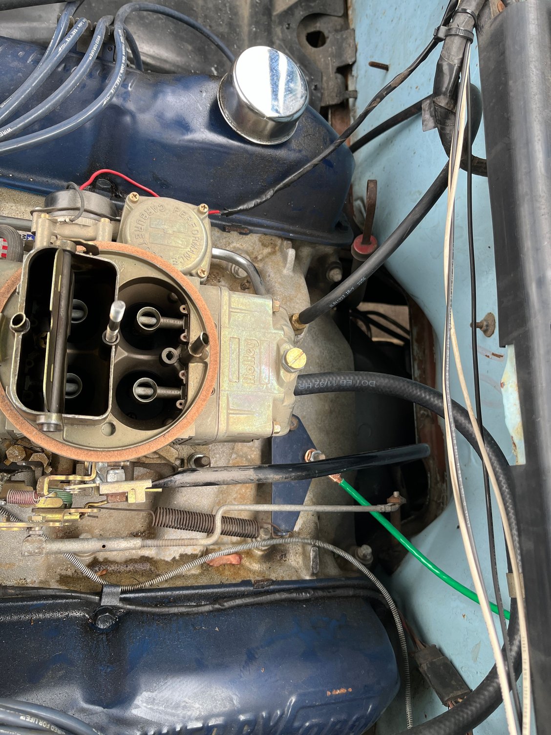

So I have a larger plugged port on the front of the carburetor. Would this be the setup I should use?
I think it's been mentioned, but just in case, yes you can. You can actually use either of the large ports for your vacuum to the PCV valve. In some cases, it's a matter of whichever one is most convenient.
Looks to me like the rear one is most convenient to the brake booster, and the front one would be most convenient to the PCV valve.
I don't know if sucking into the primary section, or secondary section, has any advantage, or disadvantage to the PCV OR the idle quality. But either one will do the job.

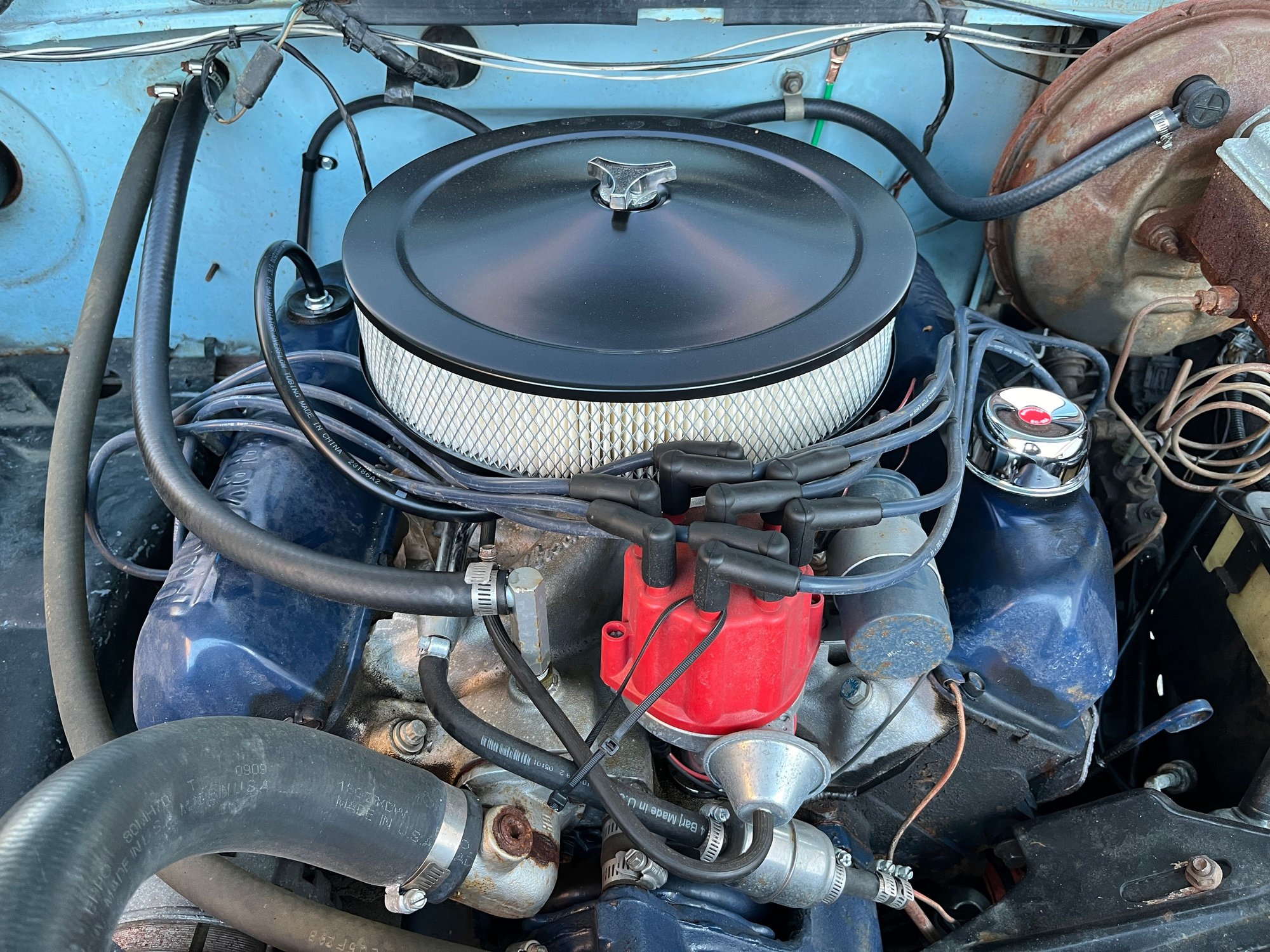

Originally Posted by dtrain911
Breather cap on the driver's side, pcv valve on the passenger side (where the yellow arrow is pointing) with the vacuum hose connected to the front port on the carburetor?
Or the rear port...
And to be sure we're on the same page, that cap you have there now is NOT appropriate for a PCV valve. It's most likely got a filter material inside, but there is no hole to insert the valve into that I can see. So you either have to pop that out to see if a valve can be inserted directly into the valve cover, or if you will have to use the one on the driver's side instead. OR, if you have to buy a new grommet, or oil filler cap of the appropriate design to make the system work.
Over the years in question, Ford used at least two different size/style caps for the PCV valve. And different ones for the return vent.
Your driver's side cap might work, but it's not currently set up correctly for being either a valve holder, or a filtered air return.

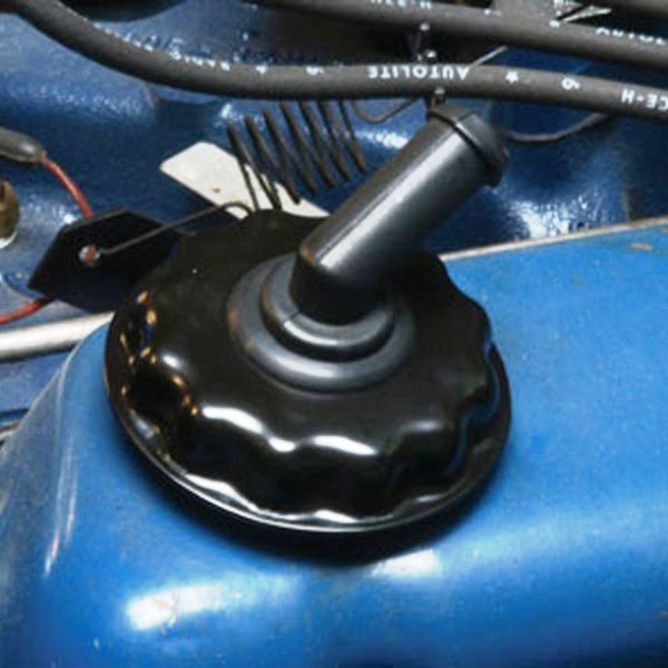

Here's a pic of the "low profile" version that we sell. In the pic it's set up for the breather. In the case of my '71 and my '79, it held the PCV valve.

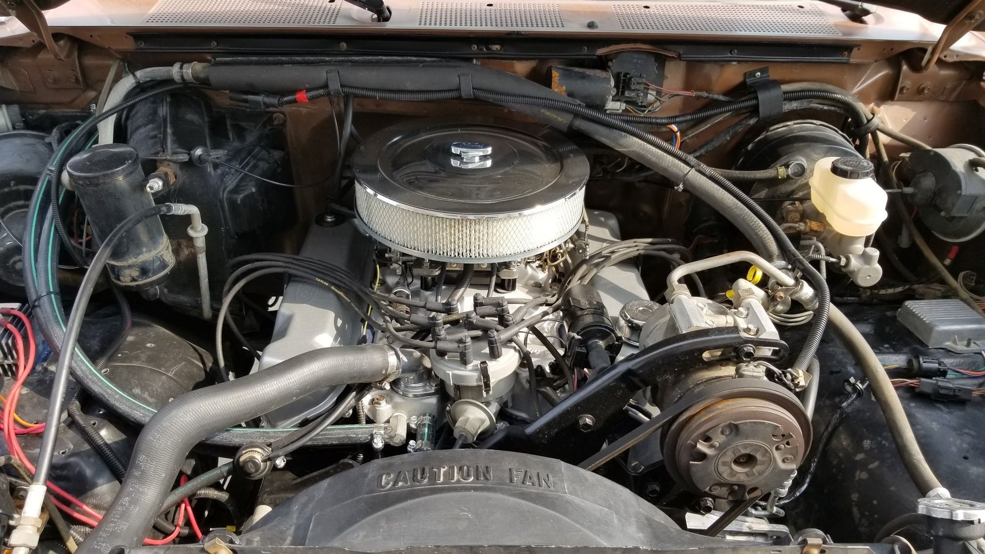

On Broncos with 289's and 302's, Ford used the passenger side valve cover for PCV duties, through the '70 model year. With the valve inserted directly into the cover. The driver's side had a tall cap with a tube to the air cleaner housing.
In '71 they changed to this lower profile oil filler cap, and inserted the PCV valve into it instead, and ran that 45° elbow directly iinto a grommet in the passenger side valve cover.
Same for the '78 and '79 full-size trucks.
I don't know if the openings in your valve covers are the same, but Ford did use similar methods for many engine families over the years.

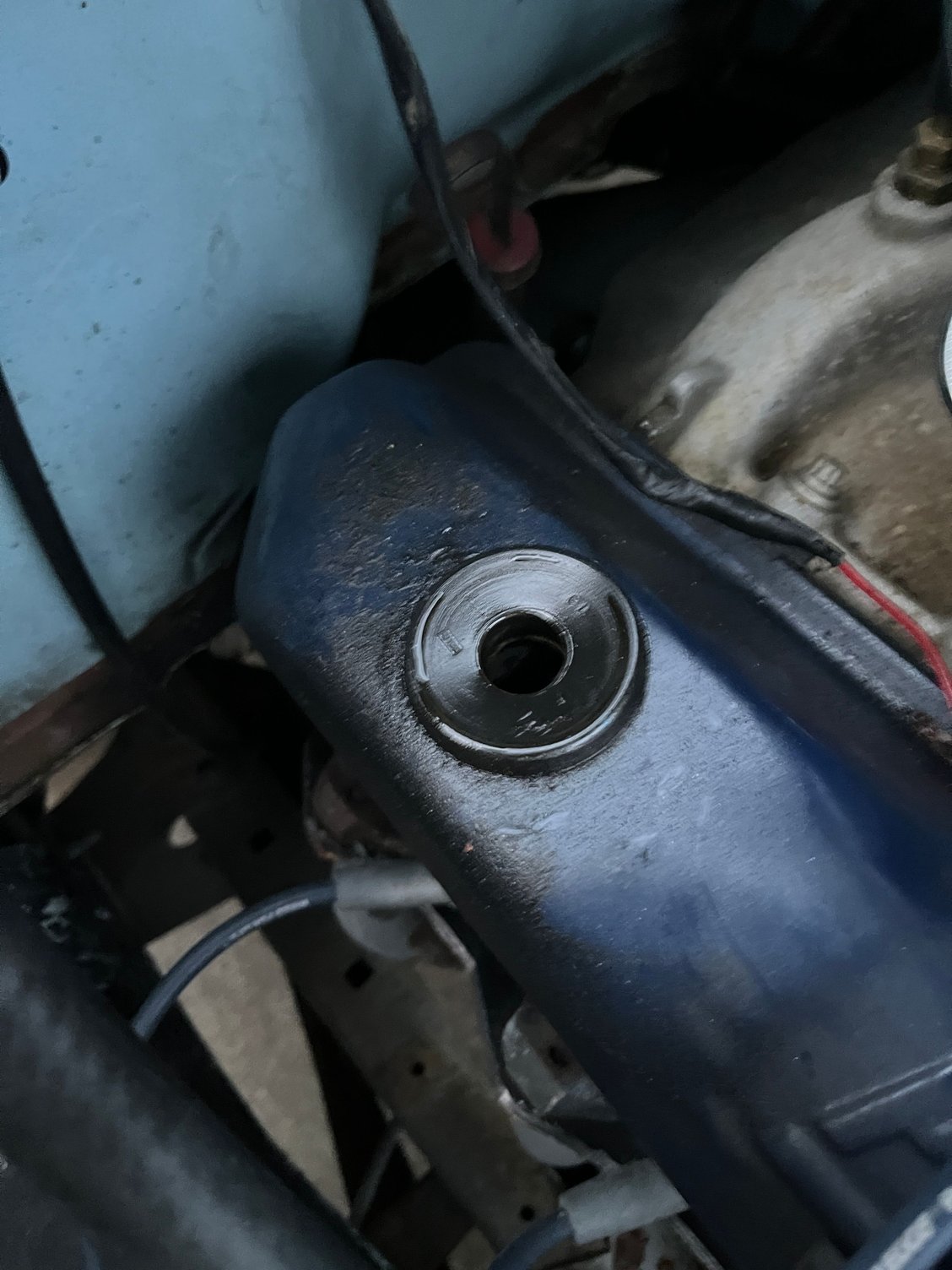

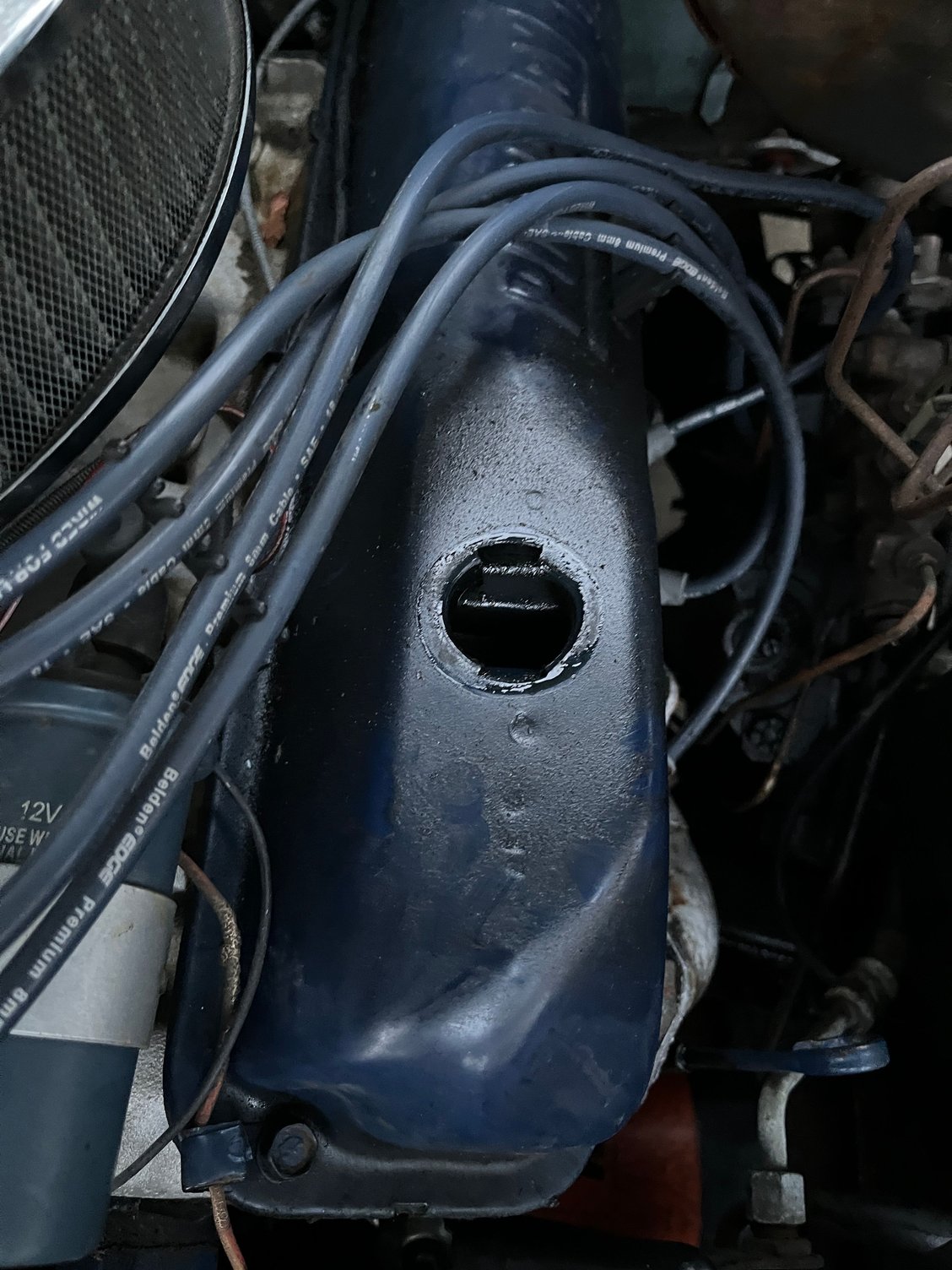

Someone mentioned early on that it looked like you had two driver's side covers. You might want to remove the caps from both, and post pictures of the openings. Then those that know these things the most can comment on any differences.
Here are the pics of the openings. The passenger side is just a plug - it doesn't do anything else.
passenger side
drivers side

passenger side
drivers side
Your passenger side cover has the PCV valve grommet in place. Your new valve should slip right in unless it's been hogged out by the breather someone stuffed in it. Your driver side is the typical opening for a twist-in oil filler cap.
passenger side
That's not a plug, it's a grommet. A "plug" would seal it off and there would not be an open hole in the middle.
It's like an adapter of sorts, that makes the hole smaller to fit different items, and seals the edges to keep dust and moisture out.
Whether or not it's another driver's side cover, would depend on what's under the grommet. If it's just a hole, then it's a legit passenger side. If it's a hole with the two notches for the tangs of the cap, then it's probably a repurposed driver's side cover.
Looks like it could be used either for an elbow, a PCV valve, or an aftermarket filtered cap.
Is it still soft, where you can pull it out? That way we can see the opening.
If it's hard and might be brittle, then don't try it because it might break. Just leave it and see if it will fit the valve.
Got a pic of the underside of the removed cap?

I don’t remember seeing a picture of the back of your engine, but did you ever determine there is a vacuum tree, or additional vacuum port, directly into the manifold?
If there is one, you could connect the brake booster to that and your PCV to the larger port on the back of the carburetor instead of the front.
