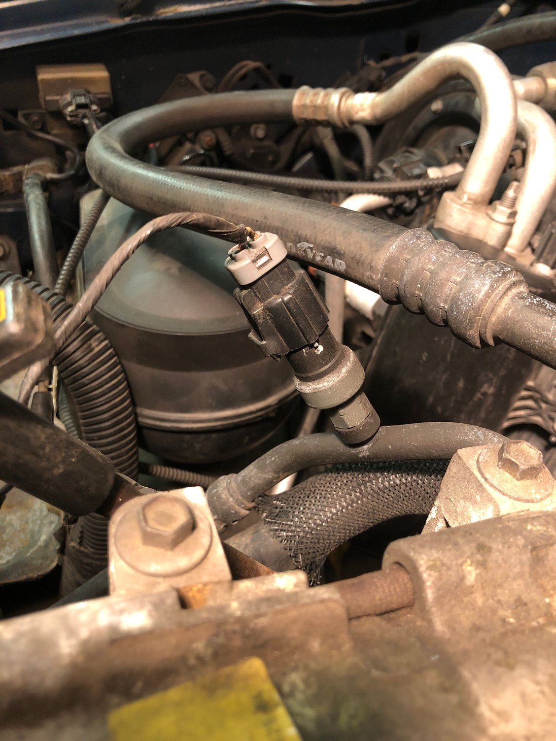

Currently doing turbo upgrade and fuel pressure gauge.
Noticed that the pigtail wires for one of the AC sensors are bent over at a 90° and the copper is showing. Doesn’t help I was just laying on it to do the turbo. Used a foam pad as a buffer.
This is the same plug I was having troubles with last year when AC was cutting out.
Anybody know if there is a part # for just that plug pigtail?
I have the part # for the entire harness
yc3t 19b573 p260g . Tag was still on that harness section. Not having much luck searching for it other than a used on EBay hit.
Tasca comes up nada.

How about this? All 4 wires are loaded, but you could use just the ones you need.
Amazon.com: Dorman 645-740 Vacuum Pump Pigtail Compatible with Select Ford / Lincoln / Mercury Models : Automotive Amazon.com: Dorman 645-740 Vacuum Pump Pigtail Compatible with Select Ford / Lincoln / Mercury Models : Automotive
From one of the Amazon reviews:

Thanks Jeff.
Already ordered. Scheduled delivery for the 15th.

Had trouble with that plug on every truck I owned. Nowadays, I unplug it whenever I work on the engine, to keep from bending the wiring so bad.

You can find the pigtails on Amazon. I will get the link for you after work.

Thanks Leonard.
Already have one on order.
Jeff / BWST was all over it and posted up the link.
