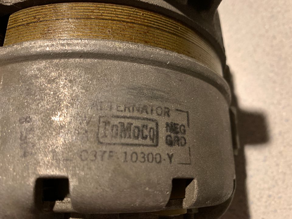

As I recall the generators were mostly black and they used either a yellow (more common to me) or white stamping on the case for identification.
Just to give an idea of what it sort of looked like here's a couple of later aluminum housed alternators. Typically stamped in either a black or red.
The stamp didn't always last very long. Any gas or oil that got on it would start the process.
Regulator covers were either painted which was common for FoMoCo and AutoLite brand or raised embossed characters which was very common for the Leece-Neville brand used on the higher amperage systems.
