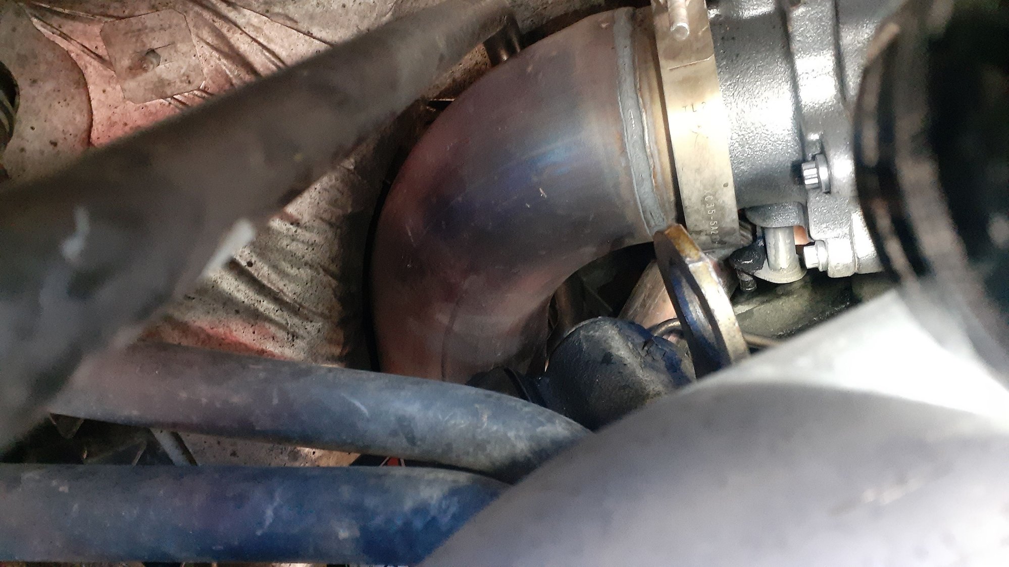

The new turbo came with the waste gate and pedestal pre-assembled all brand new. Today I noticed on the left side of the turbo just below the exhaust v clamp there is a lever that doesn't look like it hooked up to anything. My stepson who did all the work for me said the rod to the lever may had come off. (he's a master mechanic) So in the morning I will check it out. Here's a picture of the suspect.
Just below the clamp.and to the right may be the problem. Fingers crossed, will let people know tomorrow. The clamps look good on the up pipes.

That’s the exhaust back pressure valve.

Will that cause low boost if the linkage fell off?

It shouldn’t if the exhaust flow keeps the flap open. Only way is of the flap is sticking shut.
Maybe see if it moves freely then tie it to the open side for a test run… I don’t know which way that is, mines been gone for years.

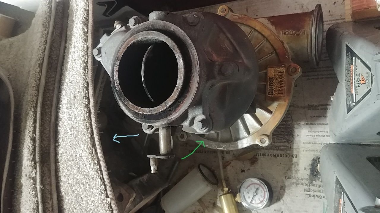

Rotate that clip piece towards the intake (green) and its in the open position......rotate it towards the exhaust (blue) and its closed

So it appears that the low turbo pressure is fixed. I reconnected the exhaust back pressure valve linkage and now I'm getting 13 to 15 psi. I also replaced the engine harness and am getting PO380 dtc. Which is glow plug circuit A malfunction. Does anybody know what side that circuit is? Drivers or passenger side?
