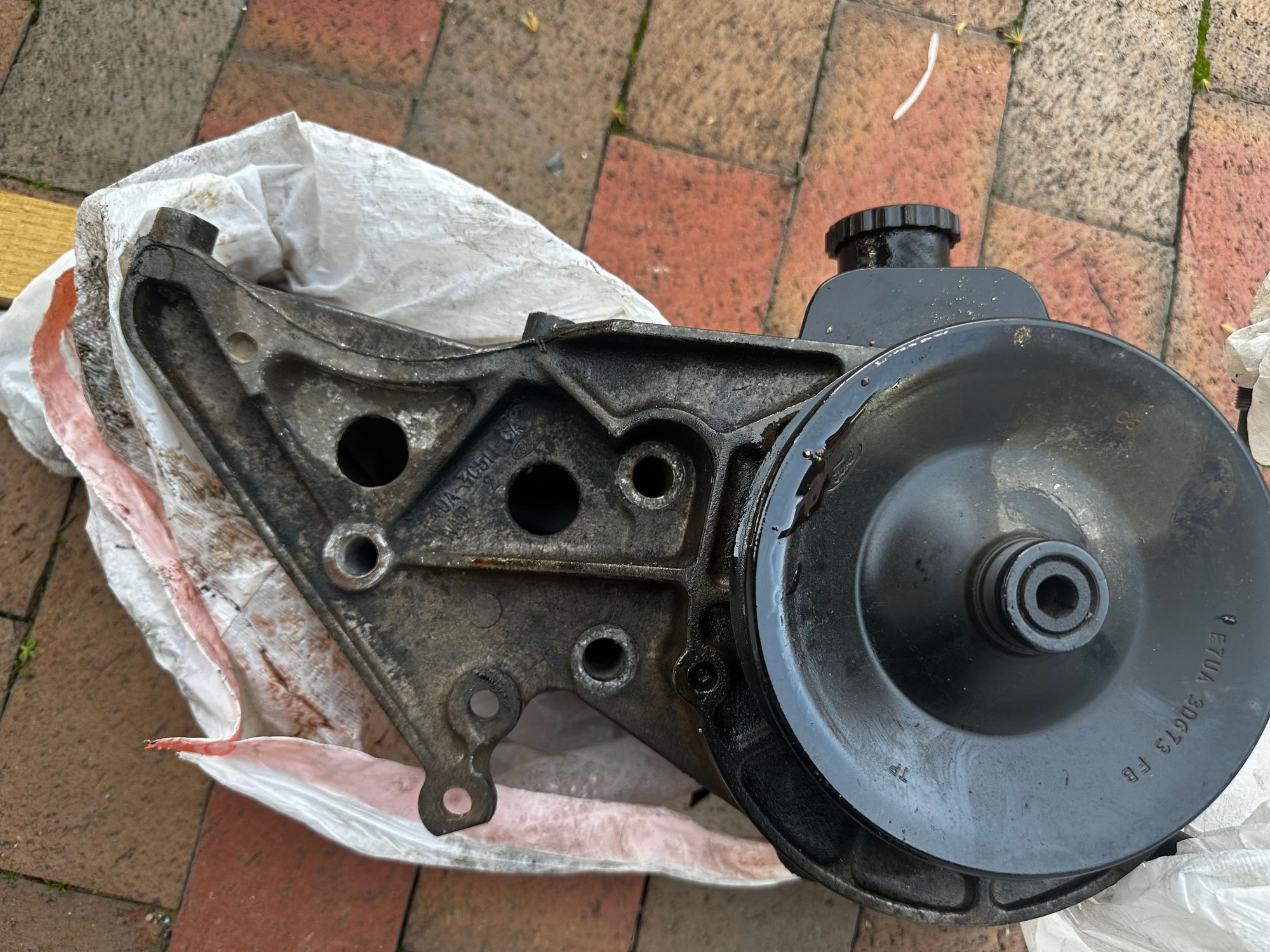

Here is a picture of the pump and bracket
the part number on the bracket is F4UA-3C511-CA (NMP 2)
